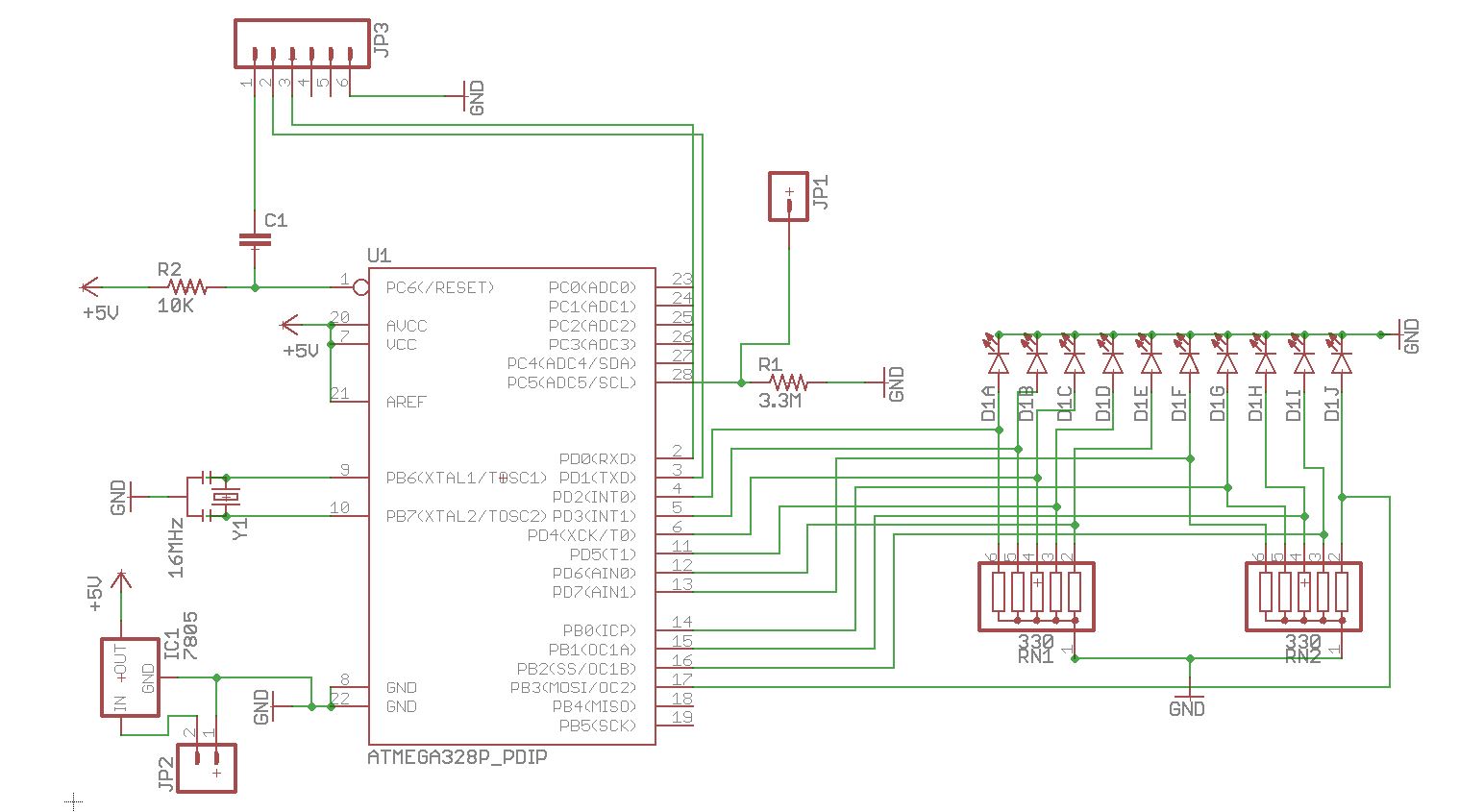

    Need Help Draw This Schematic to Sprint layout
    [ATTACH]42698[/ATTACH]
    Its quite simple. That Help is meant just to draw it for you?
      if any can help draw and share here

        seems like a smal emf detector with bargraph Display, i would be interested to chekc my home with this tool
        can help you with sprint layout 6 design
        pls tell also the correct compent you want to assemble
        for example i would take this
        https://www.reichelt.de/?ARTICLE=229...SABEgI2p_D_BwE
        instead of 10 single led and 10 single resistor
          And antena parameters, please...
            atenna is a simple Piece of 5cm wire, it is just the same scheme as arduino emf detector
            but it seems that paku wants a Version without arduino Environment
            hope the code is a improoved Version, the Basic Setup is only for nearfield detecion
            an aerlier idea of me was to get a higher Resolution by using a 1601 or 1602 Display as bargraph and using all columns and not only 10 leds

              Paku, the input of the power supply what should be - USB or somebody else
                Power goes to the 7805 which requires at least 2-3Volts higher than 5V and up to about 30V.
                So USB power (4.4 to 5V) will not work.
                  Is this good?
                    Aref, Vcc, Avcc from Atmega needs little Capacitors to Ground.
                    At Jp2 the Gnd Input is marked with + ???
                    The 7805 needs also Capacitors at In and Output.
                    The LEDs goes to Ground and over Resistor to Gnd.So there is no current control for the LED.
                    You have to connect the Resistornetwork like this:
                    PBx---LED---Resistor----Gnd or VCC. It depends what your Output Pegel is.
                    It is better to sink the current, it means the Resistors should go to Vcc and a logical 0 on the Outputport turns the LED on.
                    It schould be usefull to ad a ISP Connector to flash the ATmega.
                    regards horbei

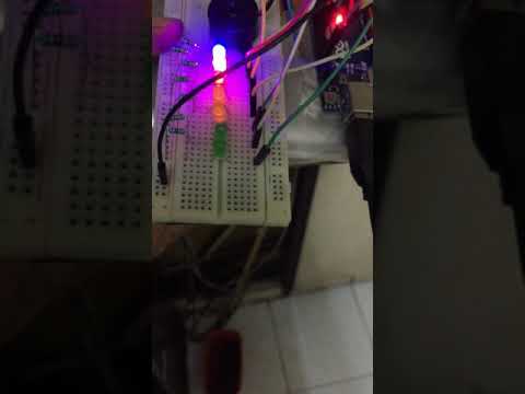

                      YES BRO I HAVE THE CODE
                        I WANT USE LED BRO
                          THE CODE IF SOMEONE CAN ALSO MODIFY IS GOOD
                            Is this good?
                            thank you bro i appreciate it
                              EMF DETECTOR BREADBOARD
