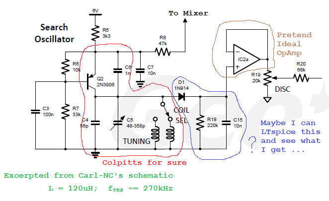

            Thanks for doing the circuit tracing. It's a nice circuit for inexperienced detector fans like myself to analyze and possibly build. I was an EE for 100 years before becoming becoming an electronics professor at a community college. This is a quality hobby and technical forum thanks to those willing to submit circuits and info. Thanks also to those adding coil details.
            Looking at Carl's schematic in the area of the search oscillator, there is nominally 1nF (C6) + 10nF (C15, at least on the +sourcing transitions) + maybe 200pF (C4+C5) connected in parallel with one of the two coils. Using 120uH (from Carl's previous reply) and the venerable Fres = 1/(2pi*sqrt(LC)) I get approx. 137kHz.
            Carl's remembrance of 200+kHz may point to an inflation on my behalf of C15's contribution. Given only ~400pF of adjustment my estimate of Ctotal may indeed be on the high side.
            I see a +6V stabilized supply and a +3V virtual ground. Might I ask what the Vcc (Pin 8 and GND/Vee (Pin 4) connections on the LM358's are?

                            I measured the frequency to be 270kHz, which gives a Ctotal of about 2.9nF. The circuit is similar to a Colpitts but different, and I'm not sure how to calculate Ctotal.
                            The '358s have VCC=6V & VEE=0V.
                              Search oscillator musings
                              So ..... Here's my take on the search oscillator and coil electronics, etc. ...Click image for larger version

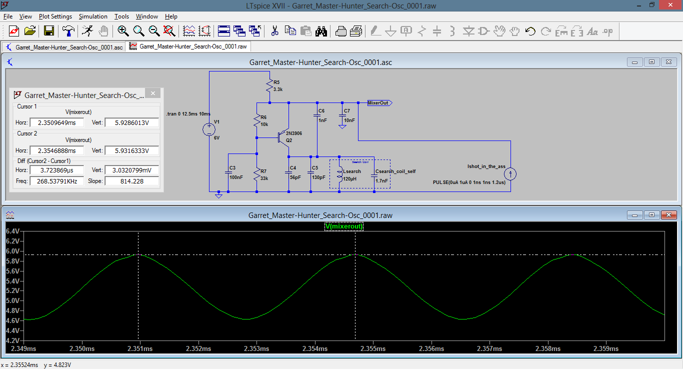

                              I tried some LTspice simulation (I know lies, damned lies, and simulations) and the D1, R18, C15 level detector is just super low Q and doesn't effect tuning. So how am I going to BS my way from ~1.19nF to Carl's 2.9nF? How about search coil self capacitance? Here's a sim screenshot of my LTspice sim:
                              The forum did not care for my LTspice ".asc" file type so maybe I can add a link to that tomorrow or Friday.
