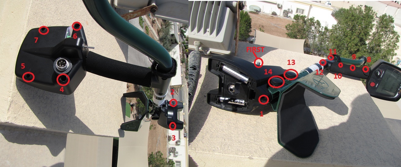

    1. Remove the volume potentiometer's knob by pulling it towards you. You can carefully use fork to do that trying to not scratch the box.
    2. To open the battery and dc-dc block you must unscrew three Philips head screws (1,2,3) and the plastic cover will get open. If you need the control box dis-attached, pull down the foam cover of the handle and remove hidden screw number 8. If you need the handle to be removed continue with hidden screws 9,10 and bolts 11 & 12. The elbow support can be removed only after the battery/DC-DC box and unscrewing 13 and 14.
    3. To open the control box you must first clean the screw holes from the hotglue seal and than unscrew four Philips head screws (4,5,6,7). After removing the back cover the pcb will get exposed from the components side. To gain access to the back side of the board you must remove the settings knob, peel a bit the front panel decorative sticker and unscrew the settings vallcoder lock nut(i did not do this part so not 100 percent sure).
    Assembly is reverse to the disassembly.

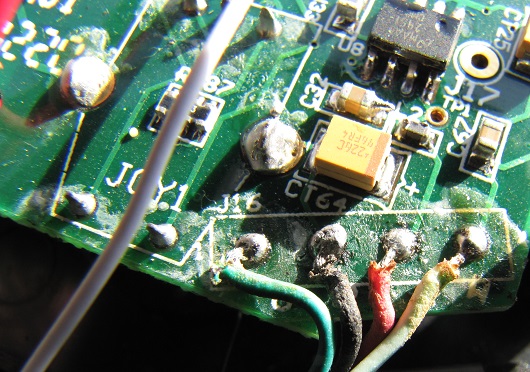

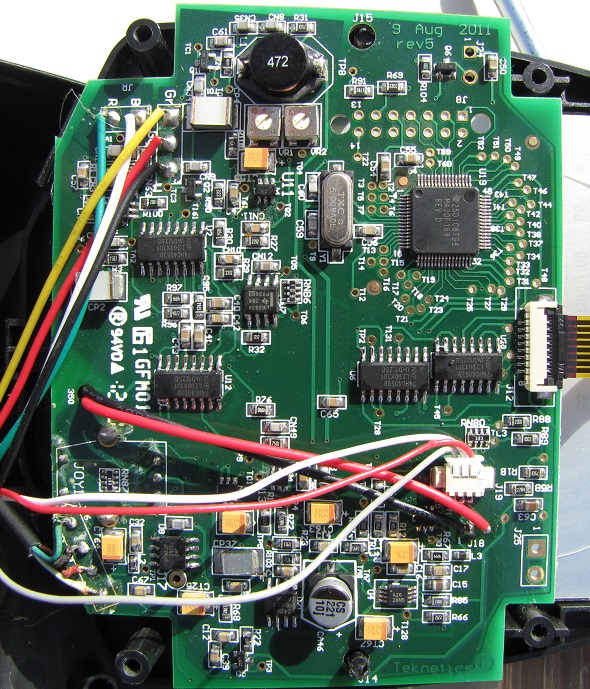

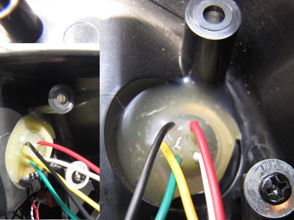

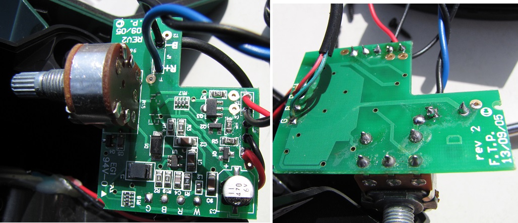

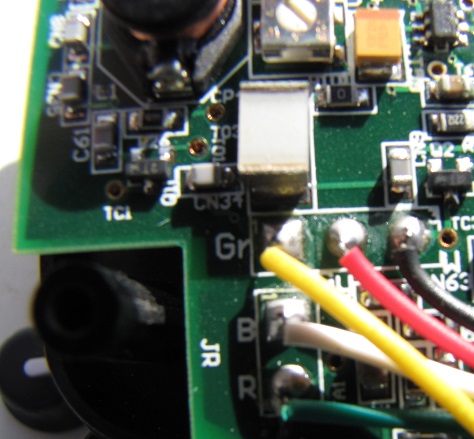

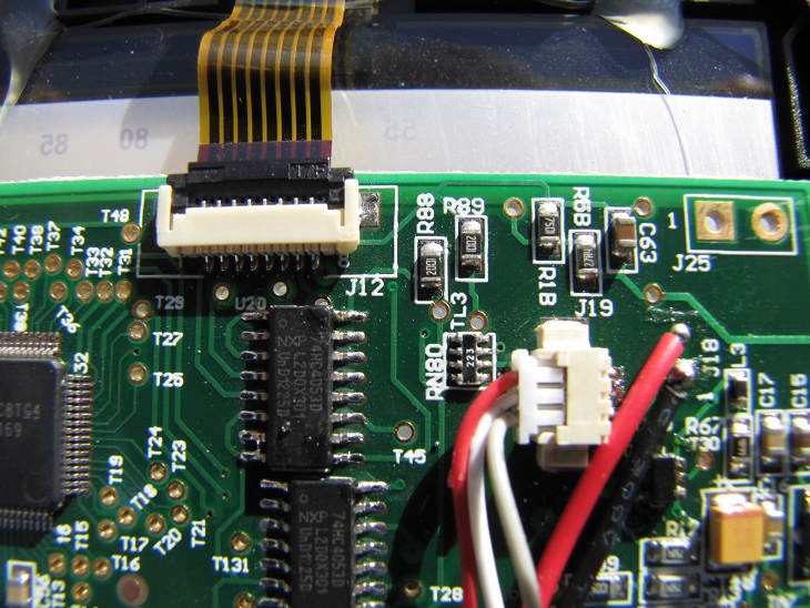

    Here are the pics of the component side of the pcboard, dc-dc converter, connectors and the chips description. Photos of the ic's are not needed as they are visible well on the board.
    MSP430F169 -16Bit Ultra low power MCU;
    74HC4053D - triple single-pole double-throw analog switch;
    TLE2426 - Rail splitter precision virtual ground;
    LP2951 - Adjustable micropower voltage regulator;
    LM393A - Dual differential comparator
      There seem to be something wrong with my multimeter. First are the resistances measured with it. Second by the induction tester.
      Multimeter:
      1-2 - 42.2 Ohm(second example - 28.4 Ohm);
      2-3 - Not connected;
      3-4 - 5.1 Ohm(second example - 4.5 Ohm);
      4-5 - 4.1 Ohm(second example - 3.6 Ohm);
      3-5 - 4.1 Ohm(second example - 3.6 Ohm).
      Tester:
      1-2 - 39.2 Ohm(second example - 25.8 Ohm) - no inductance present?!?!?;
      3-4 - 2.6 Ohm(second example - 1.9 Ohm) - 0.72mH(0.66mH);
      4-5 - 1.4 Ohm(second example - 1 Ohm) - 0.2mH(0.2mH);
      3-5 - 1.4 Ohm(second example - 1 Ohm) - 0.2mH(0.2mH).
      As i have two fake t2 coils, you can clearly see what kind of big tolerance is there.
        I think the Pin_1 - Pin_2 inductance is the same as the Fisher F75 coil, 6.95 - 7.00 mH
        Pin_3 - Pin_4 is the transmit coil, it is centre-tapped , the tapping is pin_5.
        In theory, the inductance of the total winding should be 4 times the inductance of each half. But theory doesn't work here. When you measure 'half-a-coil', the other half of the windings are still there, and they affect the measured value. I guess they are produced by winding 'bifilar' , that is, two wires would together, rather than "wind half, bring out a tap, wind the other half.".
