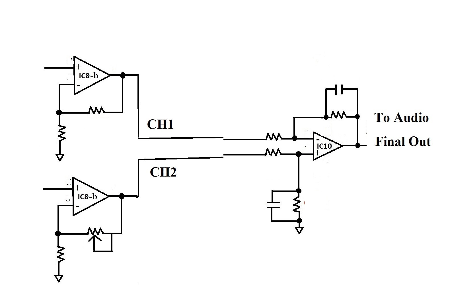

                            Hello
                            Dear Mdtoday
                            I hope you are in a good health.
                            Before everything, thank you for your supporting and please forgive me for my questions.
                            My friend, as you know, i added the GB (based four Sampling) part to my HHD (attached general schematic). Then i added your Audio to it.
                            Both of them is working nice but i have a strange problem with audio. As you know, the audio works based on both pitch and volume level. For exp, if a target is closed to coil, both volume and frequency will be changed. Similarly, if target is far from coil, only its frequency will changed. My problem is in middle of the distance, exactly edge of called close distance. In this distance, my audio part produces a strange audio, like a noisy signal. It acts like a non-motion mode but its sound is a very very noisy, instead of a clear audio for closer targets. I think the audio part can't make a decision for doing both pitch and volume or only pitch changing. So, it compounds them incorrectly. For solving the problem, do you have any suggestion for the schematic? which part of the schematic should be edited? Remember that i have no problem with high and close distance, only middle distance is problem​
