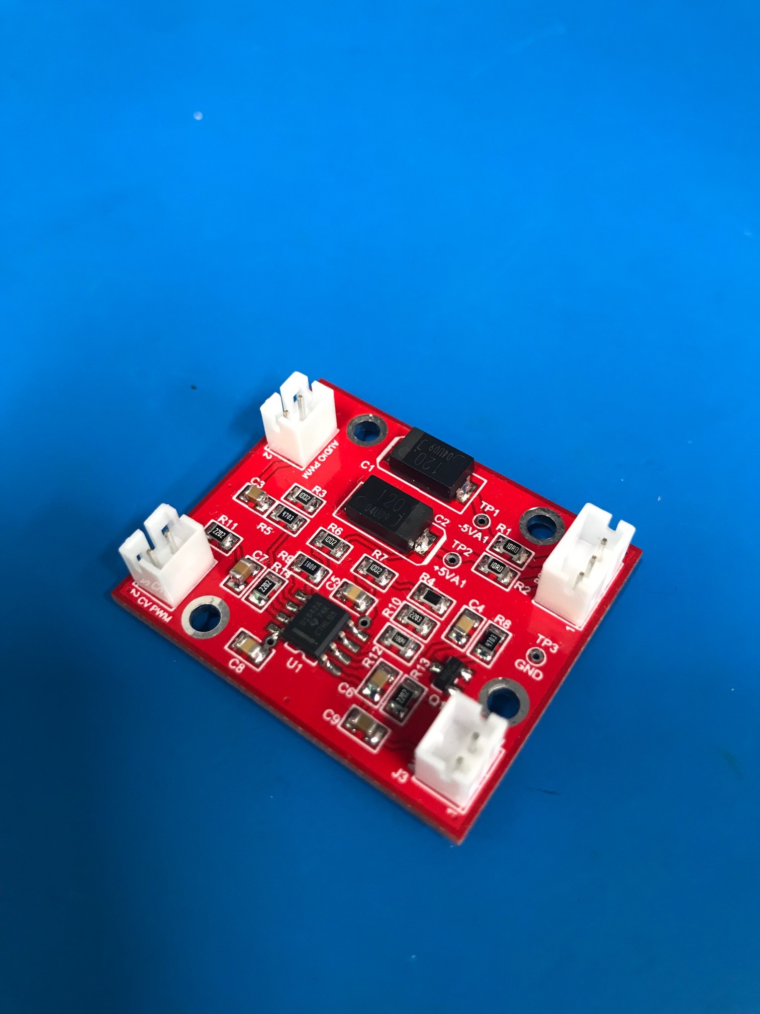

                    • Here are some project files that I could find without pulling everything out of storage.
                      Cheers

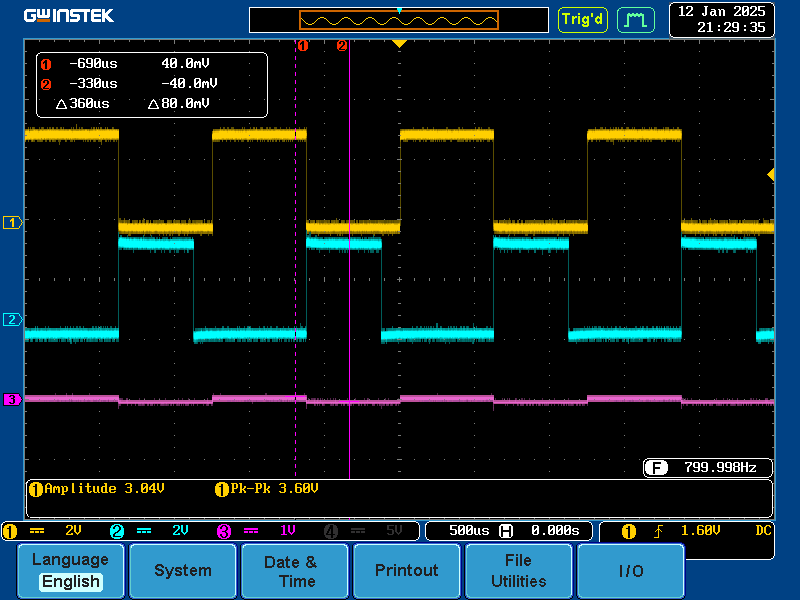

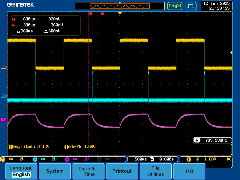

                          Um, that's what this circuit is for its a PWM voltage controlled attenuator (VCA) in this case.
                          Threshold can be done in firmware if you are going mostly digital. If not, you use your existing threshold and final stages. (I'm not really sure what you are wanting to do).
                          Pitch or frequency can also be firmware controlled, or can be a 555 timer osc, whatever. I used 3v logic to the inputs.
                          This circuit used the PWM outputs of a micro to generate the audio.
                          See attached from scope. 40Duty.png shows min output, 1Duty.png shows Max output. AUDIO output (purple trace), yellow trace = AUDIO, Blue trace = CV_PWM.
                          Notice the inverse amplitude vs PWM.
                          The FET Bias voltage around R7/R4 can be tweaked to suit the JFET used but the values shown worked ok with a number of different replacements, not critical, however it does affect the range of attenuation.
                          R5/R3 ratio can also be adjusted to suit the audio input. I think the Sim shows 47k/1k but the actual board had 470k/10k when I used the OPA1642.
                          R6/R9 were used with some replacement OPamps during testing, you can probably just leave out R6 and use a link or zero ohm resistor in place of R9. Prob leave as is.
                          I don't use this circuit any more but it was useful.
