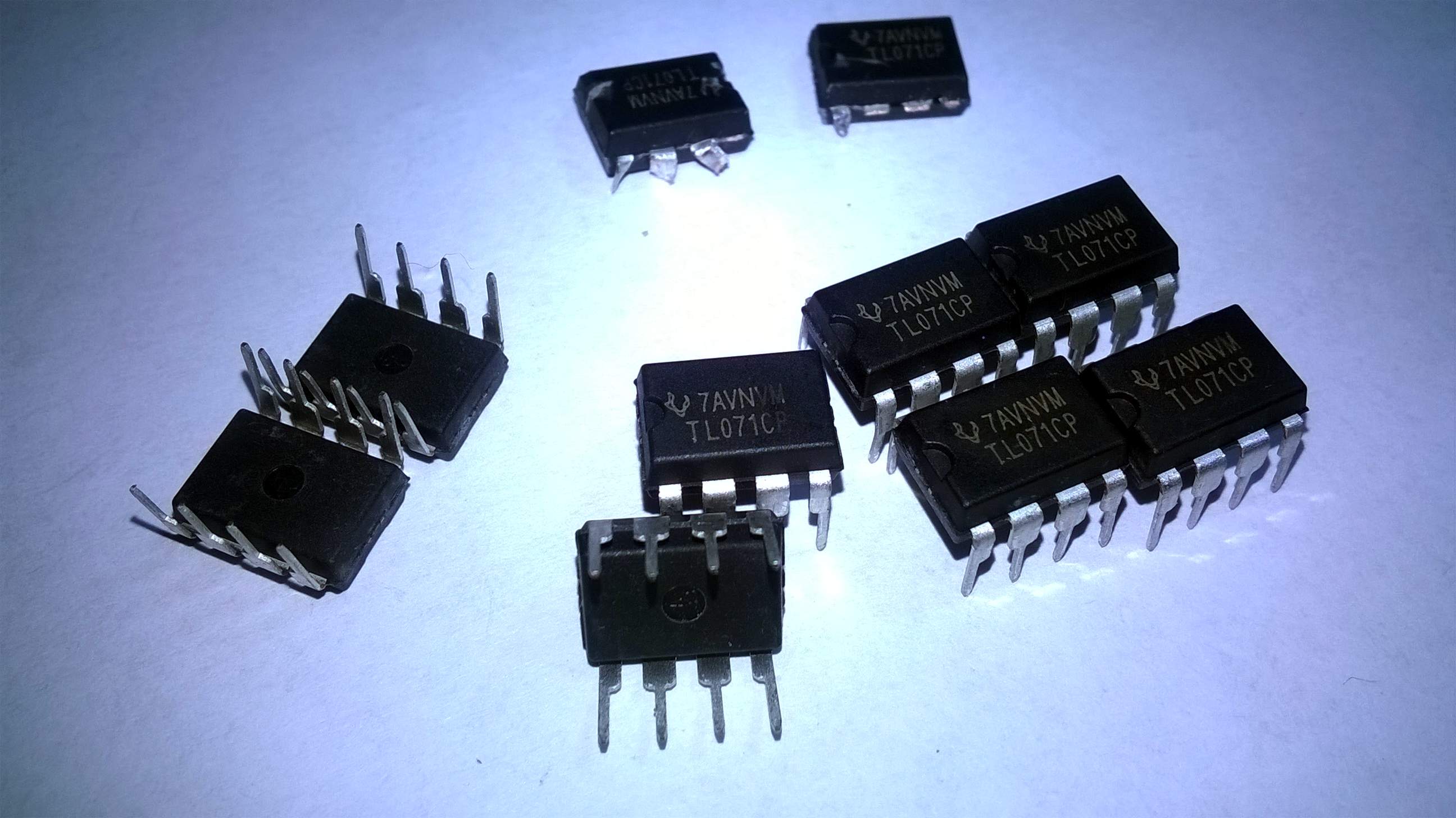

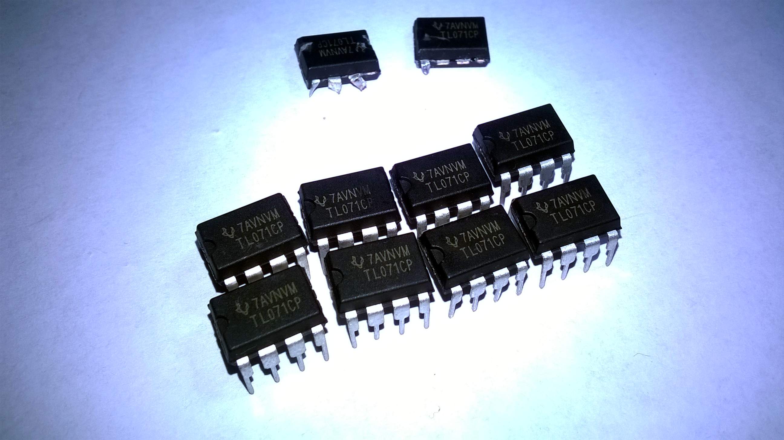

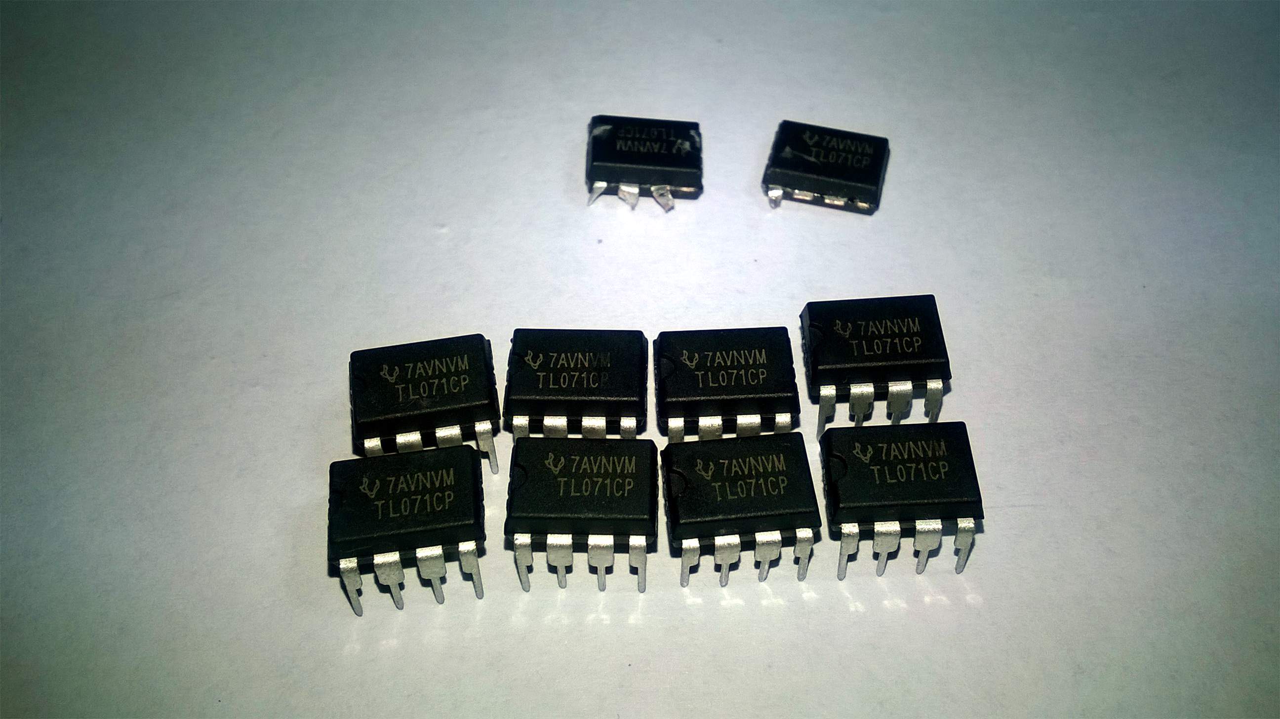

                  ... Can you believe; NONE of those TL071 are working by specs!???
                  At first i had doubts on many other things. Than tracing step by step i end up only to suspect on TL071.
                  So i put DIL 8 socket on one pcb, place one old TL071 from a scrap; and it is working like a charm!
                  Than i replaced one by one of those 10 new TL's; NONE of those is working at all!???
                  Fake? Failure? Whose gonna know? ...
                  Ivconic ... where did you purchase these TL071 chips? If you don't want to say thats OK.
                  Please post a close up photo of one bad chip from top and side and maybe a photo of all 10 together if you can.

                          Hello Ivconic, Thanks for the good pictures.
                          This looks like bad news, sorry. I hate this fake stuff, it gets more every year and I fight it in my own way.
                          These chips look black-topped and remarked. The pins also look strangely re-tinned.
                          The logo I have not seen before and somehow very faintly resembles a TI logo. Weird.
                          The writing on the chip is also a bit wonky/jumpy ... modern ones would be lasered.
                          This dealer does not even have a real picture of the chip in the shop ... for me, no picture or data sheet means no buy.
                          The seller also does not state the manufacturer. I would rate this place a big thumbs down.
                          Check everything you have bought in that shop, especially electrolytic capacitors.
                          Had my first encounter with faked chips in 1992. Re-marked 1 Mbit SOJ from 100ns to 80ns and CPU cache chips for 486 CPU with no function.
                          They were made in ... can you guess ...
                          no ...
                          yes, the united states.
                          It has happened to many people. You have noticed that something is wrong before putting it on market. That's good.
                          Its still a big ****ing pain though and frustrating for hobby builders too.

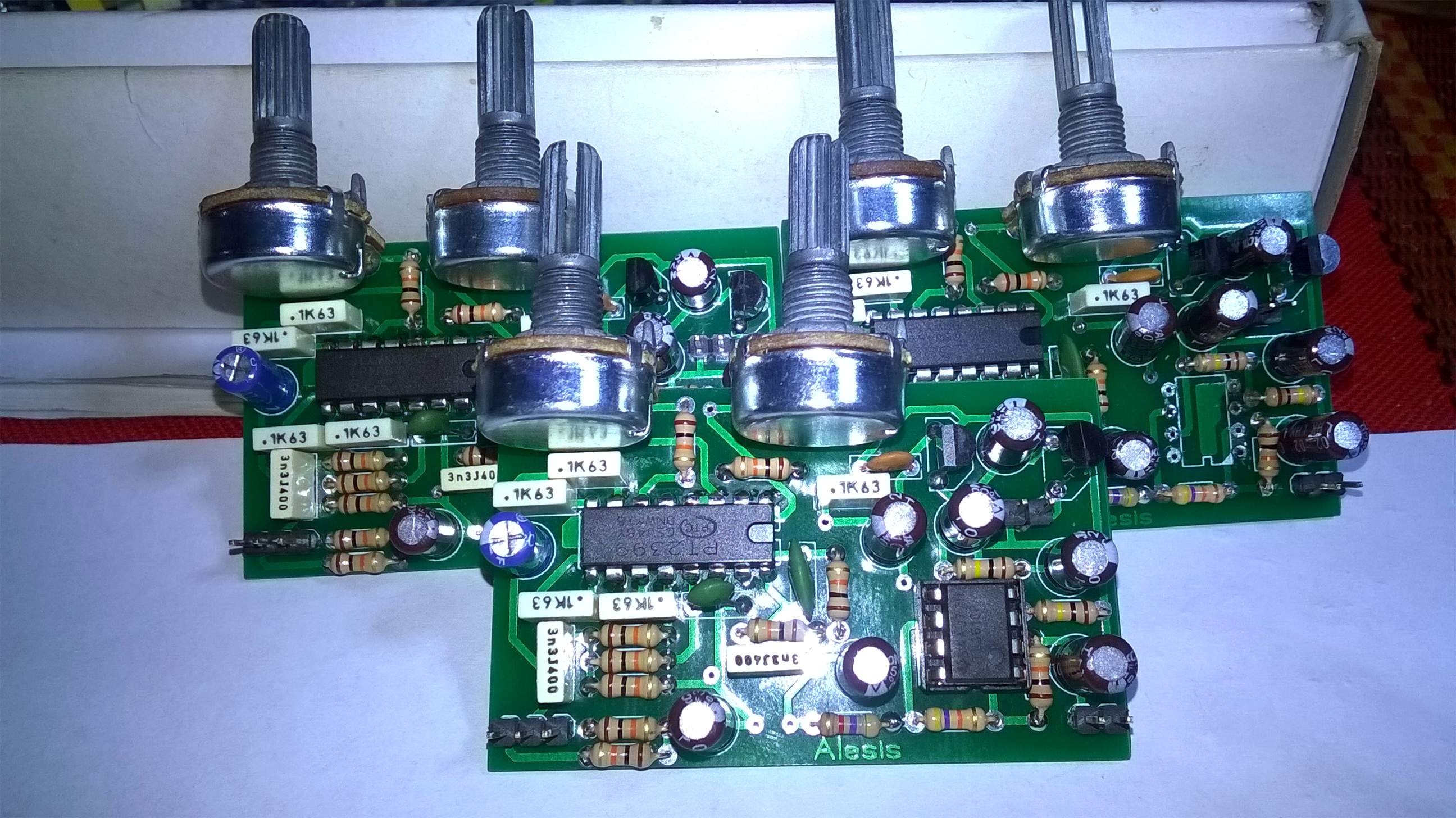

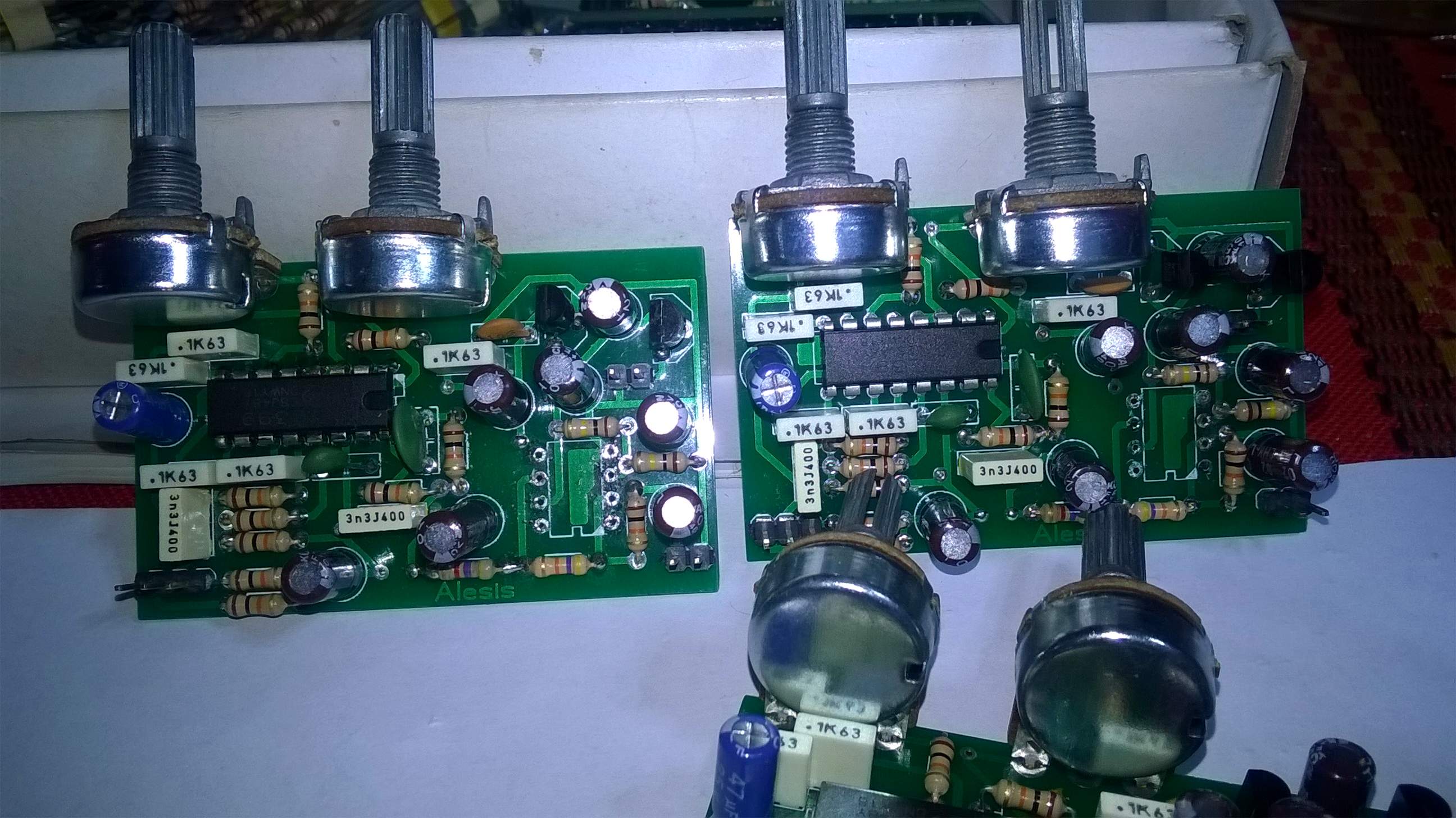

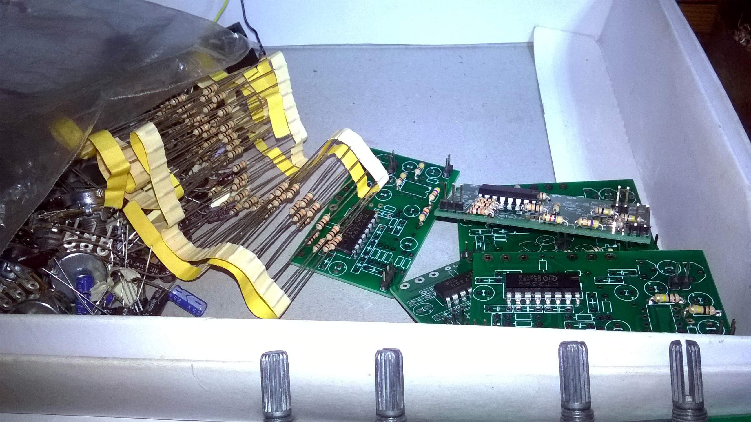

                              BTW... for this afternoon i plan to commit suicide... all because i can't achieve nice pcb design yet!...
                              I'm a man of my word.
                              I took my Colt Cobra and put it to forehead.
                              I fired the gun.
                              I missed.
                              • 3 less ugly attempts.
                                I plan to make "100x70.lay" , yet need to be checked from errors. Since i am seriously out of form and shape.
                                The other two are only for laugh.
