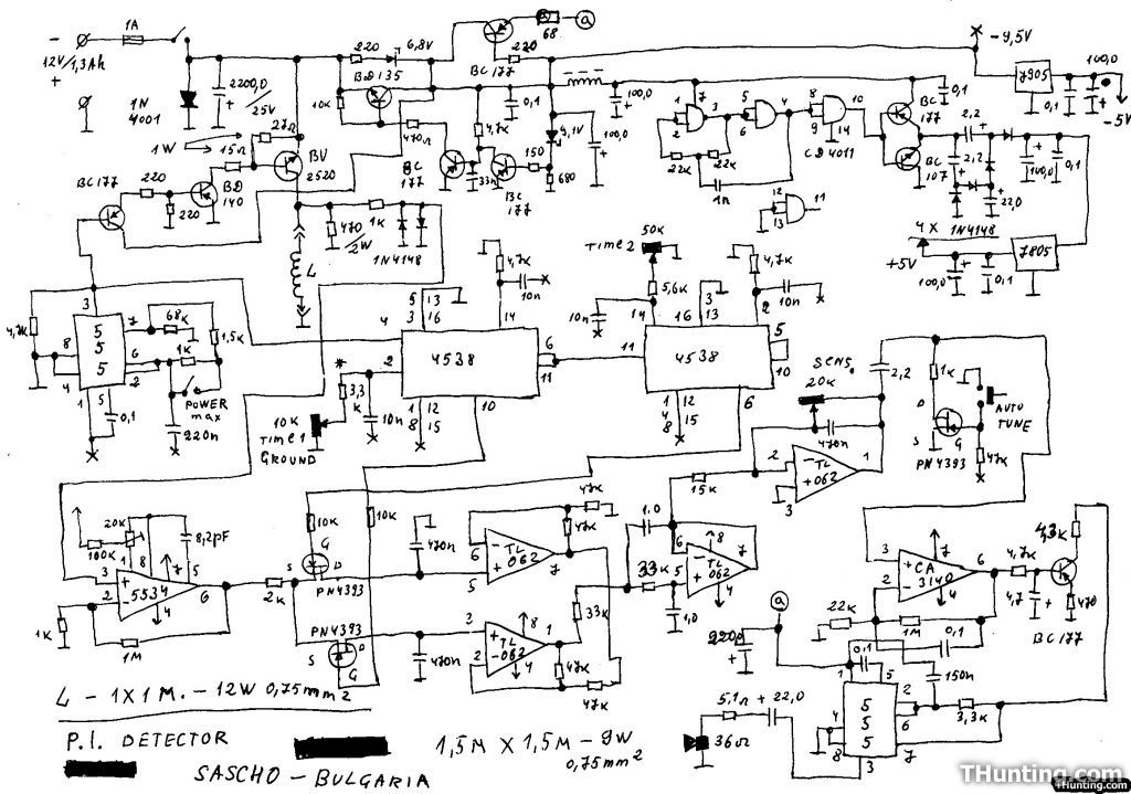

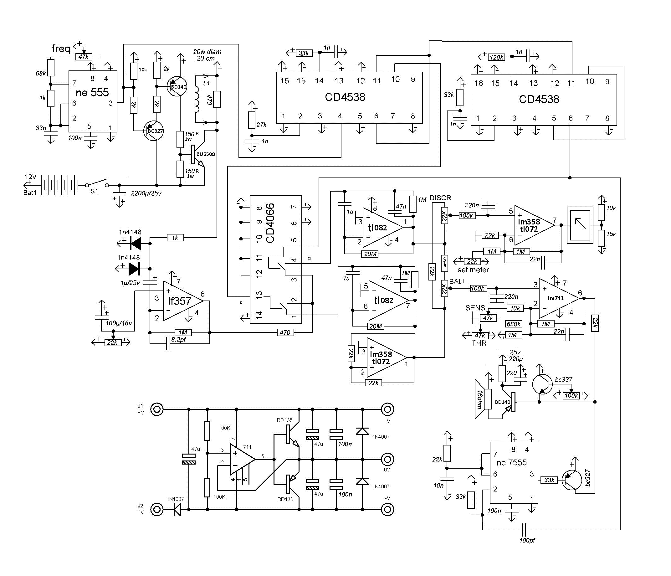

SBG-PID
Name:	SAS2 DIAGR.png
ID:	362068I think they're connected.Click image for larger version

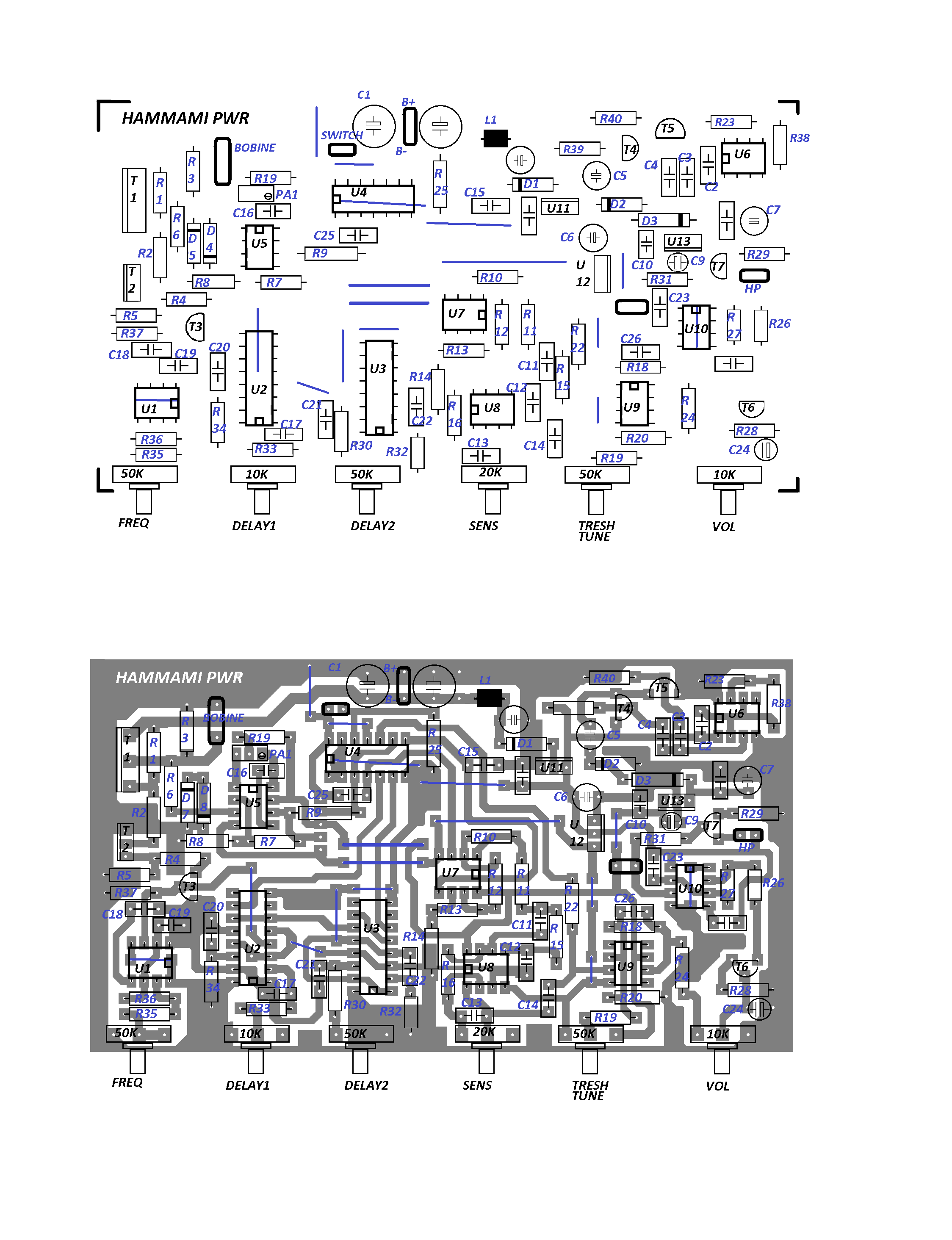

Name:	SAS2 MONT - Copie - Copie.png
      Get this chart from the Arabs.
      • The common conductor of the circuit is a plus. A negative voltage stabilizer is needed.
        • TL431 would be an option.
          After all, the circuit works someone concluded?

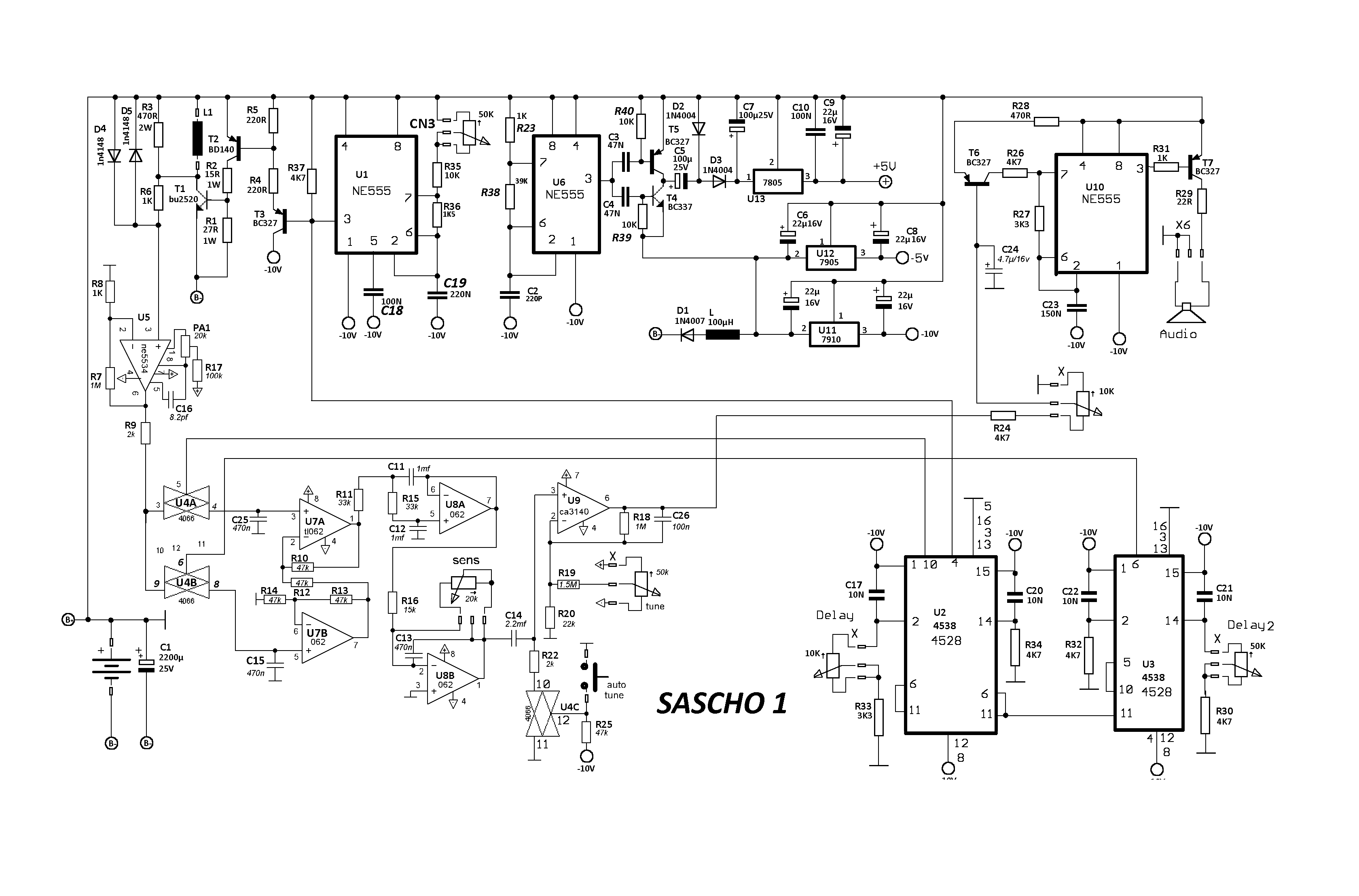

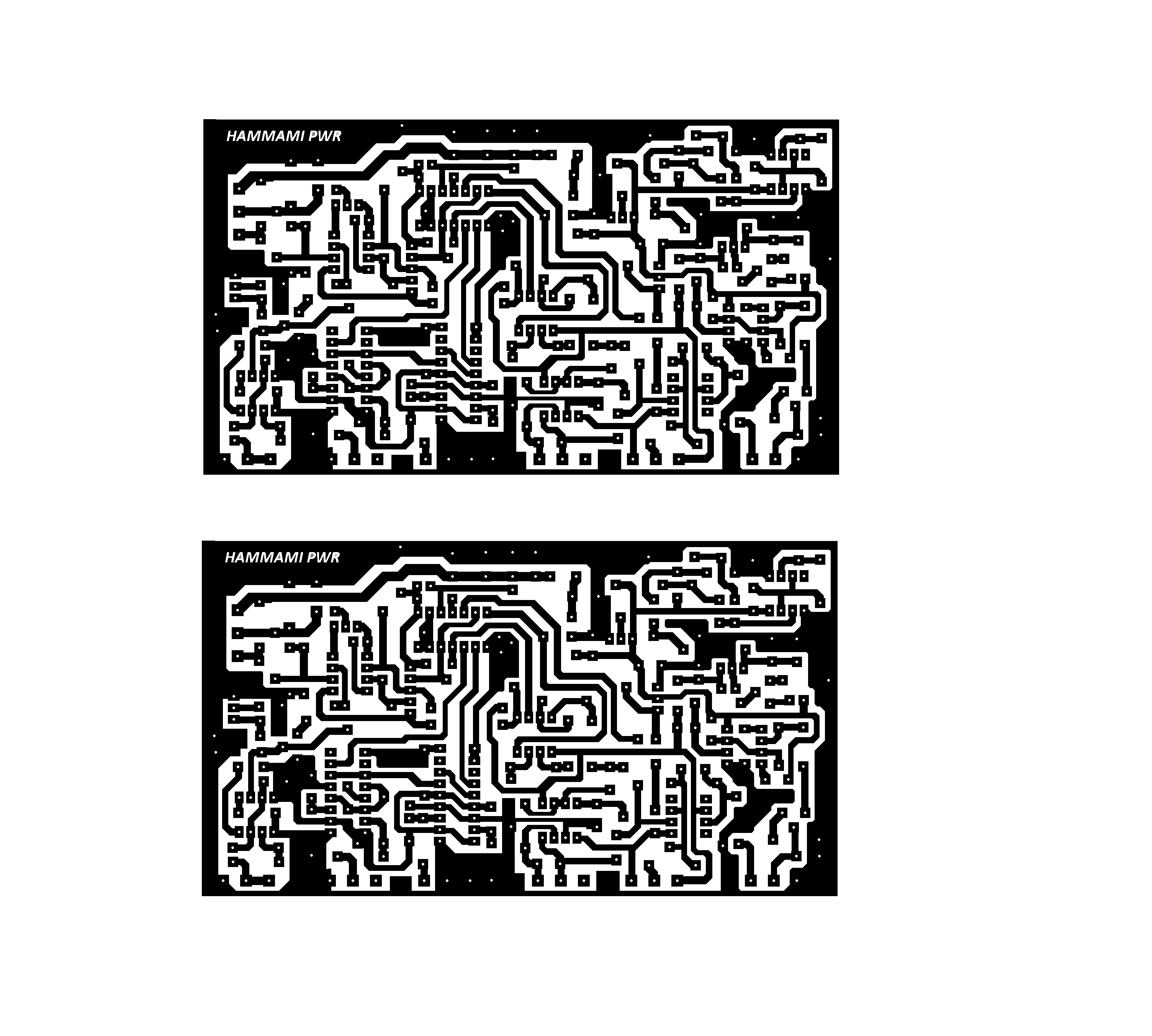

Name:	CIRCUIT IMPRIM.png

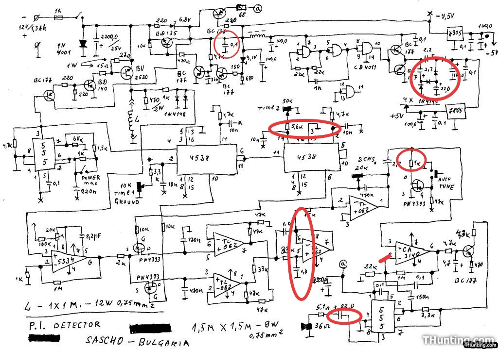

                  • Which version can exclude iron?
                    • The sas1project.png (schematic) will not work. The circuit diagram has errors within the timing circuit! The PCB I have not checked.... it might be correct.
                        No worries , I thought that was the reason,
                        just thought I would mention it for other people making the project, I'm still waiting some parts.

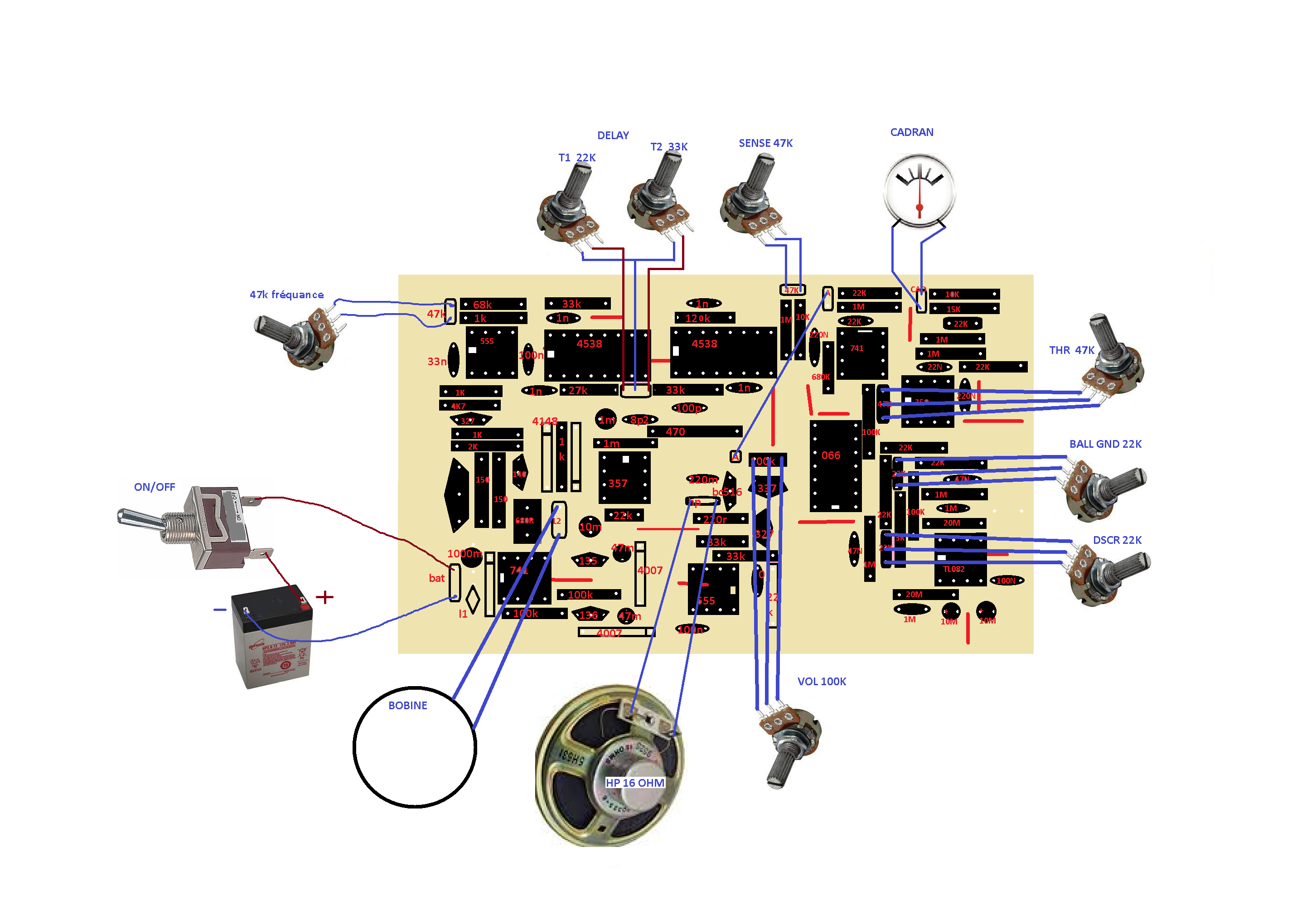

                        Did you ever complete this project?
ID:	362310Click image for larger version

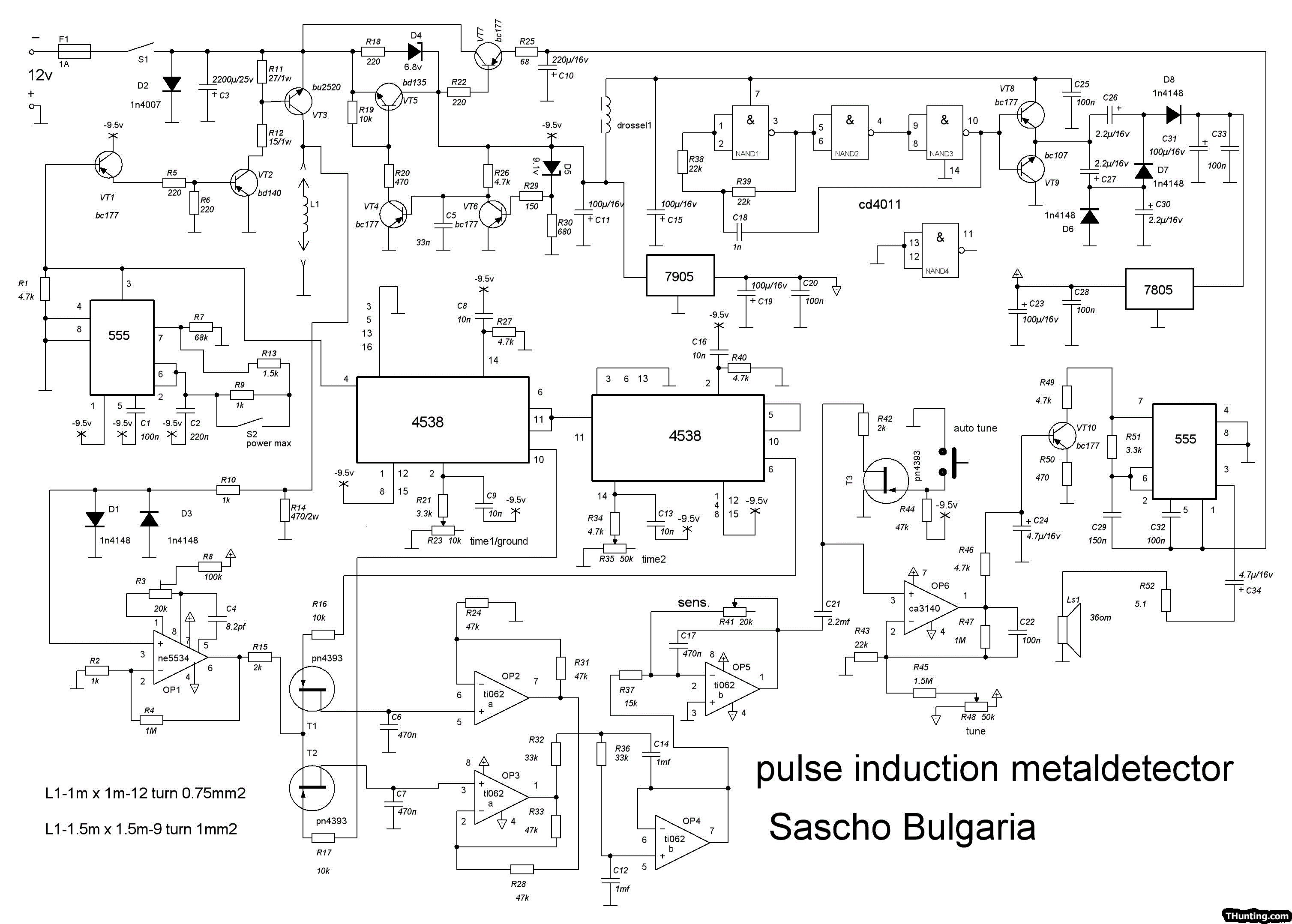

ID:	362311I read in the Iranian forum that someone said the sketch was correct, and I found some differences in it, which I hope will be useful.
                          • I hope someone can make it.
                            • https://drive.google.com/file/d/19I9...w?usp=drivesdk

Name:	pi bulgaria schematic2.jpg
                                Upload the original sketch again for easy viewing
