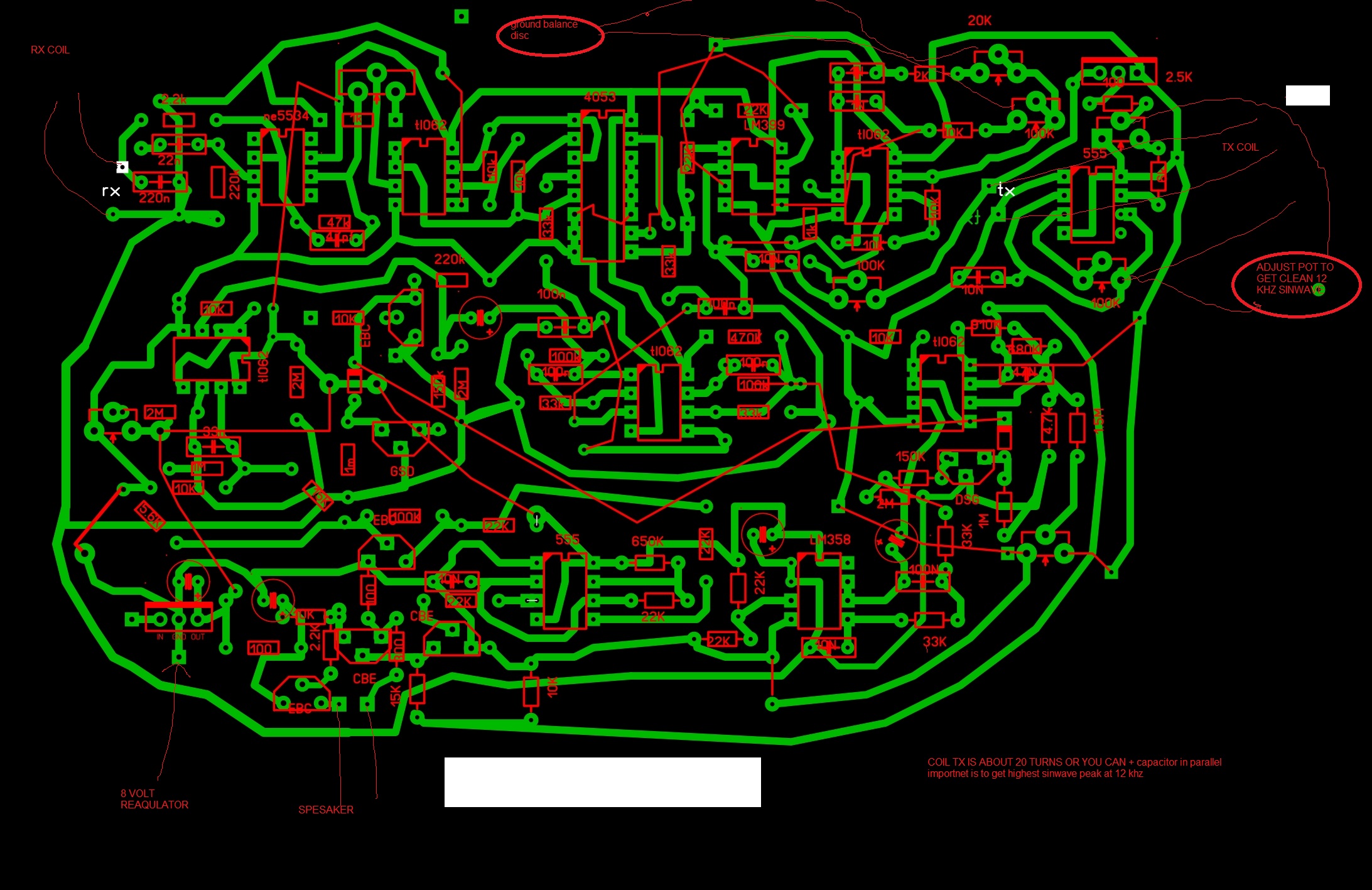

      Hello ossama, any construction files? "schematic, PCB , coil parameters" if possible.
      best regards.
        here is layout in sprint

              thank you ossama for the pcb layout, can you please give us the schematic to checkout the pcb, if there is any errors .
                  best regards.
                  pcb is attached in sprint
                  i will send you schematic
                  coil inductance i will measure and provide

                        here is some details
                        transistor with GSD pin is mosfet
                        other is is bjt transistor

                              to all who ask about sechmatic
                              this metal detector is under modification to get better depth
                              i will share all information as soon as i reach the best of this machine
