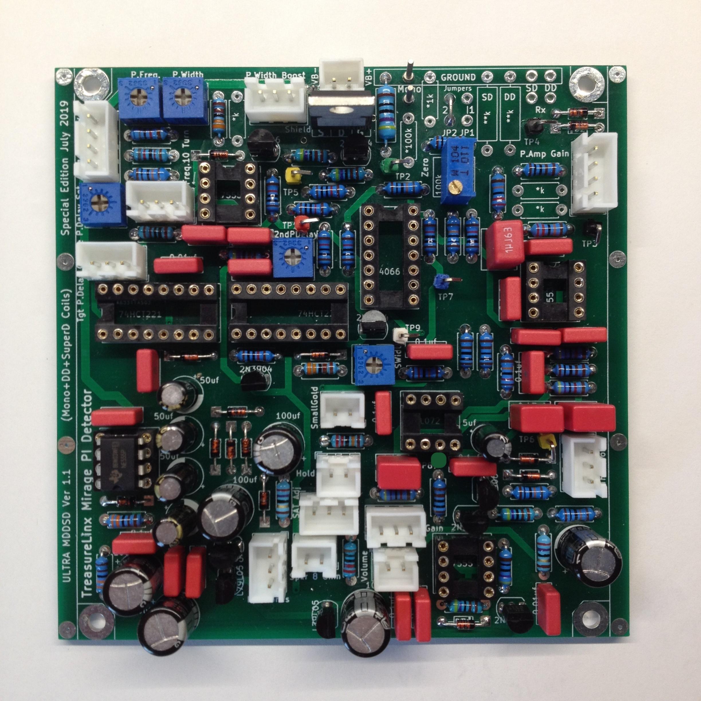

    I've now had pcb's professionally manufactured (double sided, silk screened, pre-drilled etc.), and have them for sale. I have also pulled together a comprehensive parts list, component source recommendations/prices, and fully detailed pcb assembly and calibration instructions (with oscilloscope screen shots), and suggested Takachi project box and hi-res decal graphics for anyone interested in building their own machine(s) - all provided on a DVD. You definitely need access to a dual channel oscilloscope and multi-meter for this build, as it's very finely tuned to the micro-second and milli-volt! It's surprisingly very straight forward though.
    I've attached here a copy of my circuit diagram for the tech heads to mull over, as well as a few photos.

Name:	All Components Fitted (Excl IC's).jpg
ID:	371184Click image for larger version

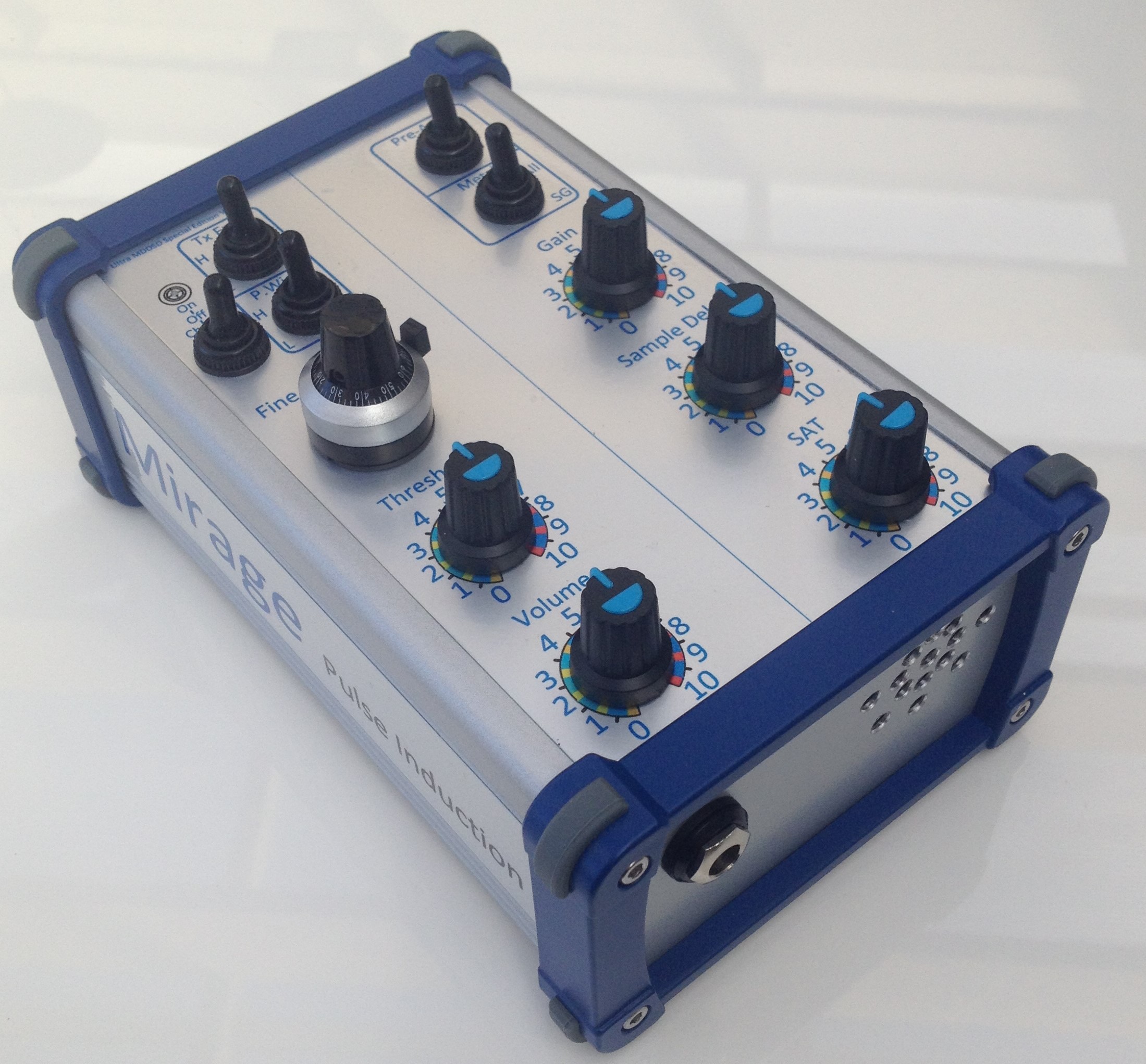

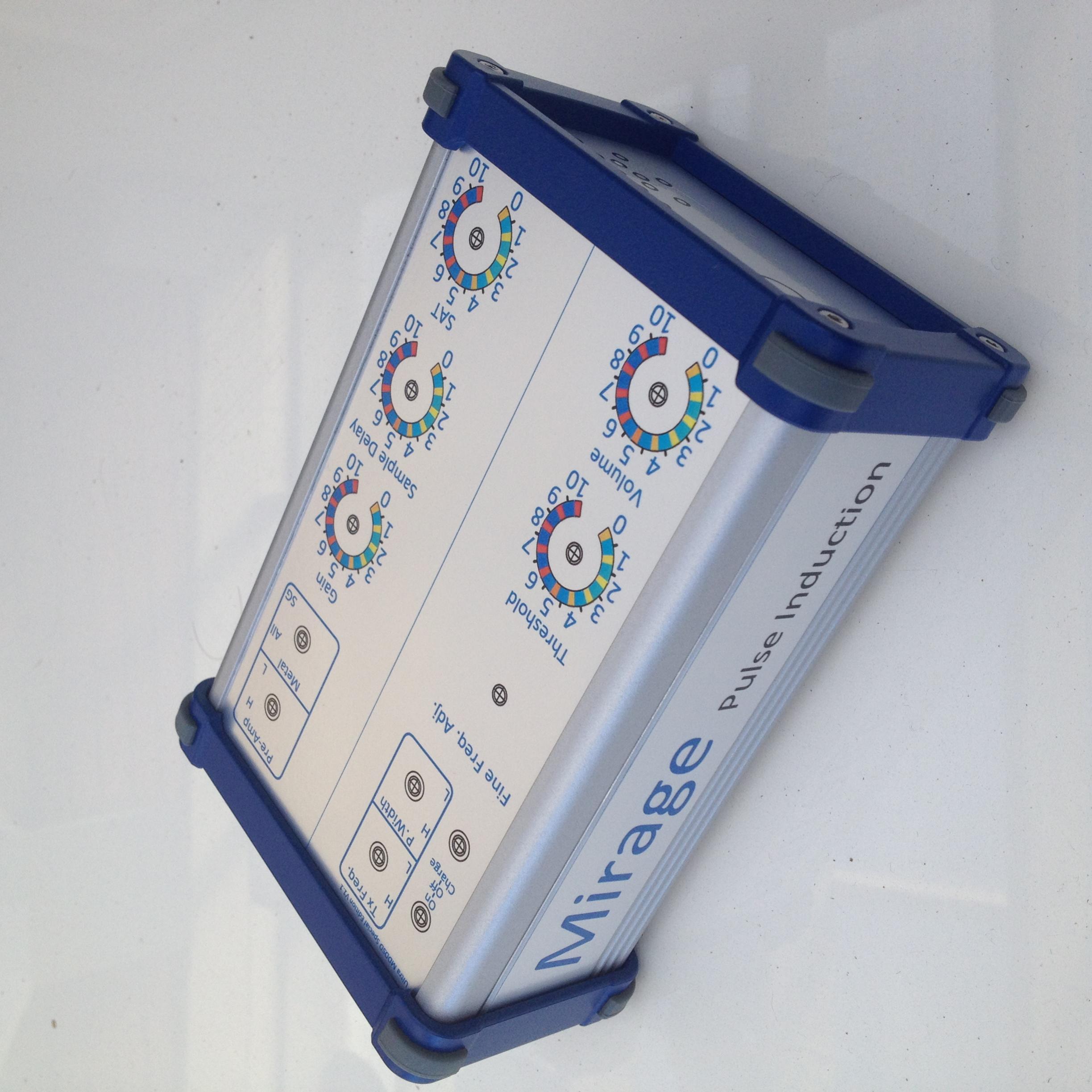

ID:	354792 I haven't made any recordings yet. I've pulled apart the test jig setup and am in the process of transferring everything into the shielded Takachi project box. I really love this box. It's incredibly well designed and manufactured, and is the perfect size! It even has two small metal mesh covered conductive foam rods (2.5mm dia.) to fit inside the interconnecting crevice between the lid and the main box to ensure EMI shielding.
