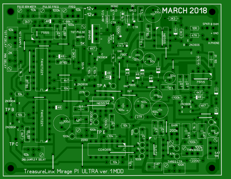

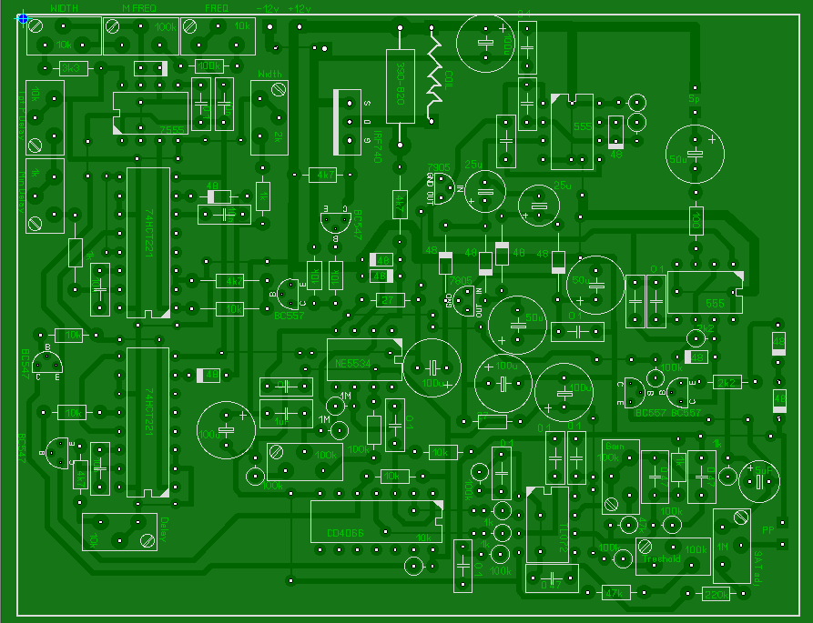

                Good job Elliot taking the Mirage,Manta versions Smitty and I have been working since 2012 to a higher level. Nice PCB layout.
                Here's a couple shots of our orig. version to my last version of the Mirage.
