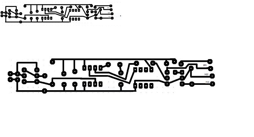

      Here's a Untested PCB I bodged up. You might give it a go.Click image for larger version
        Dhoooooo That PCB is for the MET FM Pic detector. Sorry.
