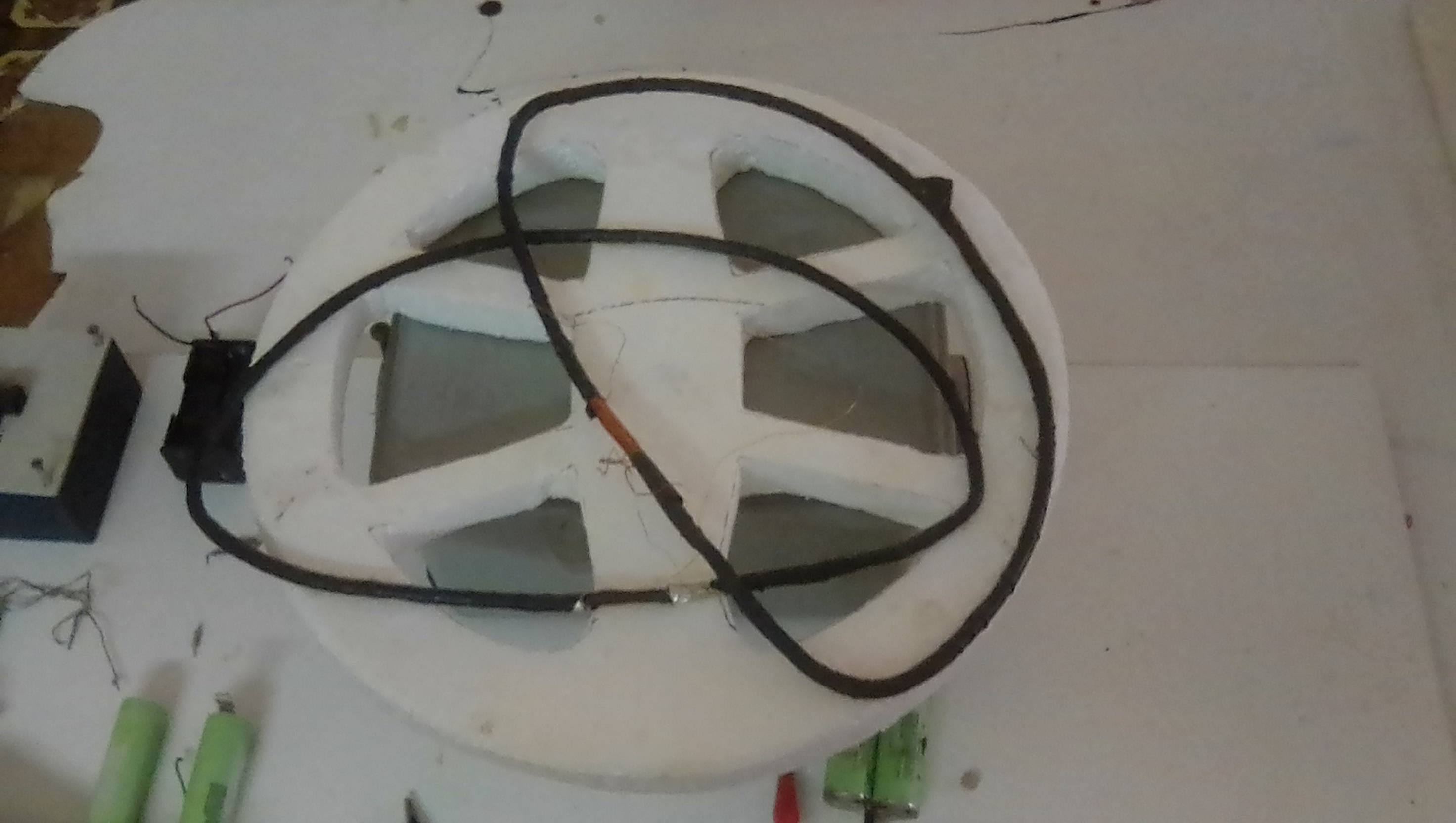

          I have found an NTE7144 in my junk box of parts, but it is with one leg broken, so maybe I can solder a new leg for this poor chip, and give it some new purpose to its existance. I also found an NTE930 in the junk box which is also a BiMOS opamp, so I can also try this one as well.
          I am making PCB today.

            • I have come to an obstacle. I do not have enough wire for 16mH coil.
              Now I have to look around the place to salvage some wire from somewhere. I have some old "big Back" TV's, I could get the wire from the degause coil or maybe from the deflection yoke.

                Usually it is 0.4 to 0.5mm gauge.
                Not suitable for RX coil.
                You better try to find some transformer to dismantle.
                  You are right! I wrapped 10 turns around pencil and measured the width and divide by 10. Diameter is 0.40mm!
                  I have microwave oven transformers in the junk box, the secondary windings are very thin, maybe this will be good enough, but now I have to cut the core to get the wire out.
                  I feel like vagrant of electronics sometimes, always having to scavenge around for basic stuff. But that is the fun of poor man's hobby.

                            I have made some progress, just finished winding some coils. Now I have to finish populating the PCB. Some components are still missing, like the CA3140 chip. But I will use a substitute. I hope to begin testing in earnest in a couple days.
                            I made simple DD coil, 8 inches in diameter. It is rough but good enough for preliminary testing.
                            I have no doubt that the thing will work, only question for me is what will be the discrimination. This will be the tricky part, whether or not the Rx coil is left untuned.
