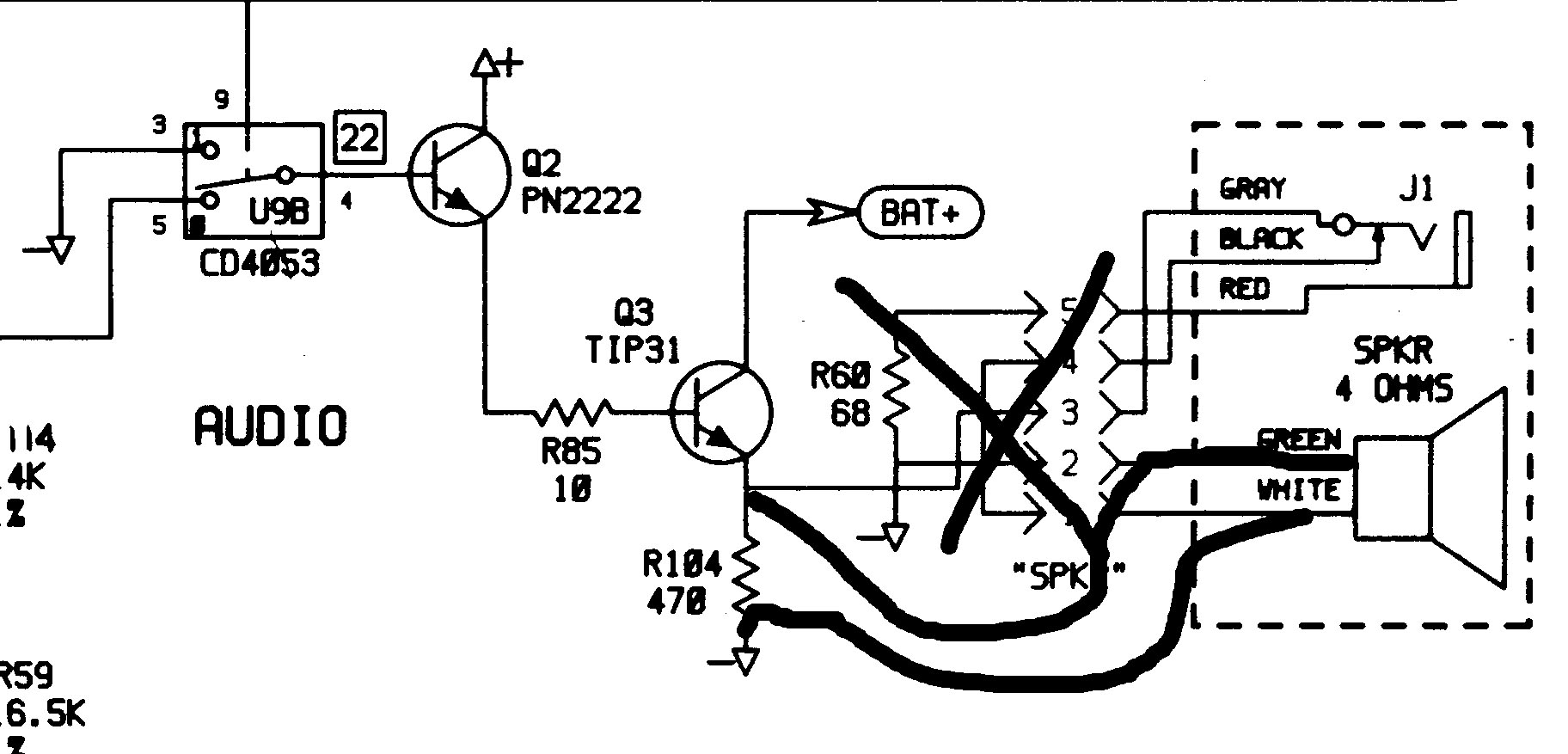

      change sound part on this Click image for larger version
      its more right.
