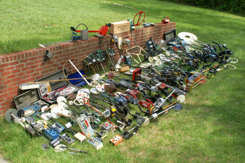

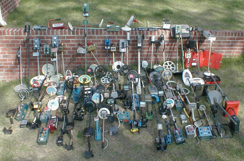

                      Carl detectors collection
