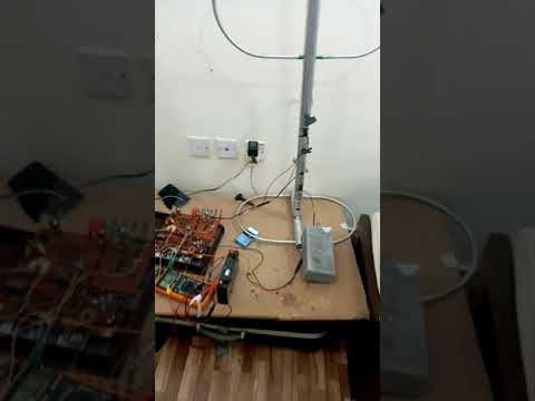

    I do test for cash around 200 ml liter of coins in plastic container but I not that the device can see this at 50 cm but in different reaction

      yesterday i decide to make another test I change the phase 180 degree then the device start detecting this cash normally.
      your comments highly appreciated regarding this

                              Full iron rejection by Tm808 success
                              Thank for all great people in this fourm
                                with iron rejection you lose seriously the depth. do not exult.
