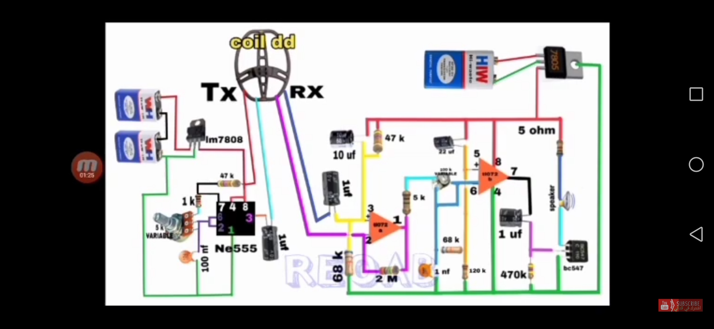

    Does anyone recognize this scheme
    I need explanation and how deep in the ground it is?

    Simplest pulse induction md called "Pirat MD" but with DD coil instead of mono. Nothing special but may have some type of discrimination to iron, must be tuned for every minute and less sensitive than Hammerhead or Surf PI.

        Hach, that's a really crude and basic TR circuit, only good for teaching the fundamentals of IB metal detection. I'd guess it has very little depth.

          Pretty much alike in general, but TX power pulse transistor is missing here. So at the end more IB than PI.
            leave this fantazy to its author. depth matter is absent in this schematic.

              The author said depth will be 80cm to 1m for big objects and 25cm for coins if I only use TX coil 0.5m wire diameter 20cm 100 turn and Rx coil 0.22m 300 turn diameter 20cm.
              The question is that possible??!

                        I made it.
                        30to 50 cm for very big iron slide
                        5cm for coins
                        Wedding rings only 2to 3 cm
                        It's sucks!!!
                        I need simple schema that really give 25cm for coins.

                          Just "wishing" something would work better does not work, getting a coin at 25cm in the ground is not an easy task with simple circuits, even complex circuits dont always work

                              Is that so hard to search the forum for projects? TGSL, IDX, Hammerhead, Minipulse, Baracuda etc.
