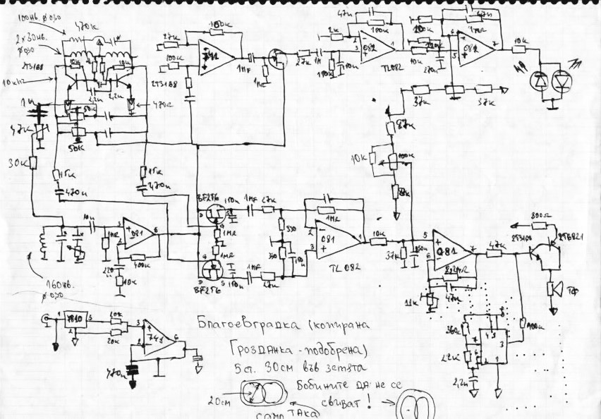

    something from you now. i would like to make new folder and fill it by info. this schema i just have.
    TIA
    I have different schematic with same name.
    Those are old attempts.
    Accent was mostly on properly made coil.
    Rest of schematic is usually poor.
    I never tried any of those.

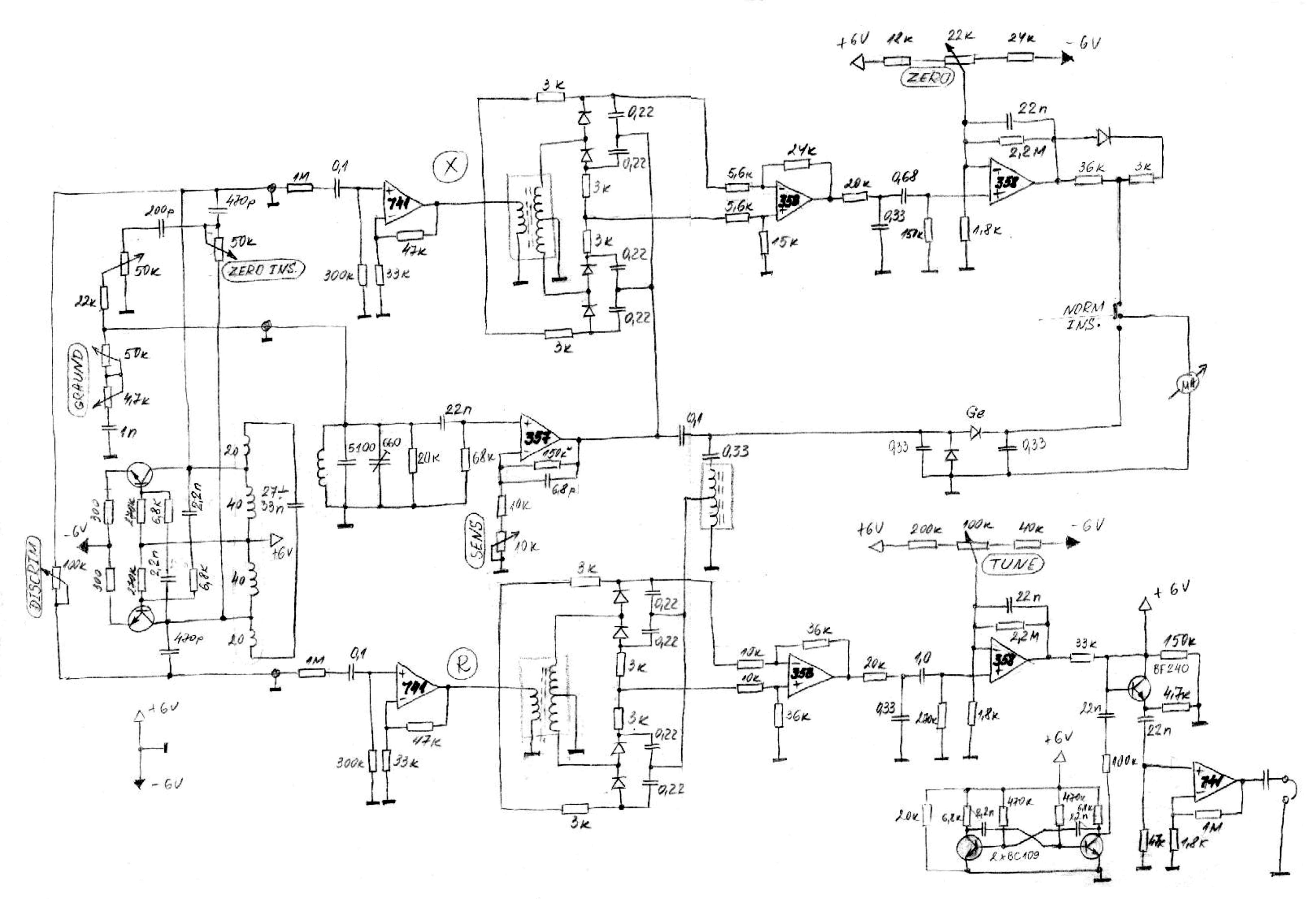

                        This is my circuit . This circuit is very sens. end i thing is the best of the best. The TX coil make 160volt. Drill ground like chise.
                        Circuit is very good but not easy to adjust. Nexus is similar circuit . You can't compare this metal detector with another . This metal detector see coin on 40cm and more without any problem this is 160-200v on transmitter.

                            Yes , this icircuit on top , I make this before 30 years ago. If you make that and adjust good , you will forget for all another bullsheet !
                              I will explain briefly what this is about.
                              How does the scheme work? Normally the detectors work on phase shift, but here we have a natural amplification of this shift. The generator operates with a voltage higher than 150 volts. Then the effect manifests itself. The circuit became very sensitive and this required a change in the generator. In fact, this is not the full scheme. I changed the generator later because it was affected by temperature. I used a fisher generator. There are no capacitors in it.
