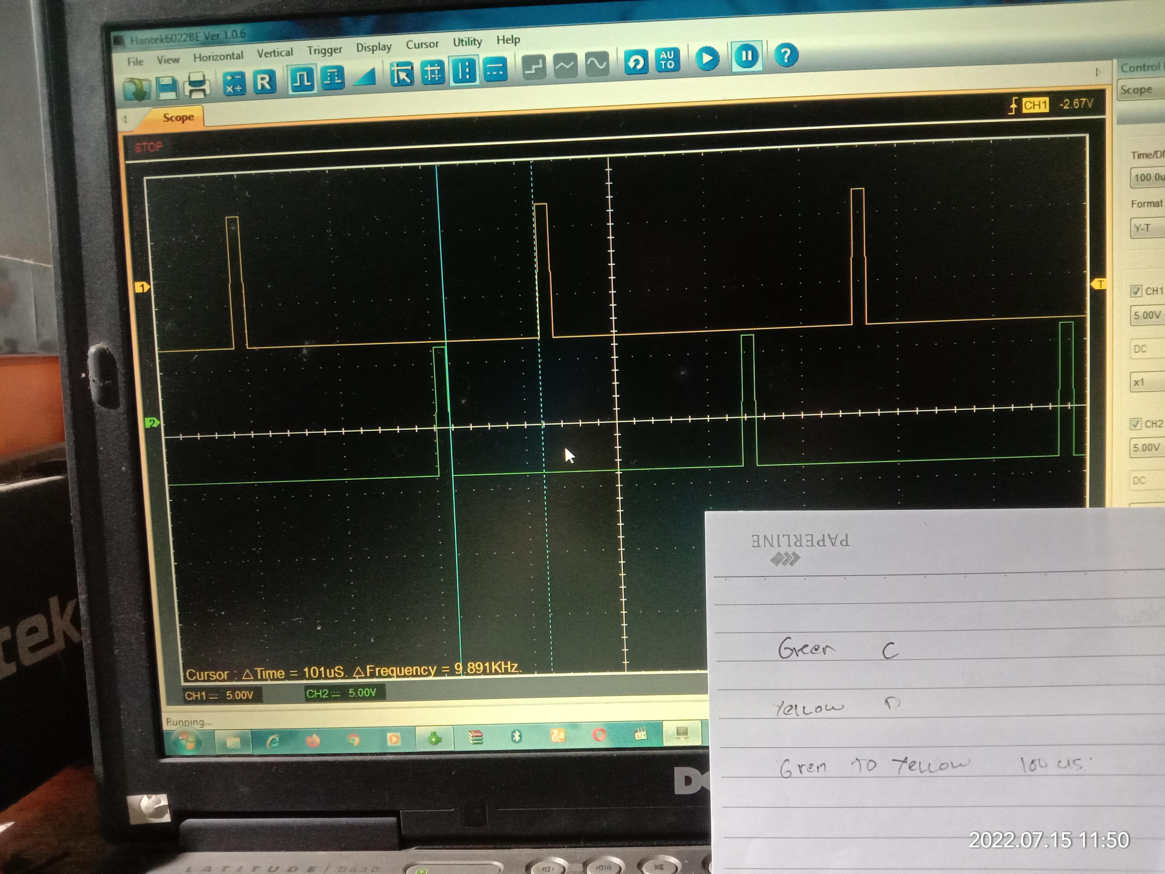

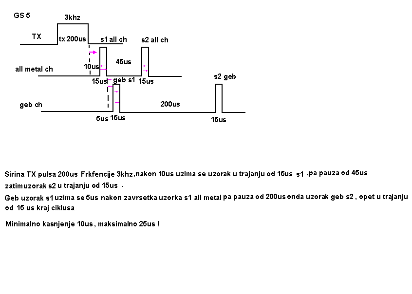

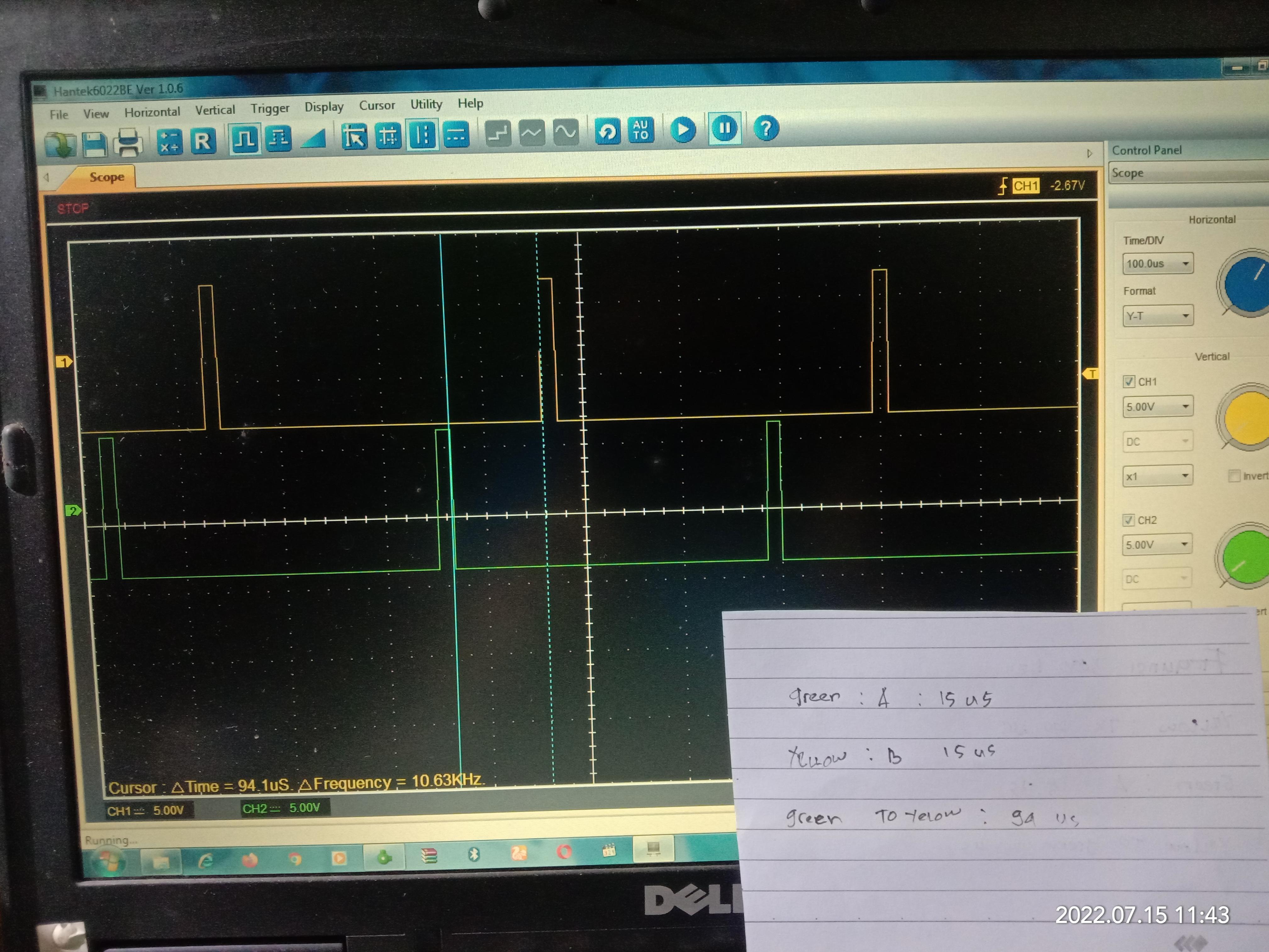

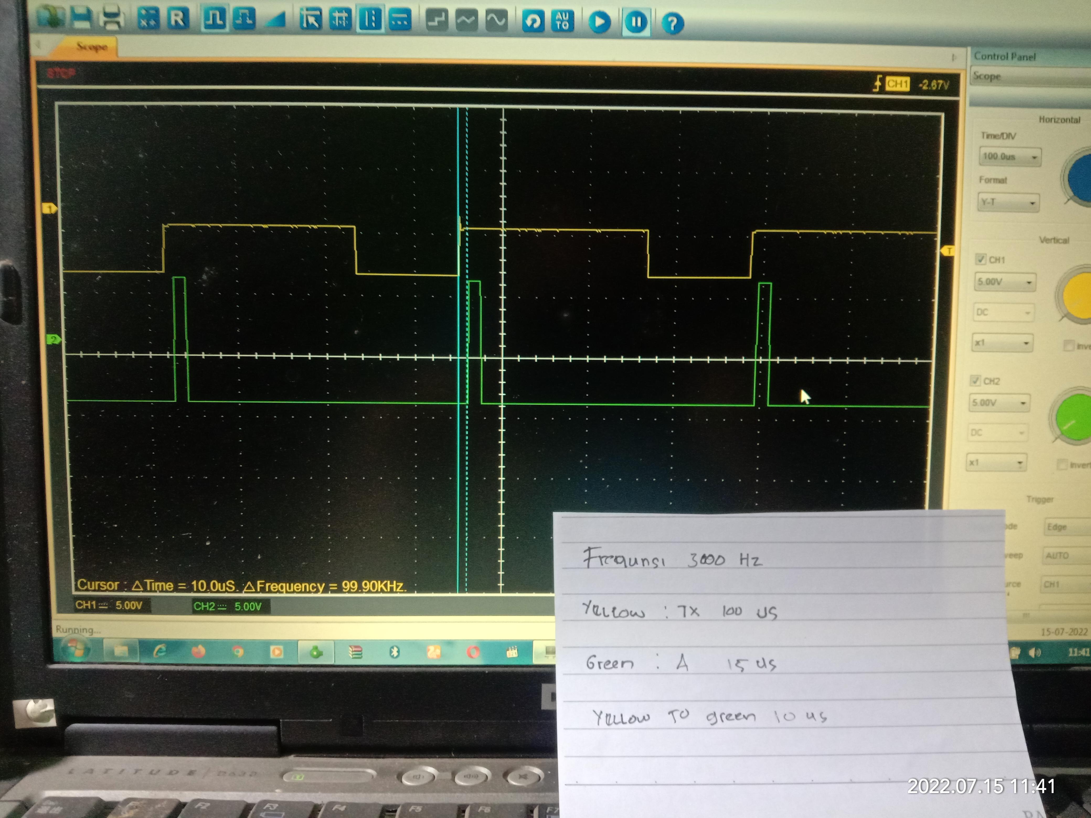

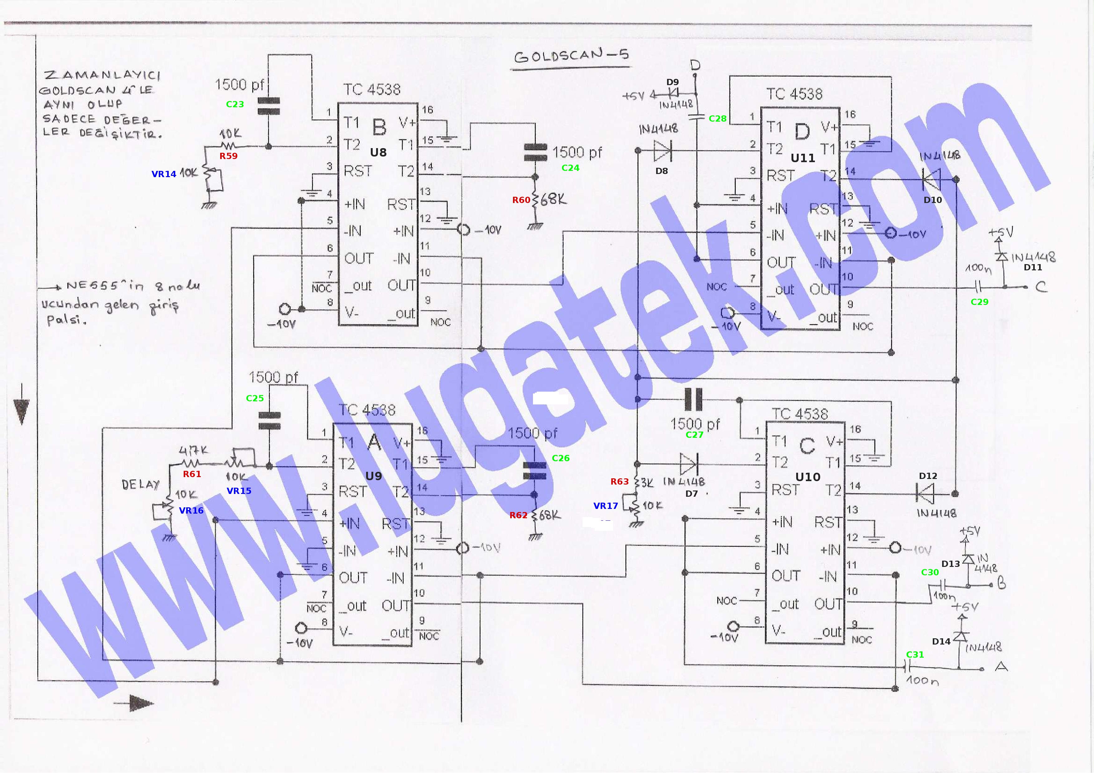

                hello everyone, I'm working on 2 schemes, vlf and pi, all of them I'm still having problems with the ground balance, for PI I'm working on gs5, in this timing scheme there is something that makes me confused; how to change the timming width between A and B. what components do I need to change? because in the guide in the title gs5 I found the timming width was 45us while in my oscope it was 96us,Click image for larger version

                  Privet Bayu.Zdravo.Hello.
                  google say:
                  "The width of the Tx pulse is 200 microseconds. After 10 microseconds, you take first sample with a width of 15 microseconds, followed by a break of 45 microseconds. Then you take second sample with a width 15 microseconds.This is for all metal mode.
                  Ground sample you take 5 mictoseconds after end of first sample in all metal mode. This is first ground sample with a width 15 microseconds. Then there is a break of 200 microseconds after first ground sample.Than you take second ground sample with width 15 microseconds. Minimal delay between tx pulse and fitst sample in all metal mode is 7.05 microseconds. This is VR15=0 VR16=0 R61=4К7. Мaximum 37.05 microseconds. This is VR15=10К VR16=10К R61=4К7."
                  Uspehov. Uspeha. Succes.

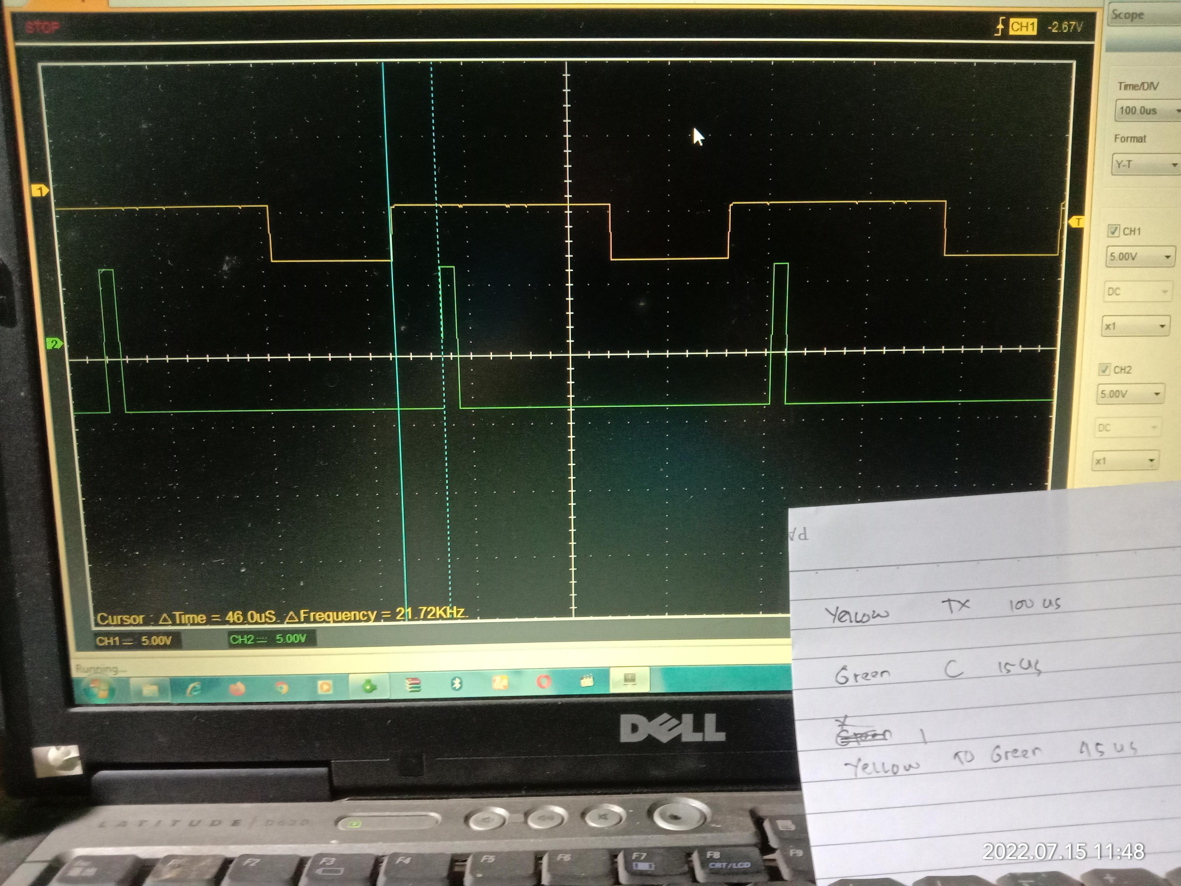

                  • #99
                    S2-all should be 200us after S1-all, the same as between S1-geb and S2-geb. It will work with a shorter delay but will reduce depth and Earth field cancellation may not be as good.
                    I don't know what A and B are for but it looks like the delay between them is set by R62 and C26. The delay between C & D are set by R60 & C24, so the A-B delay should be the same as the C-D delay. If these correspond to the S1-S2 pulses then that would be correct.

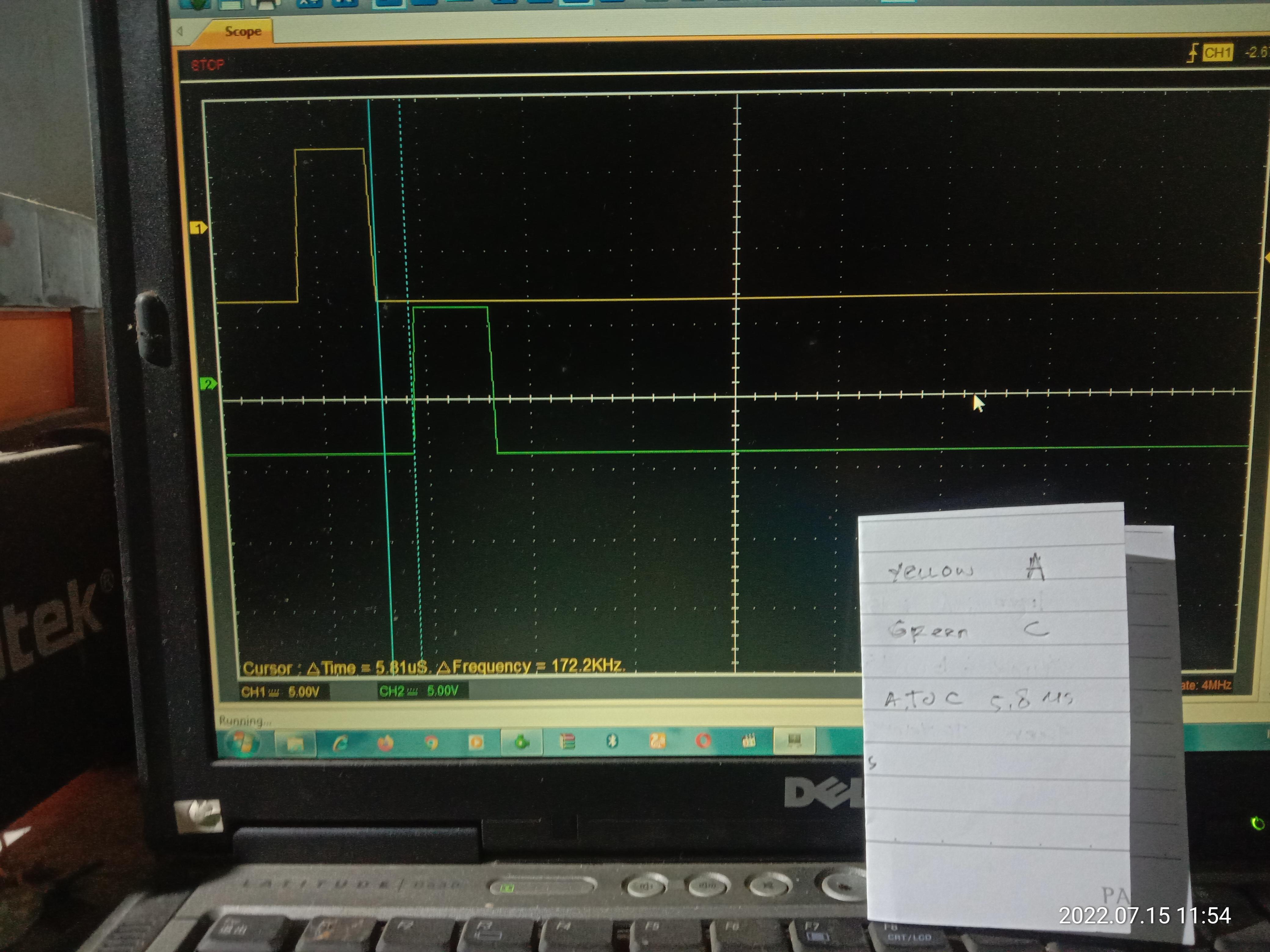

                    • My understanding is that for a GB like the one used in the GS5 or TDI, the distance between the two samples must be exactly the same on both channels, as must the pulse width on the different samples. The typical value is 100us or less and 15us respectively.
                      The GB channel is 5us from the end time of the first sample of the channel called gold or all metal.
                      TX pulse width is 100us for 3.2Khz.
                      The times mentioned above for TX and the separation of the samples are conditioned by the frequency of 3.2 kHz.
                        my measurement result

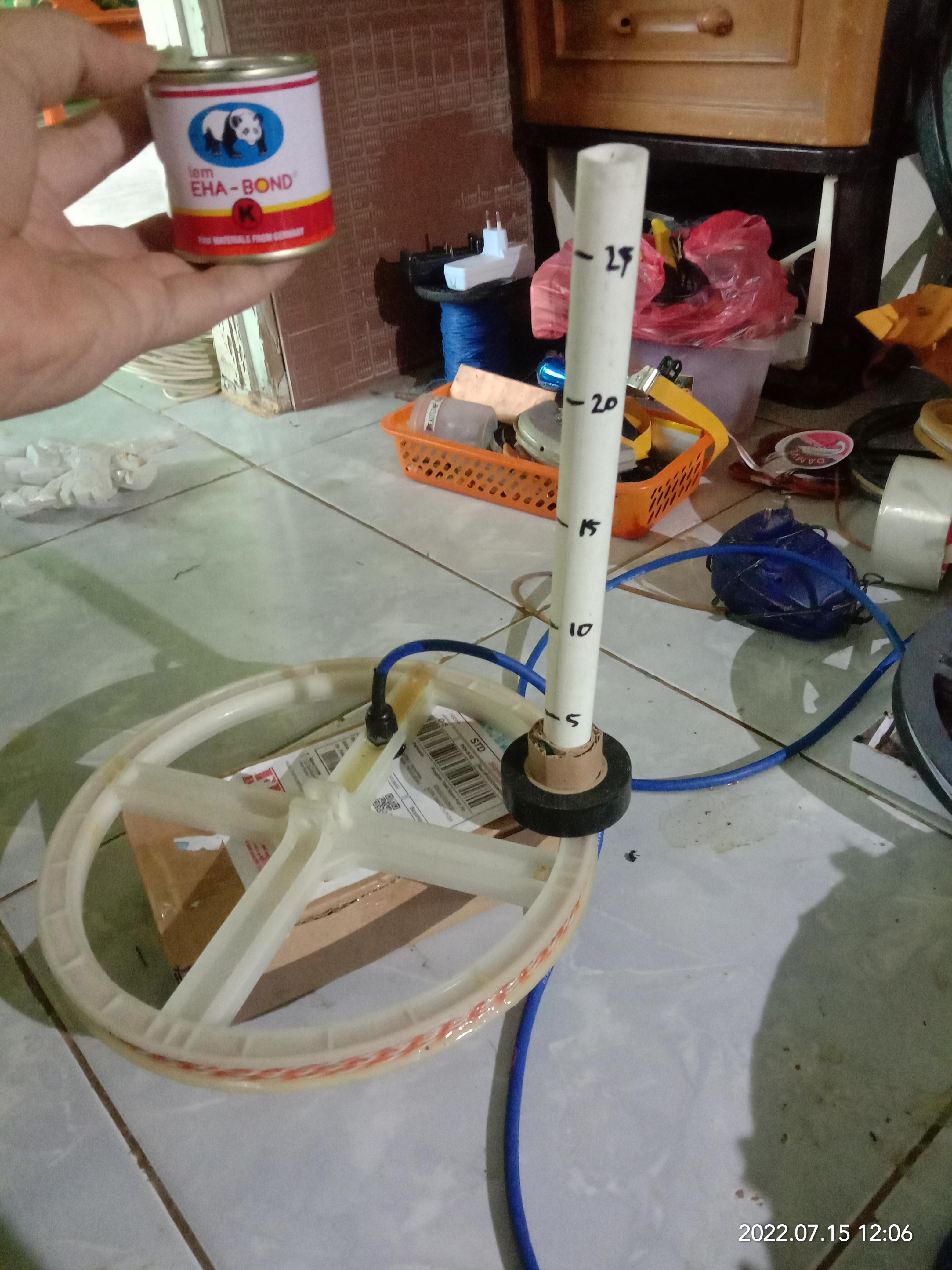

ID:	363167 glue can only 25cm.
                          please check my measurement result

                            • Gold ring 18k 2gram only 10cm
