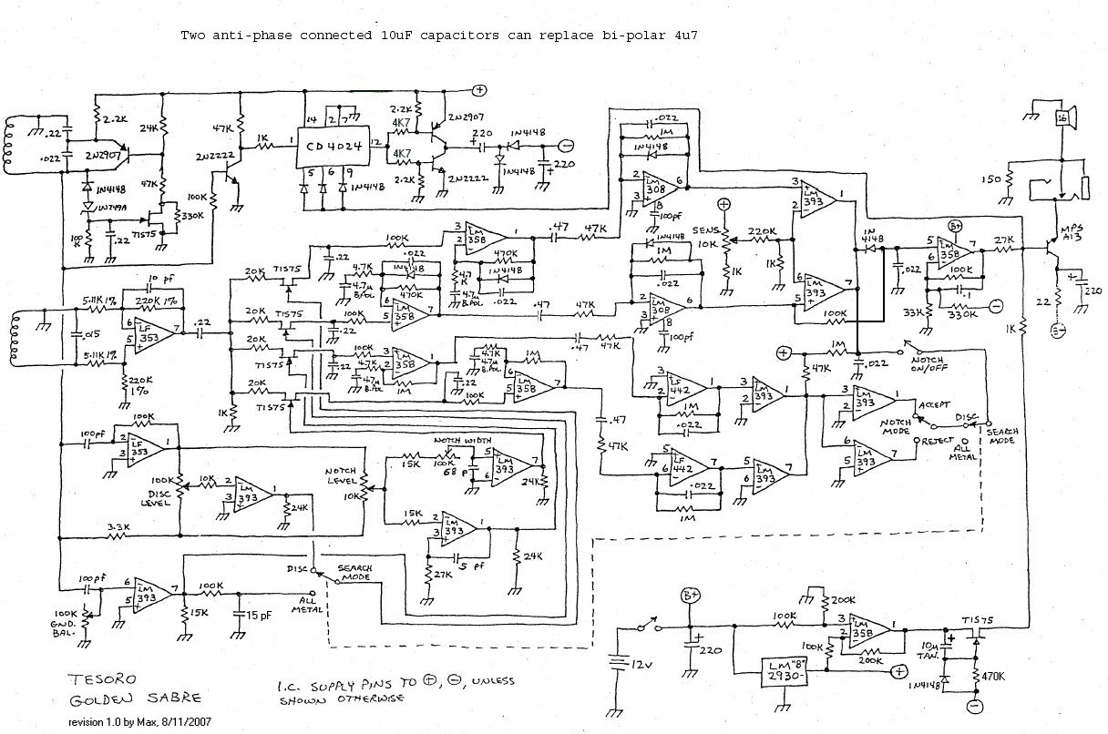

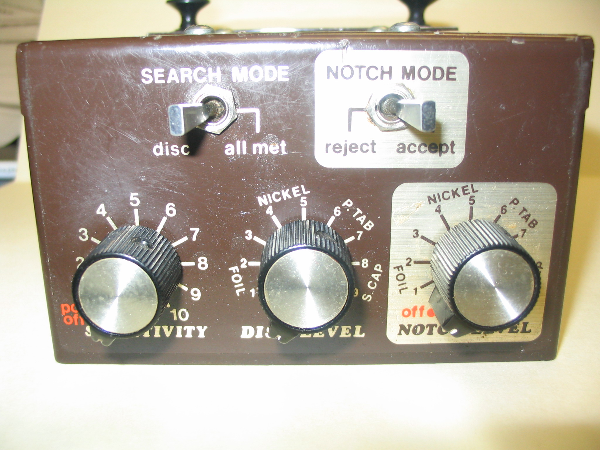

    Hi! I'm from Germany and hardcore tesoro User. I bought a tesoro Golden Sabre plus and it isn't working. Is there a Chance to get schematics ? Thanks for your Help.

    anybody will give you it. but... can you give pics of -
    -- box
    -- pcb
    being so pleasure for geotechers?

      Try this ->

          As far as I know, the GS Plus runs at 15kHz, and the GS runs at 12kHz. I suspect they are still closely related, so the schematic may still be some help.
            Thanks fot your answers! I'll upload Pictures as soon as i'm at home. Yes. Its 15 kHz and two Tone
              yes George this is sure GMT, in a schematic. thank you.

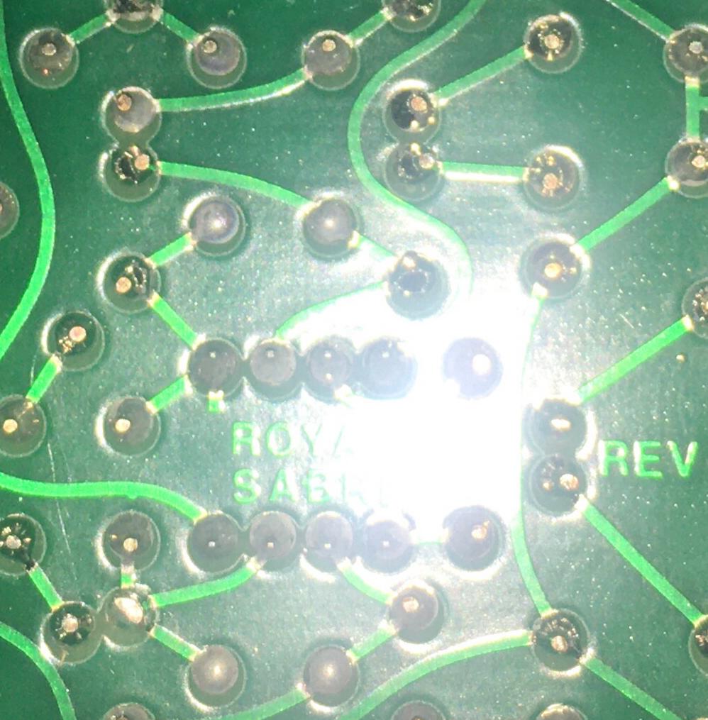

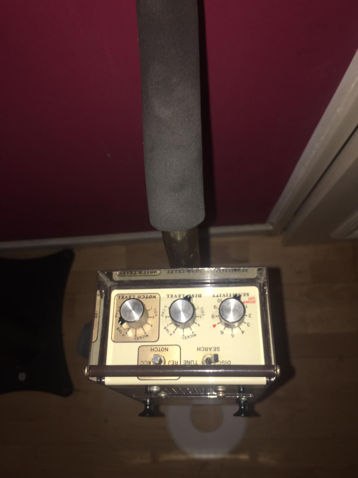

                Thanks for your help! Meanwhile i got the Problem solved. IT was a Bad Connection at the modded battery Check.. i try to Upload somePictures.
ID:	357992Click image for larger version
