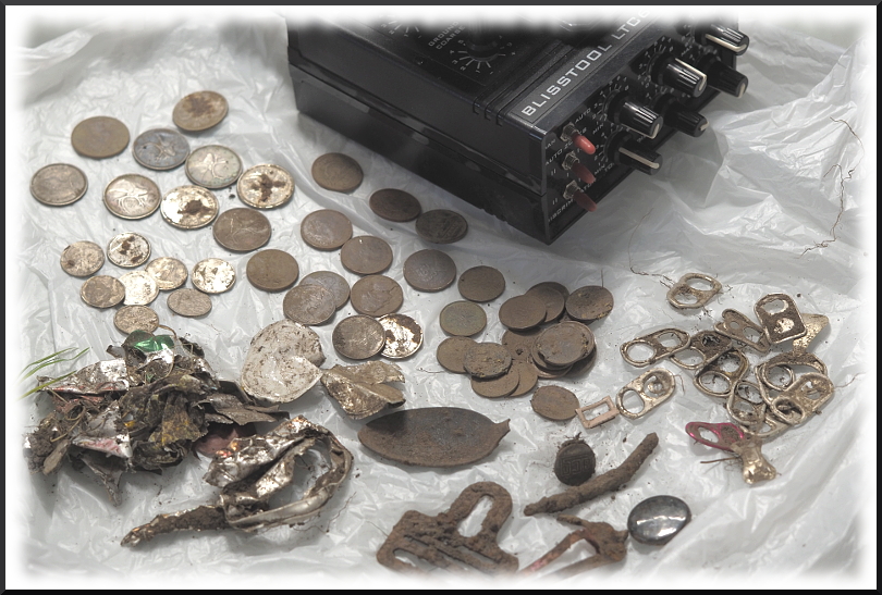

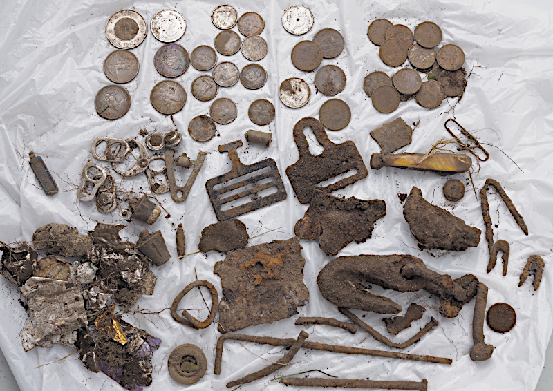

        I actually found the V5 with the 7x9 coil attached an excellent detector for coin hunting in schoolyards and parks.
        Fast set up and away you go hunting. Discriminator works very nice.

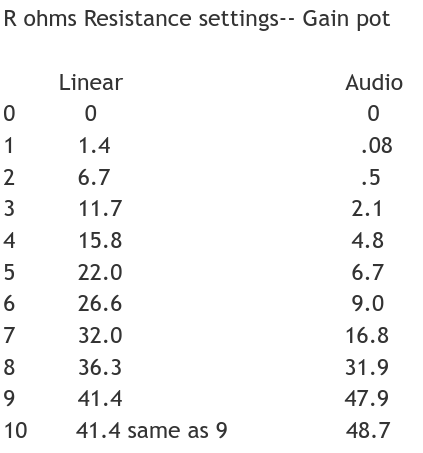

        Did change the Gain pot from a linear to an audio taper. Since running past gain settings of 2-3 for the most part is not needed as per forum posts, Gain 3 is like Gain on other detectors at max.
        Most run with a Gain 0f 0-2, making the rest of the pot rotation kind of a waste. By using the log taper pot, Gain was spread out making it more usable. See chart.
