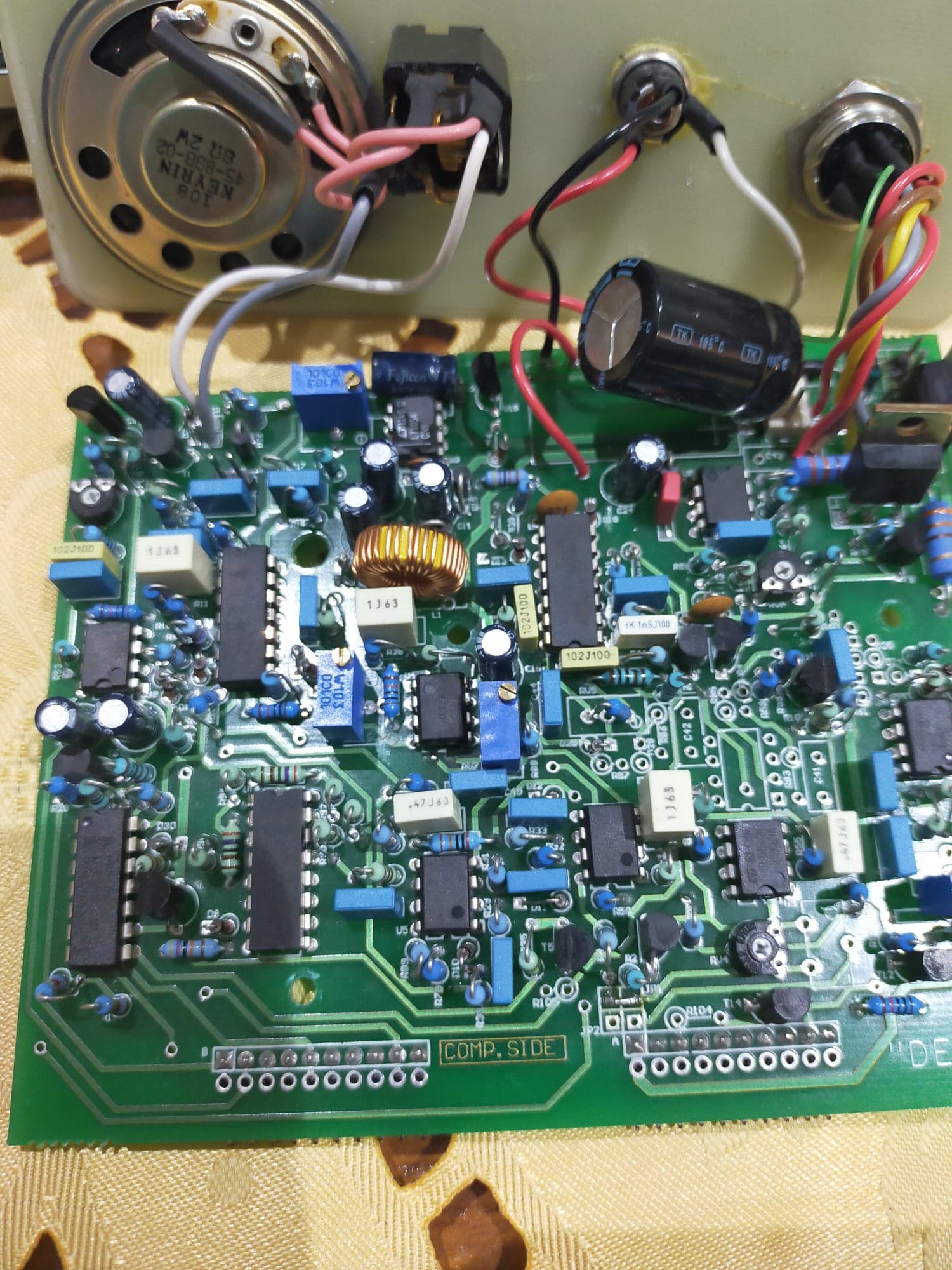

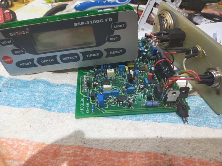

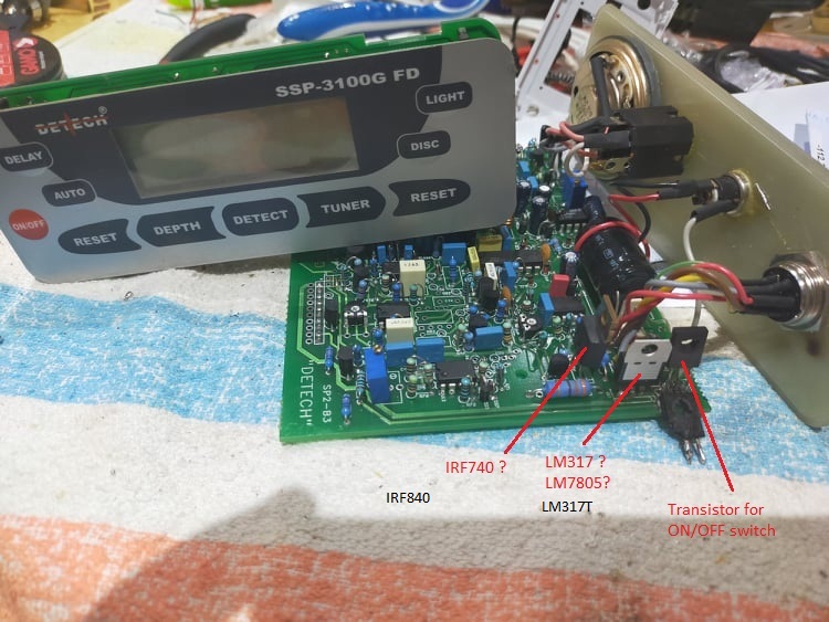

    HELLO PLEASE I NEED A LITTLE FAVOR I NEED SSP-3100G schematic U THE TRANSISTOR THIS HAS BEEN LIGHTNING AND THANKS FOR EVERYTHING FRIENDSClick image for larger version

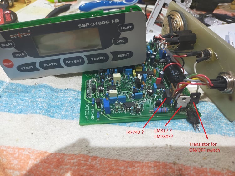

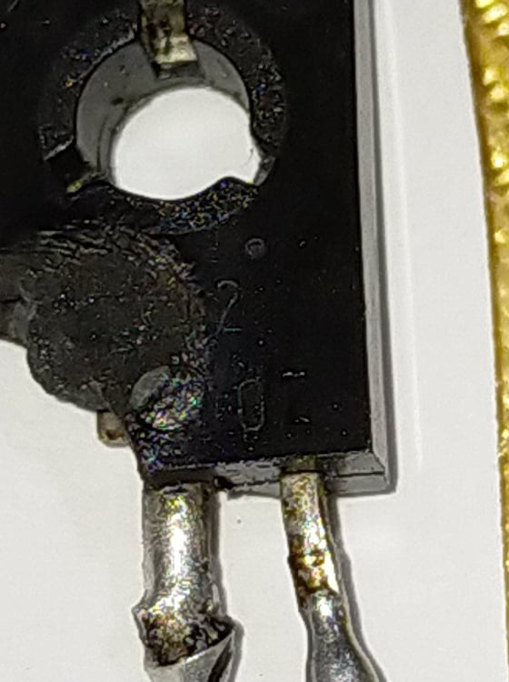

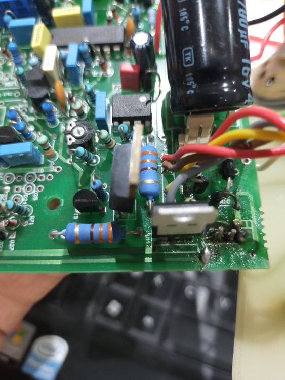

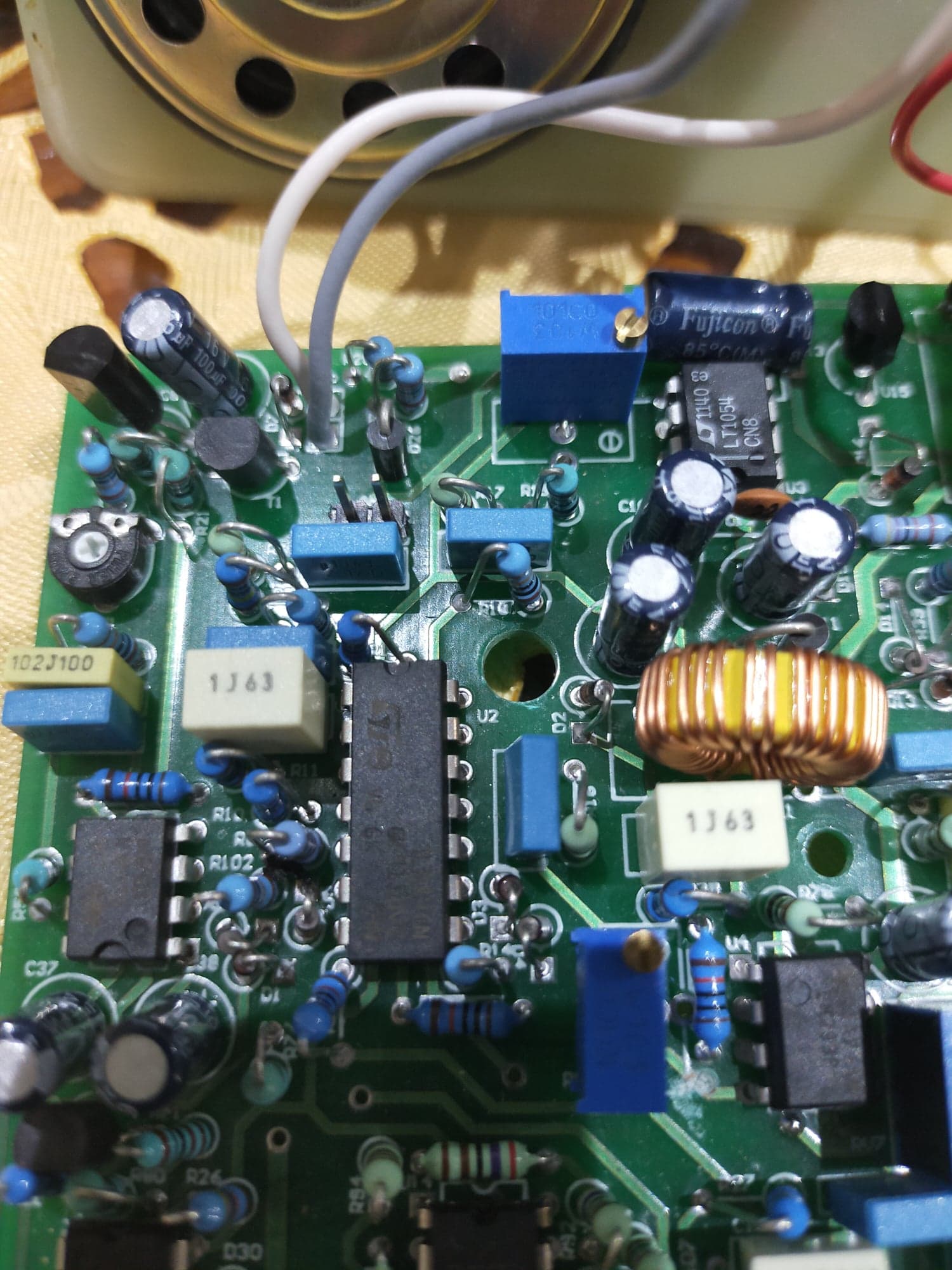

    Hi gombary!
    And for now your detector did not work at all? Or still work, but without sound?
    It seems like this transistor do on/off switch function, for me it all looks like somebody conect battery in wrong polarity.
    This transistor may be BD140 or BD139 i dont know.

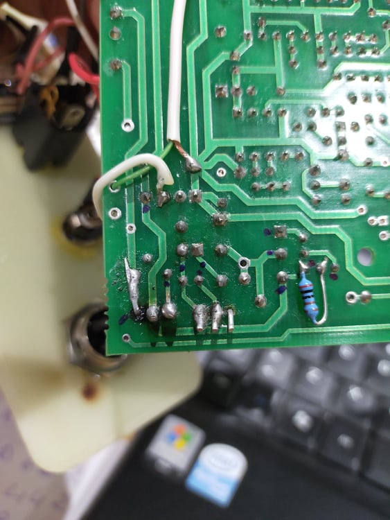

    Need foto at bottom and top of pcb, only around burned transistor place.

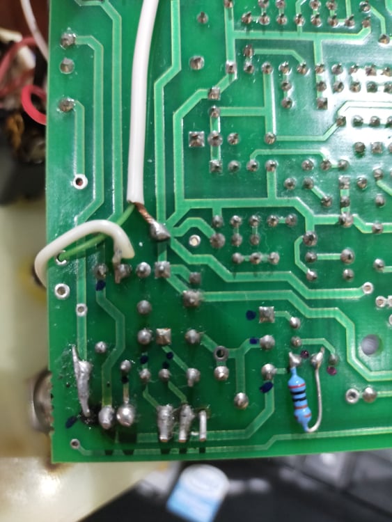

    And can you read marking code of this parts Click image for larger version

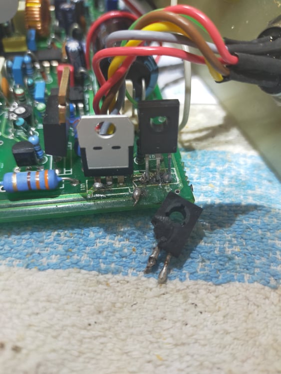

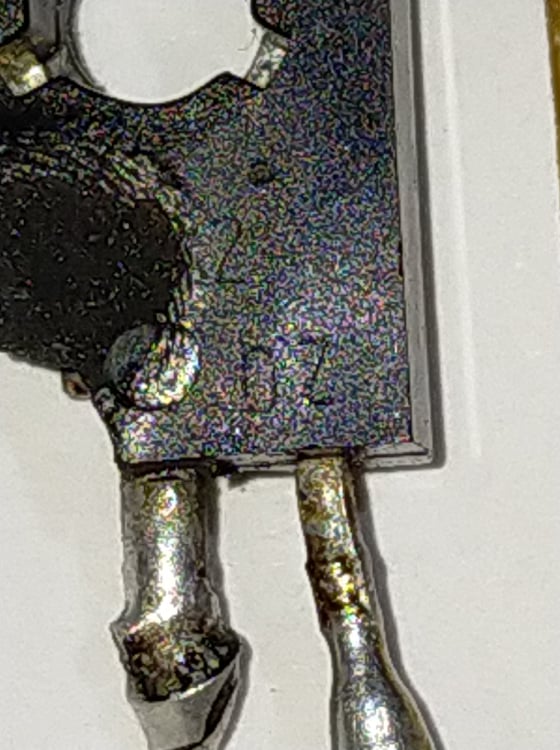

      you are very good vadim, yes it works, but without sound
      and true the battery charger has been connected with the wrong polarityClick image for larger version

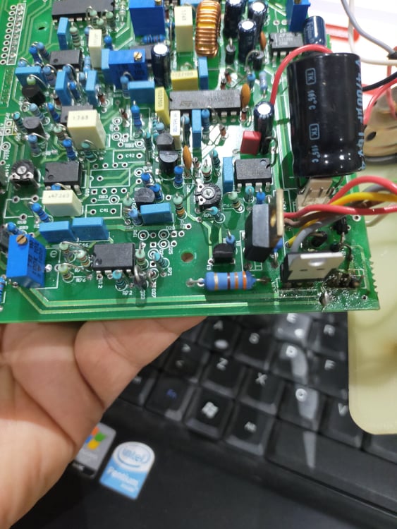

        see theseClick image for larger version

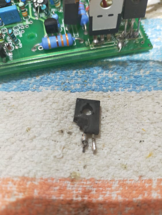

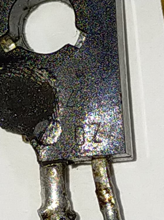

          If you google images of bd139 and 140 they show they end in a 9 or a 0 this tranny looks like it ends in a 2, can you measure anything with a multimeter between the two pins
            Thanks gombay, thanks for your photos. Now we closer to proper answer.
            Im take a try to understand.
              let's hope Vadim
                I don't understand what you mean 6666

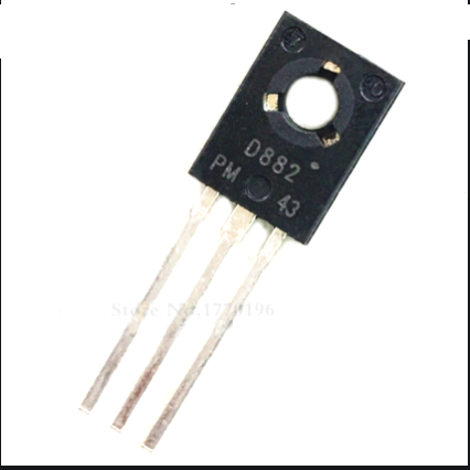

                  Im not shure by 100%, but this secret transistor may be SD882 or SD772.

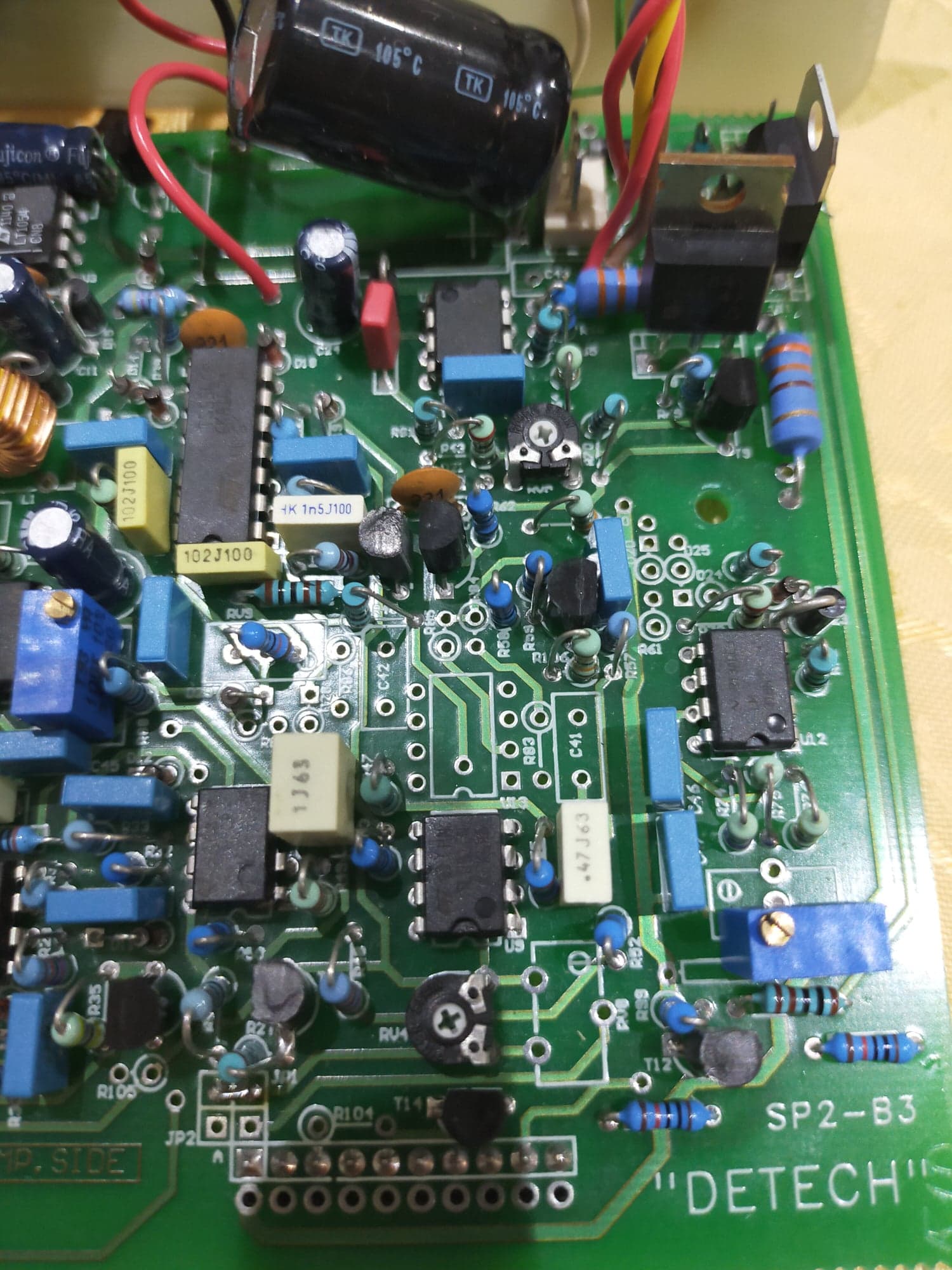

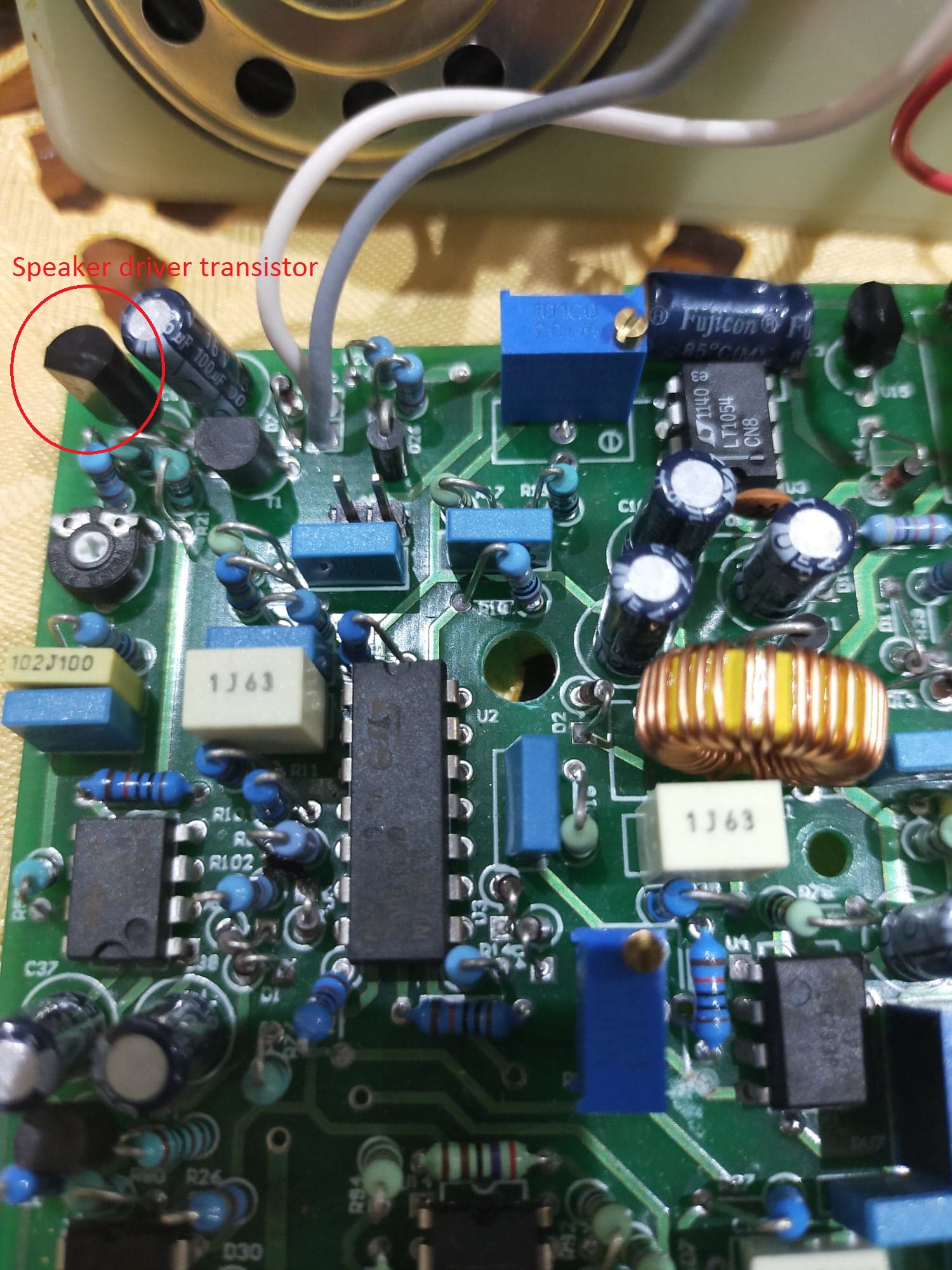

                  Check somehow speaker, maybe speaker driver also burned.
                    ok thanks Vadim, I try all 3 transistors and then I will let you know, you have been very kind, thanks
                    speaker driver burned would be which one on the Click image for larger version

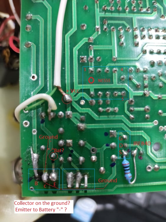

                      Ok, first check SD882. Likely most this is SD882 transistor, not SD772
                      Before you place new transistor can you measure voltage betwen "+Vcc" and "-Bat" points, i marked them on photo Click image for larger version
Name:	Power on-off transistor.jpg
                      This is Speaker driver Click image for larger version
Name:	Speaker transistor.jpg
                      And be aware - I may be wrong. You still have all chances to fully damage your unit, dont rush.
                      So better if one of forum users confirm my conclusions.
                        measure the voltage between the points "+ Vcc" and "-Bat" --- and 10.81V
