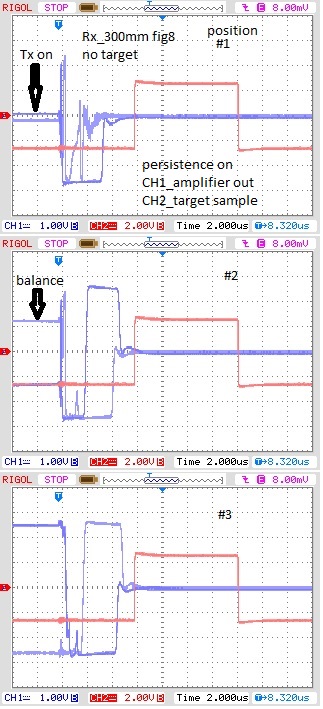

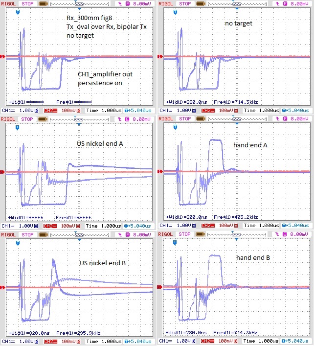

              Attempt at measuring hand TC. Used the coil I was playing with. Recorded amplifier out, persistence on to get both Tx polarities.
              Some observations.
              One Tx polarity effected more than other, a ferrite core(positioned on coil) was used to adjust what no target signal looked like.
              It appears X signal dominates R signal out to maybe 4us.
              With the nickel, signal reversed end A to end B. With hand as target, signal changed from no target but appears to be the same end A and end B(maybe hand isn't acting as a target?).
              Don't know it means? Looking at each end of Tx coil with the scope, similar but not the same.
              Hand doesn't seem to be detected with scope disconnected from circuit. Sometimes with scope connected seems it does detect the hand, where the scope is connected can make it worse.
              Wish I had some answers not questions.
              Anything else I might try?
              CH2 not important, should have turned off.
                  Some scope pictures with ferrite core located in three different positions on the coil to balance. Had some hand detection with scope connected to circuit with all positions, position #1 only with scope disconnected.

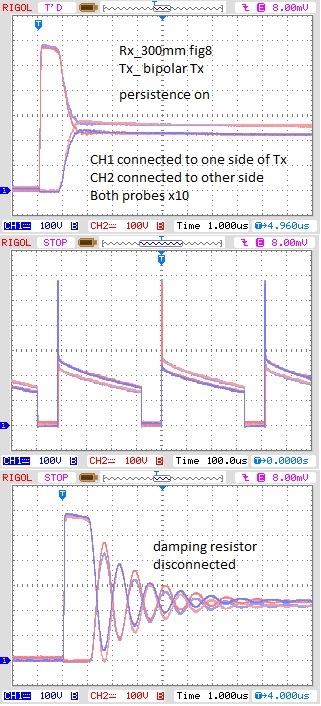

                    Scope pictures, waveform similar but Tx off decayed to a different value. Maybe NFET Coss not the same? Some other reason? Should it matter?
                          Hi green,
                          seems me the TX_bipolar is not balanced respect to 0V.
                          Do you tried to swap the scope probes?
