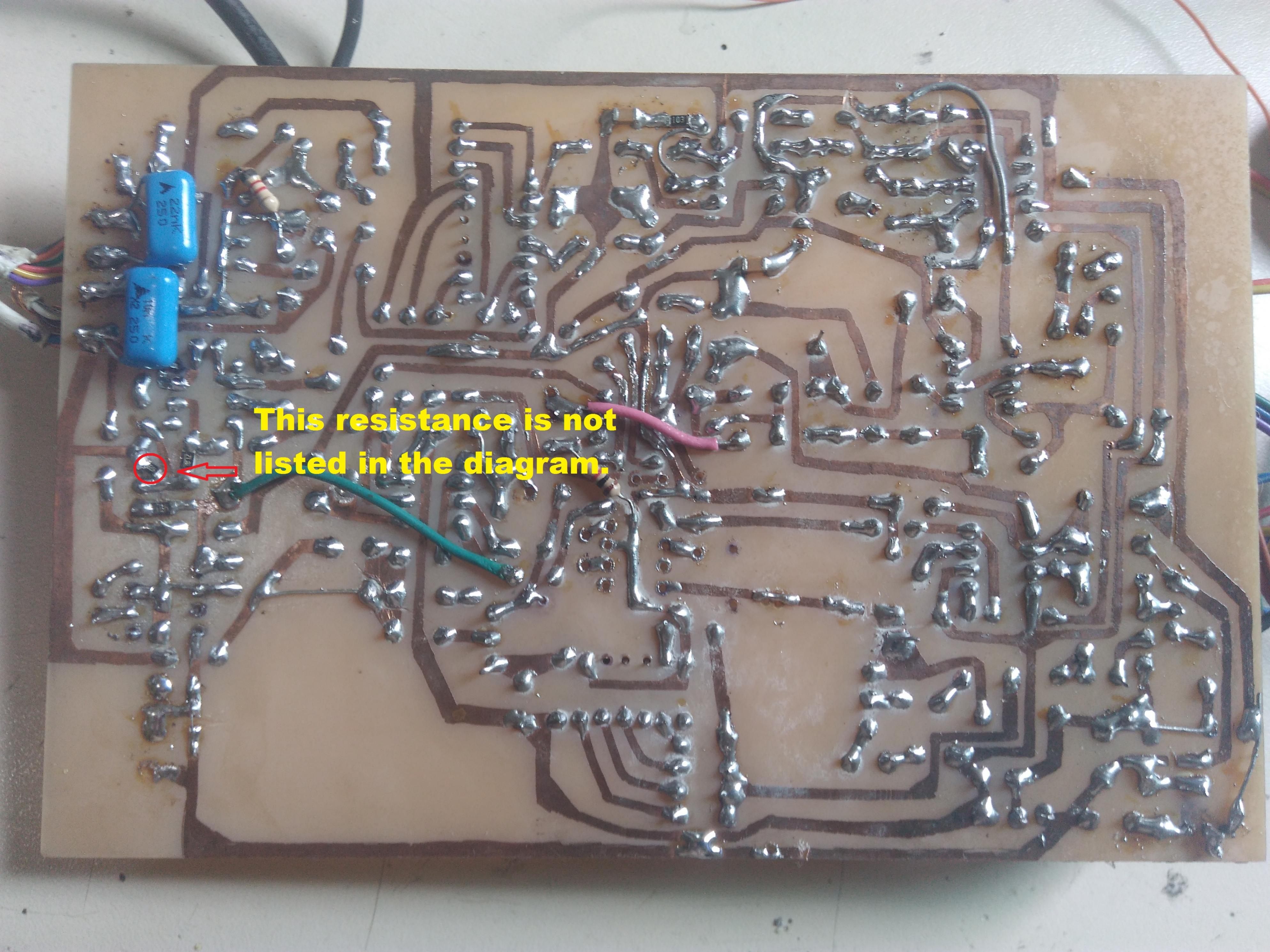

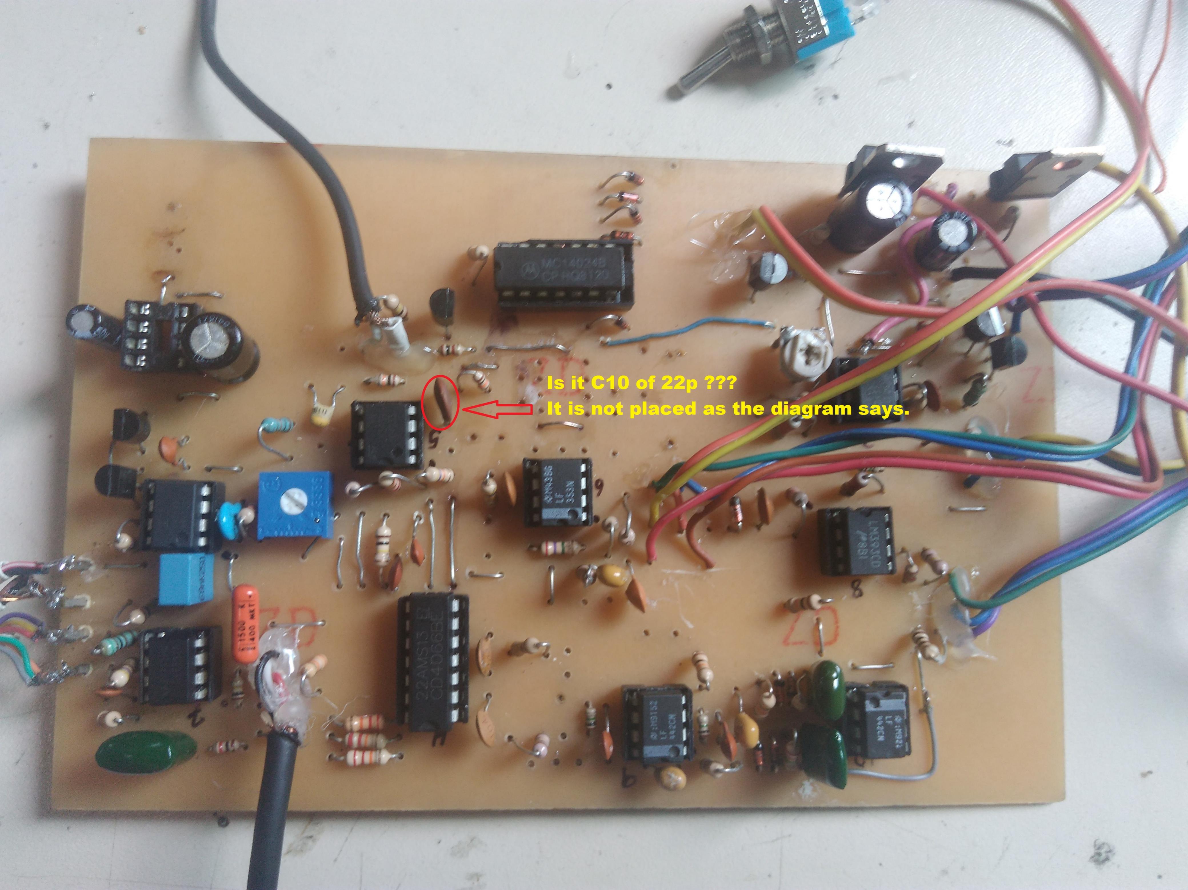

              Hi Andre, I am making a PCB in SPRINT and I have found some points that are not according to the diagram you have published. Here I send you some photos.
              I would like you to clarify those points for me. Thank you very much Ruben2000.

                      I found that resistance is not necessary. It was used to positively polarize the transistor base. You can also see that the U5 before was the LF353, now it is LF442. C10 is between pin 3 and pin 1. This went unnoticed.
                      Thanks for your comments!

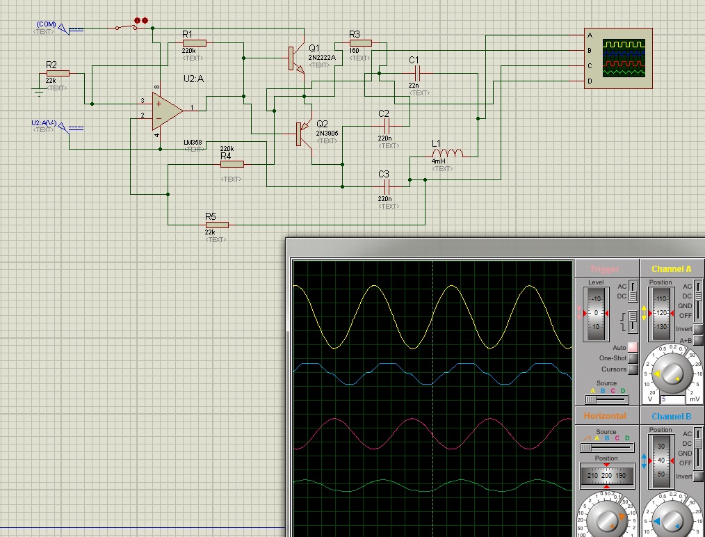

                            Gift -18 kHz oscillator Click image for larger version
Name:	18 khz PP.jpg
                              Originally posted by bgs View Post
                              In order for the IC 7806 and 7906 to work, the difference between the supply and output voltages must be greater than 2 volts. You have 1.4 volts.
                              So, what is you see is a miracle of God!
                              Use 4.2V batteries and be happy!
                                Gift -18 kHz oscillator [ATTACH]54589[/ATTACH]
                                Congratulations for the theoretical complex circuit !
