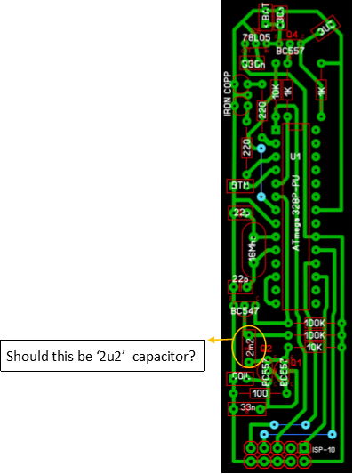

    • Hi Ruben,
      i made little changes on your pcb and add 10 pin ISP interface for quick programing of the microcontroller.
      cheers!
      • @Bai Borko, Nice work on the Layout! Regards, Marty.
        • @Bai Borko, What is the component on the Layout? Is it Resistor or Capacitor? Should it be 2u2 Capacitor? Thanks, Marty.
          • 2u2 Capacitor
            • Thanks Bai, Regards, Marty.

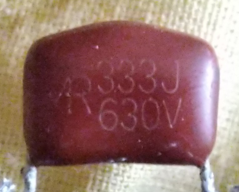

                    • Hi Useus. What type of 33nf capacitor are you using at the moment? Is it a box capacitor or some other? Thanks, Marty.
                        CBB
                        • Thanks Useus. Regards, Marty.
                          • Originally posted by Bai Borko View Post
                            Hi Ruben,
                            cheers!
                            Hello Bai Borko !!
                            Nice design, but take void118's advice into account; that the 33n capacitor should be as close to the coil as possible.
                            • Originally posted by Ruben2000 View Post
                              Hello Bai Borko !!
                              CAT.FM.v1.2.1..rar
                              Hello Ruben,
                              here is the updated version v1.2.1 with void118's recommendations. It can be placed different sizes 33n capacitor.
                              Cheers!
