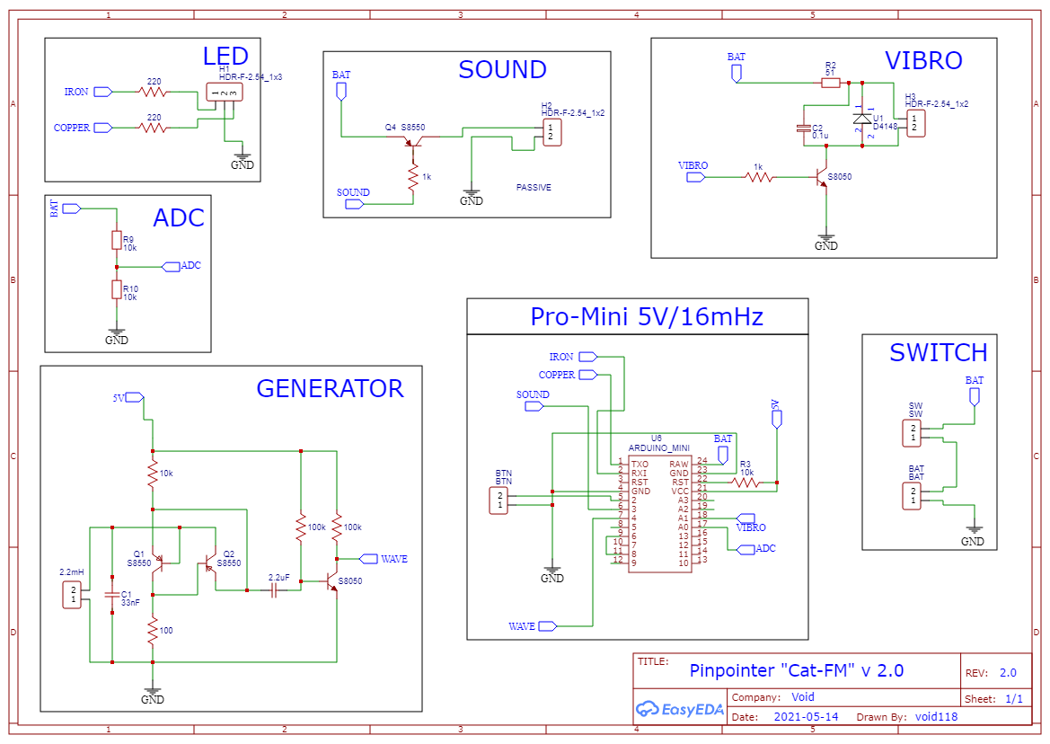

              Marty, I didn't post new version yet but I can show you preliminary version.
              Now I am waiting for PCB from EasyEDA manufactorer.
              • Hi Void118. It looks good! I am looking forward to seeing the new Revision on your you tube channel when you have assembled and tested it. I like the addition of the Vibro motor. Thanks for a great project! Regards, Marty.
                  Ok Marty, It will be two options, vibro motor option and battery(6F22) life checking, I think device will be tell user when battery discharged and I will add new modes, sound alarm, LED + vibro, Led + sound, only vibro and all together.

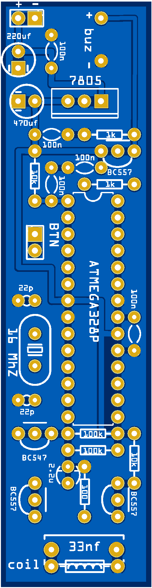

                  • this is my pcb design, i didn't use ADC, leds and vibro by choice. the pcb is 23x90mm
                    power supply circuit in the upper part of the pcb, everything else in the lower part.
                    both sides gnd fill

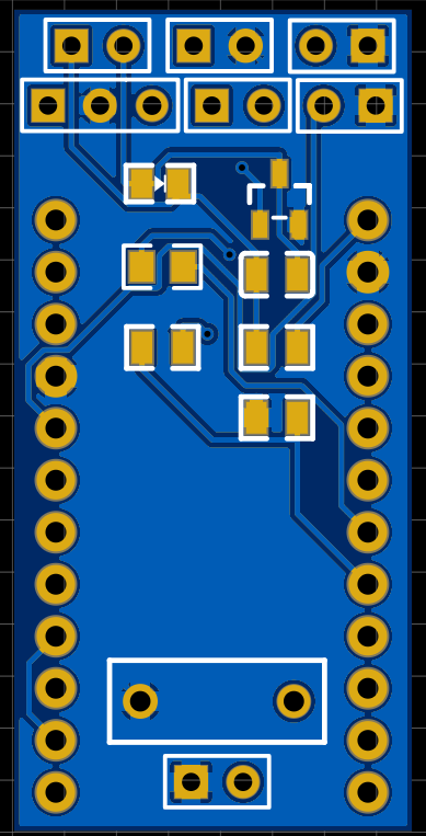

                    • Originally posted by useus View Post
                      both sides gnd fill
                      [ATTACH]55334[/ATTACH]
                      My design, according to schematic preliminary, size 19.4x41.1mm

                          here is my pcb, I still have to test it, it will arrive in two weeks I think
                          remember
                          no battery charge status
                          no leds
                          no vibro
                          +5V buzzer (PAC-1205 or equivalent)
                          for Voltage regulator i use AN78N05 but you can use 7805CV or any TO-220 (100ma min) regulators, if you use 78l05 (TO-92) remember that in and out are reversed
                          cat.rar
