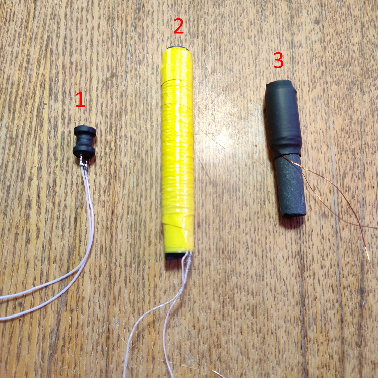

            Are the 0.33uf electrolytic capacitors? And can I use copper enamelled wire for the coil? I only have 0.18mm and 0.25mm copper enamelled wire. Thanks, Marty.
                  If you mean L7805 IC capacitors It's ceramic one's, but please note that Is very urgent to use polyester or polypropylene capacitor In the coil circuit, I mean 33nF capacitor. Yes, you can use booth wires In this project but 0.25 will a little bit simple In coil making process. Another thing I can say, you can Increase the sensitivity If you will make the coil on the last quarter of the rod. For example you have 100mm rod and you making the coil on the one side with 25mm length but with more layers. The maing thing to ahieve Is 2-3mH coil Inductance and you can youse simple LS meter to test It. I've placed an appropriate link under my video.

                              In addition a little bit about my coils
                              1. Choke "3R3" coil, enameled wire 0.1 mm, Inductance 2.2mH, sensitivity about 35mm for one Euro
                              2. Ferrite rod 80x10mm, 2 layers of 70 turns, litz wire 10x0.1, Inductance 2.4mH, sensitivity about 55mm for one Euro
                              3. Unknown Ferrite rod from aliexpress 50x10mm, 4 layers on half rod, enameled wire 0.3mm, Inductance 2.9mH, sensitivity about 50mm for one Euro
                                Thanks for the extra coil data and results Void188. Regards, Marty.
