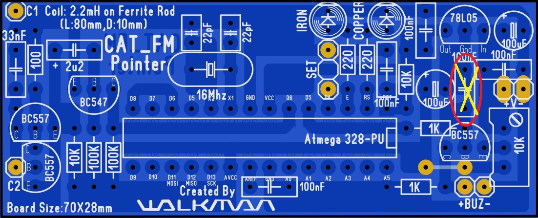

        Hi friend,
        Can you add thick sound for iron and thin sound for copper. Different sound will be better.

            Sorry I didn't watch this video. I controlling my pcb
            • Originally posted by walkman View Post
              I think the problem Is In your buzzer...
                  You are right. I solved the problem. Installation should not be done
                  • Hiya Walkman. I built your pcb and mine would not work either. Do I just remove the 100NF capacitor or is there something else I must do? Thank, Marty.

                        • Hi Void118. I built your version, the first one, it works fine! I just need to make a 2.2mH coil because the first one I made was 2.9mH and it behaves unstable. Thanks, Regards, Marty.
                            the polarity of 2.2uf is reversed in this scheme, 100 nf seems to be connected wrong, it must be connected between pin snd and 1k, not between 1k and bc557
                            this way I assure you it works. however it works even without it, it's an extra to stabilize the circuit
                              Hi, look, the frequency must be between 20-25 kHz, If we will calculate your value we will see that you have ~ 16.3 kHz, you can calculate It by yourself , try to decrease capacitor and may be your coil will work fine.
                                It Is mistake, 2.2uF plus must be connected to emmiter, so this Is right connection
