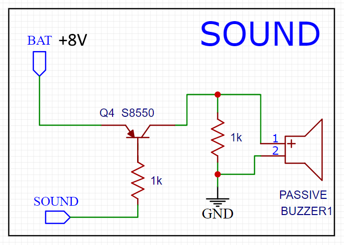

    • Hi friends, It's very strange for me, I'm using this one buzzer https://aliexpress.ru/item/32817425949.html
      and It Is very loud.

            Piezo buzzer can work with 12V PWM without problem and resistor connected In parallel to buzzer Is because the buzzer you can think as capacitor.

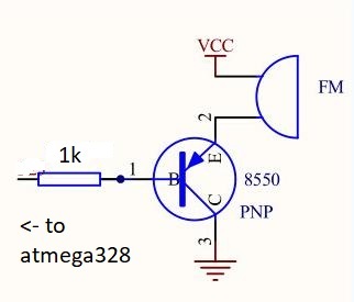

              • Originally posted by void118 View Post
                Sound example, Listen to It please.
                https://youtu.be/dMosKW4c_Pk
                connected like this sounds as loud as yours but transistor gets very hot. if I put resistance in parallel the volume goes down

                • Originally posted by useus View Post
                  [ATTACH]55218[/ATTACH]

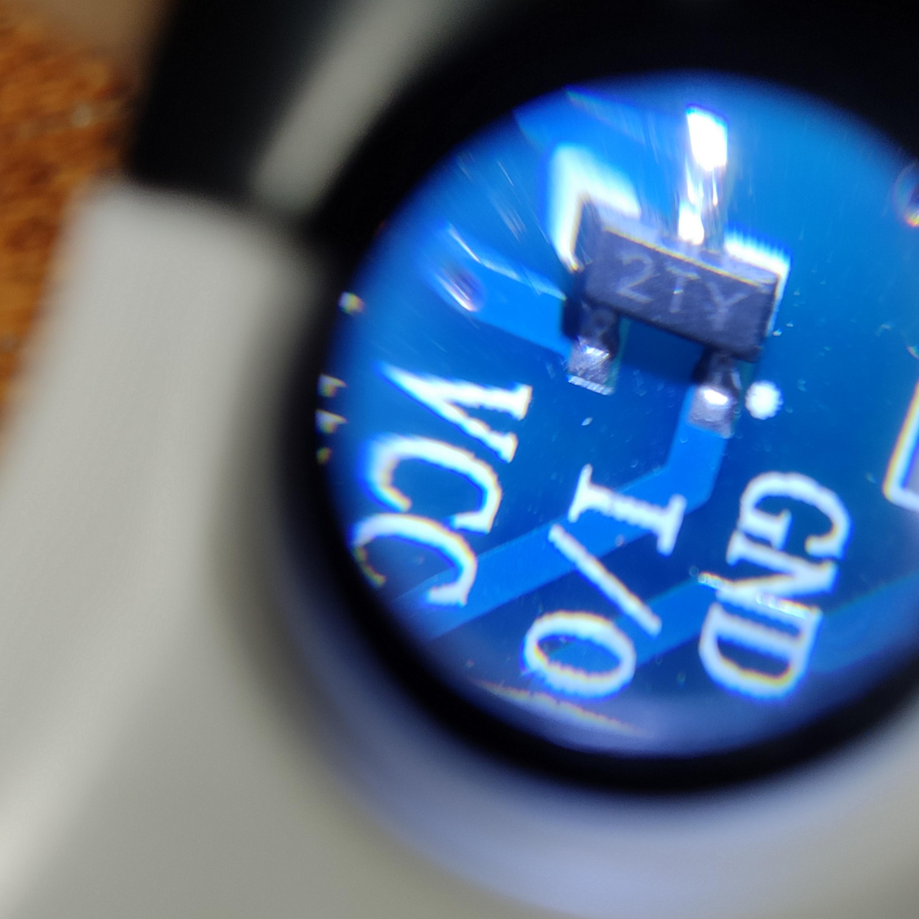

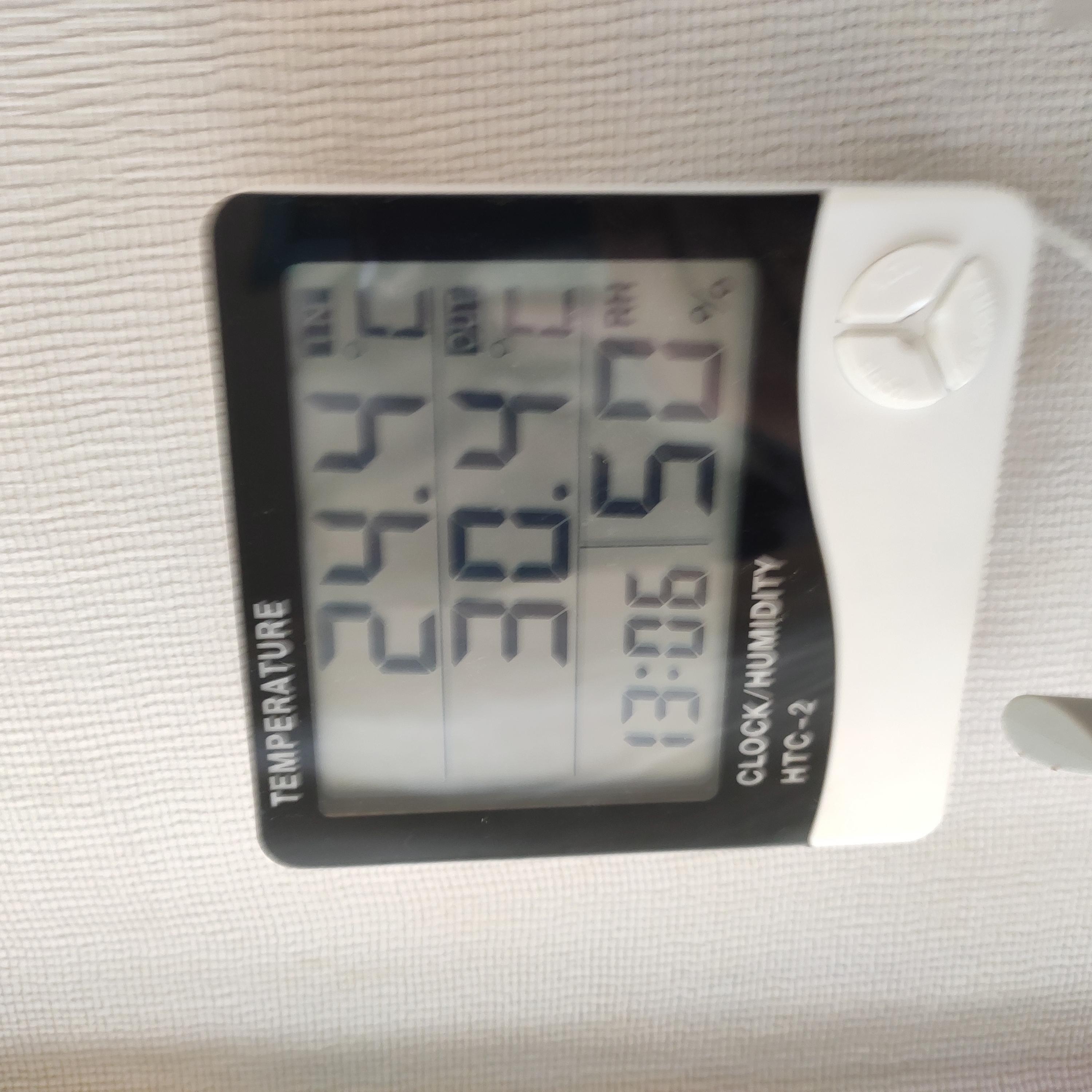

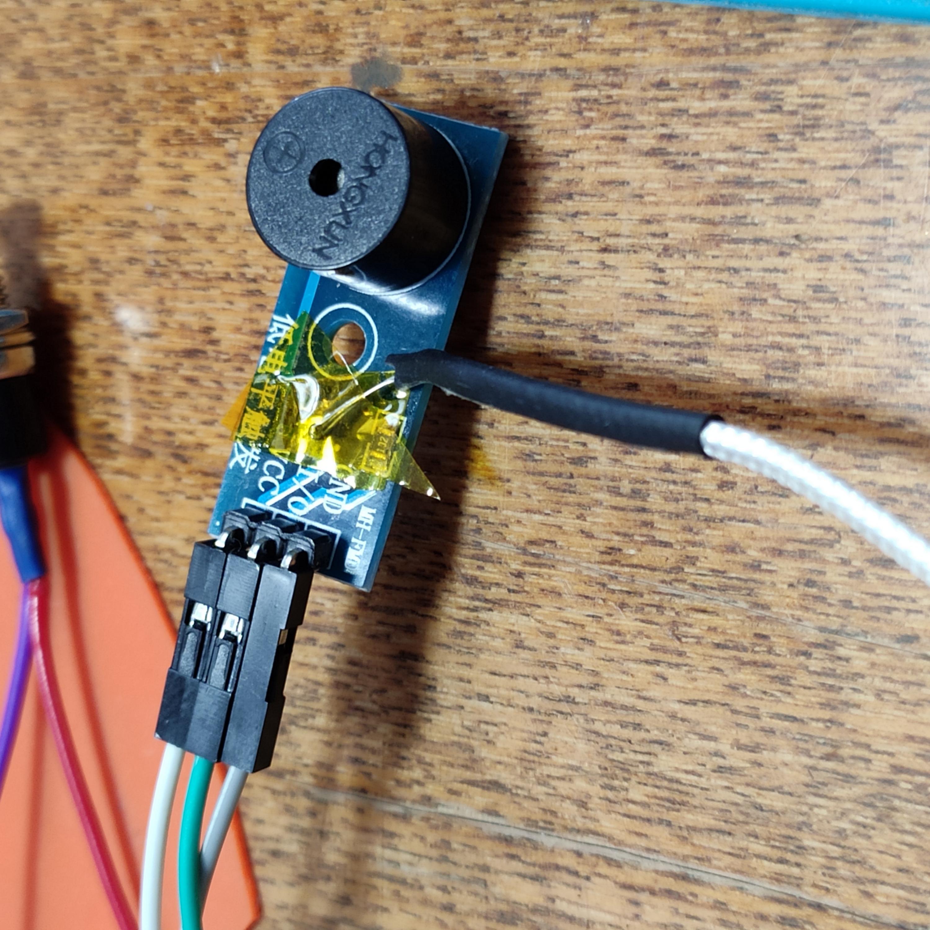

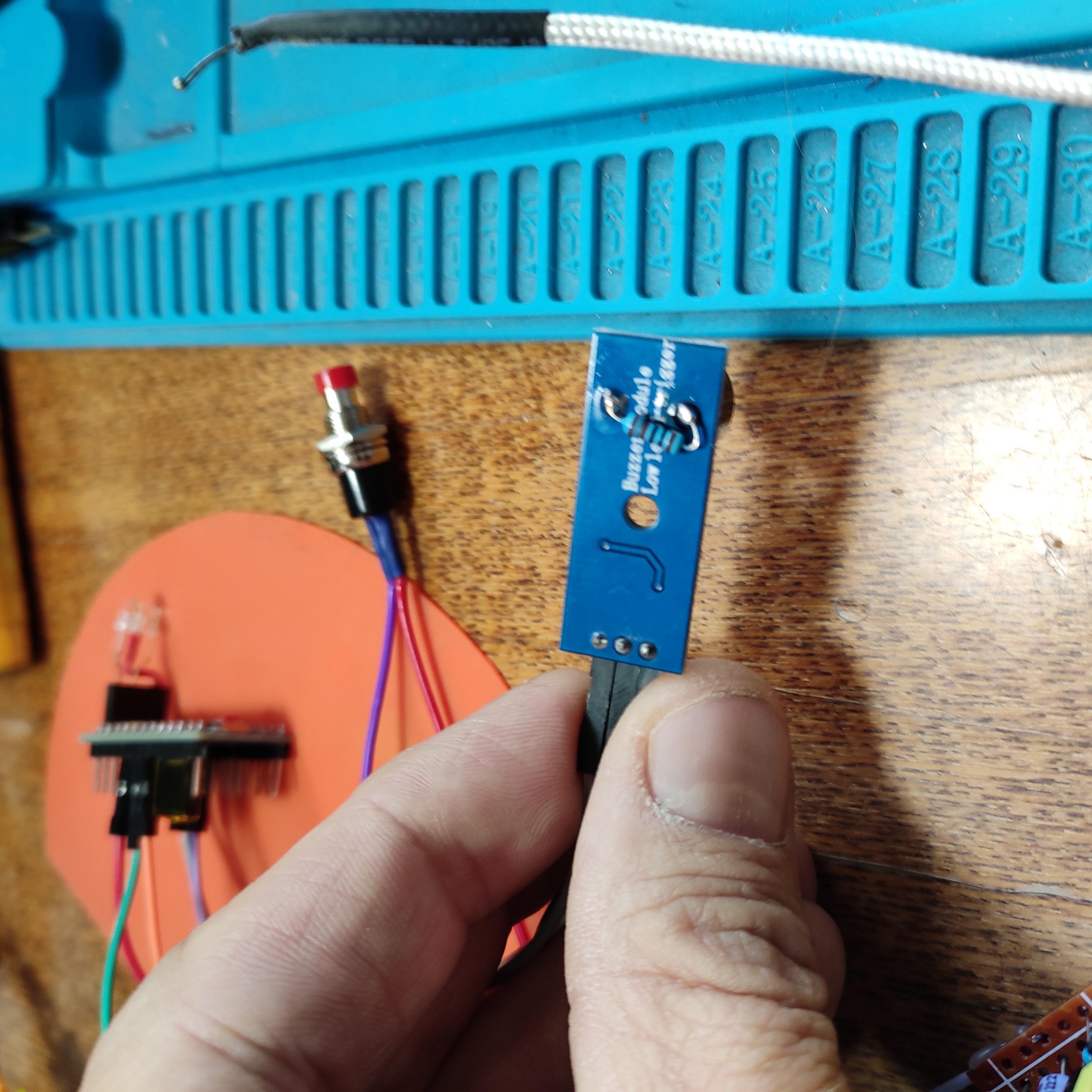

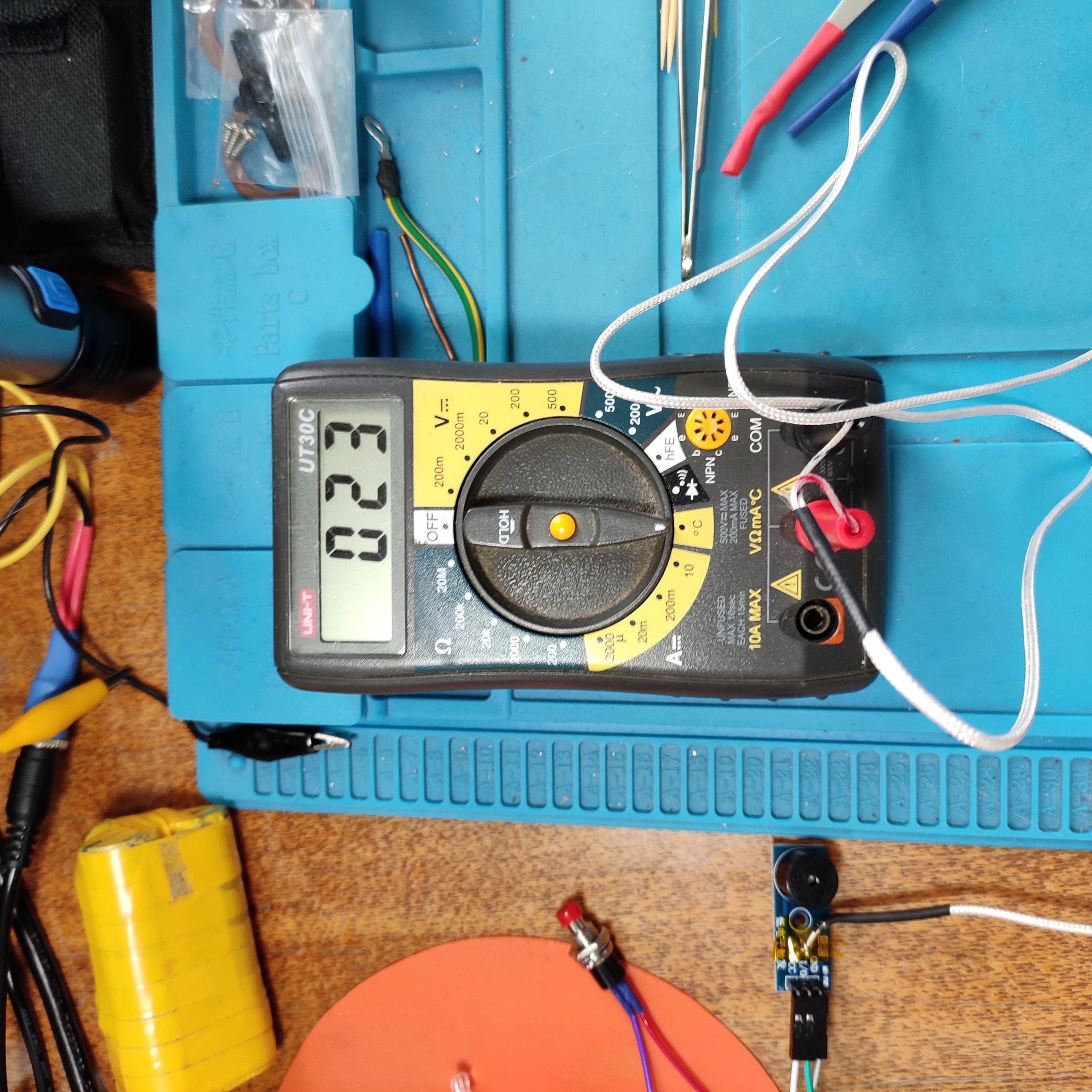

                  It' Incredible friend, special for you), please look:
                  1K resistor In parallel, K-type thermal pare, 2TY transistor = S8550, ambient temperature, transistor temperature....
                    Connect your buzzer Into collector net please)
                        does not change the situation, low volume, however, the transistor does not heat up

                          Ok, check please that you are using PNP transistor, then check PORTD.3 please, there Is must be "logic 1" In silent mode, It means that transistor Is closed and there Is no current flow, check current In your sound net In silent mode, check temperature, make few photos please, It's very strange. I can't understand how transistor can be hot when It's closed?
                            with your scheme the transistor does not heat up, the scheme I loaded before was to make you understand that the buzzer sounds loud in that way.
                            PD3 is ok
                            tried more transistors S8550 bc557 2n3906 bc327
                                i don't understand how you connected it, gnd ok, i/o ok, while vcc and the soldered wire?
                                Like this:

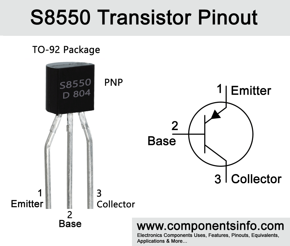

                                Check collector and emiter of your transistor please, and show me your pcb design please....
