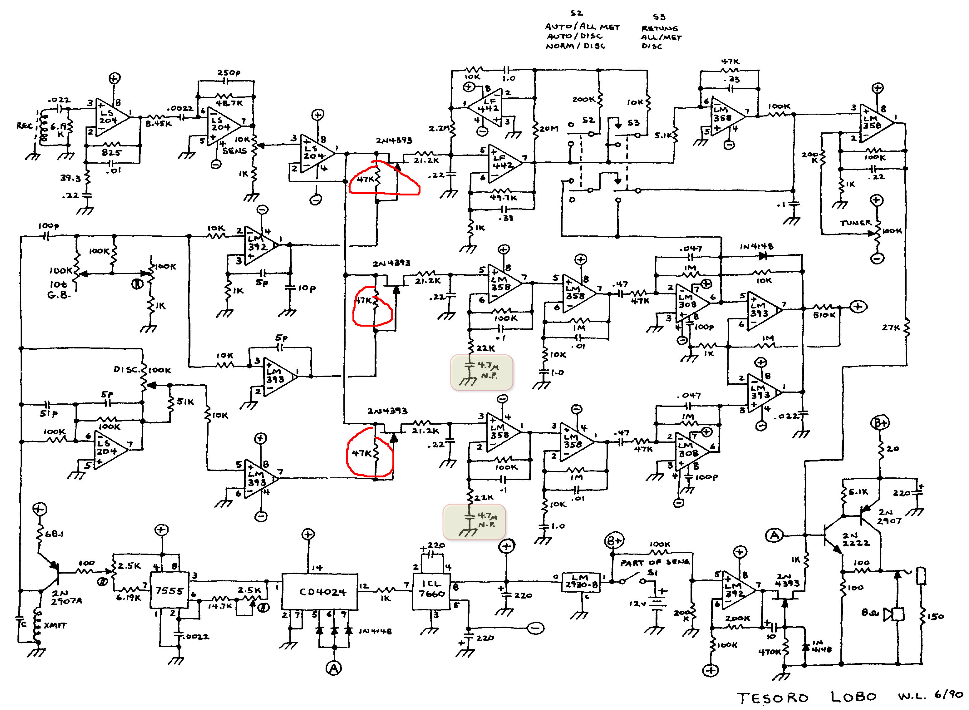

    I have noticed that some have run LOBO with these changes.
      What will be the right thing to do?
      10-100pF
        10-100pF

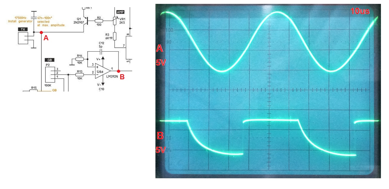

        Thanks KT for the help !!!
          Will the waveforms be okay?
            how i see this sch... you have to get CLEAR symmetric signal on output of 555... to get then sinusoidal voltage
            on the coil without a distortion and harmonics...
            we call sometimes this signal "meander"... in last redaction, TROY SHADOW X5 i mean,
            the author input a trigger after 555... it gives sure clear meander.
            try to tune now...
                  try to tune now...
                  Hi KT,
                  You mean there must be a 50% high and 50% low signal at the output of the 555 and no interference?

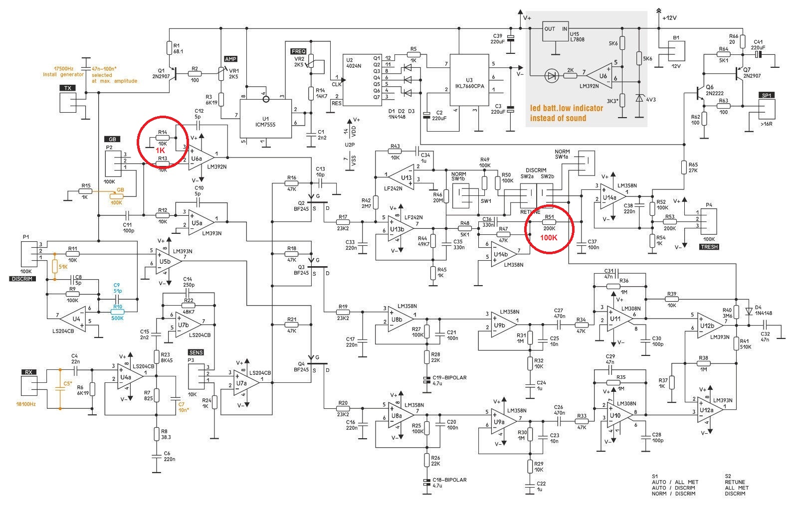

                      i think connections of those resistors are mistake.
                      • #41
                        Probably not, they bootstrap the on/off logic levels to the analog signal.

                          I am working on this detector my self still at the setting up stage works great so far, I need to try with the resonant receive coil with 600hz spacing between transmit and receive coil for correct phasing.
                          • #43
                            Hello friends I am wondering why leave this 600Hz spacing between TX and RX? Why can't they be at the same frequency?
                            • #44
                              Hello dom44.
                              Are you running it at 17500Hz and 18100Hz?
                              What capacitor do you use in C7?
                              • #45
                                i set mine up for exactly 20khz on the transmit coil so will set the receive coil for 20.6khz i wound my own coils so was easy, I have 1.43mh on the Tx and 9.68mh on the Rx and i have 47n cap on Tx
                                I am starting with 10n on C7 as i said i have not finished with the final setup but so far has exhalant sensitivity with an un tuned receive coil. there is an LT spice simulation some one posted here a few years back on the lobo front end so you can play with part values.
