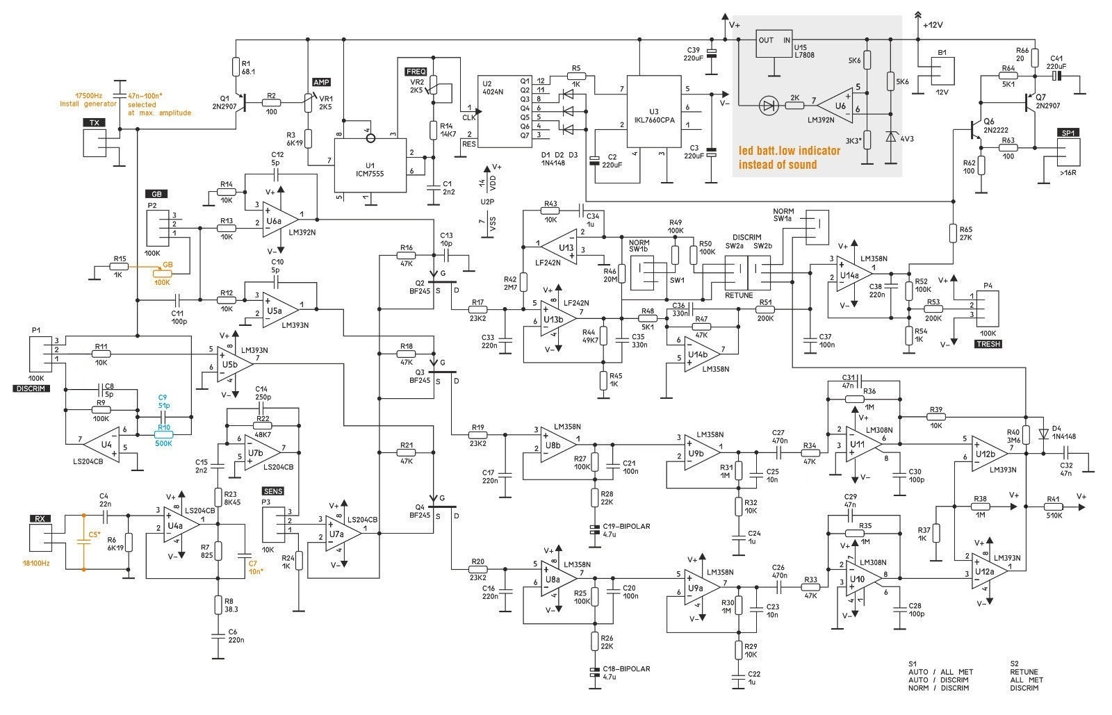

          • Thank you for your kindness and help. For now I can tell you that if you look at the photo of the PCB I assembled, you will see that it is the Russian version that is sold on Ebay. Multiple diagrams are shown in the same sales announcement. The one in the diagram does not correspond 100% to the board, the commutations are reversed and the coil does not match reality. At least that's my conclusion. The TX coil has too many turns and in addition to giving too high an inductance, the resistance does not correspond to the logic of removing turns, but it is inverse. The next thing I will do is remove coils, the 80 they indicate is an exaggeration, other sites speak of about 60 and I, using the shape of the TGSL coil, I think it will go through 40 turns, for an approximate inductance of 2mh. If I clarify all this, I will post everything.
            I honestly do not understand why they have complicated this project so much.

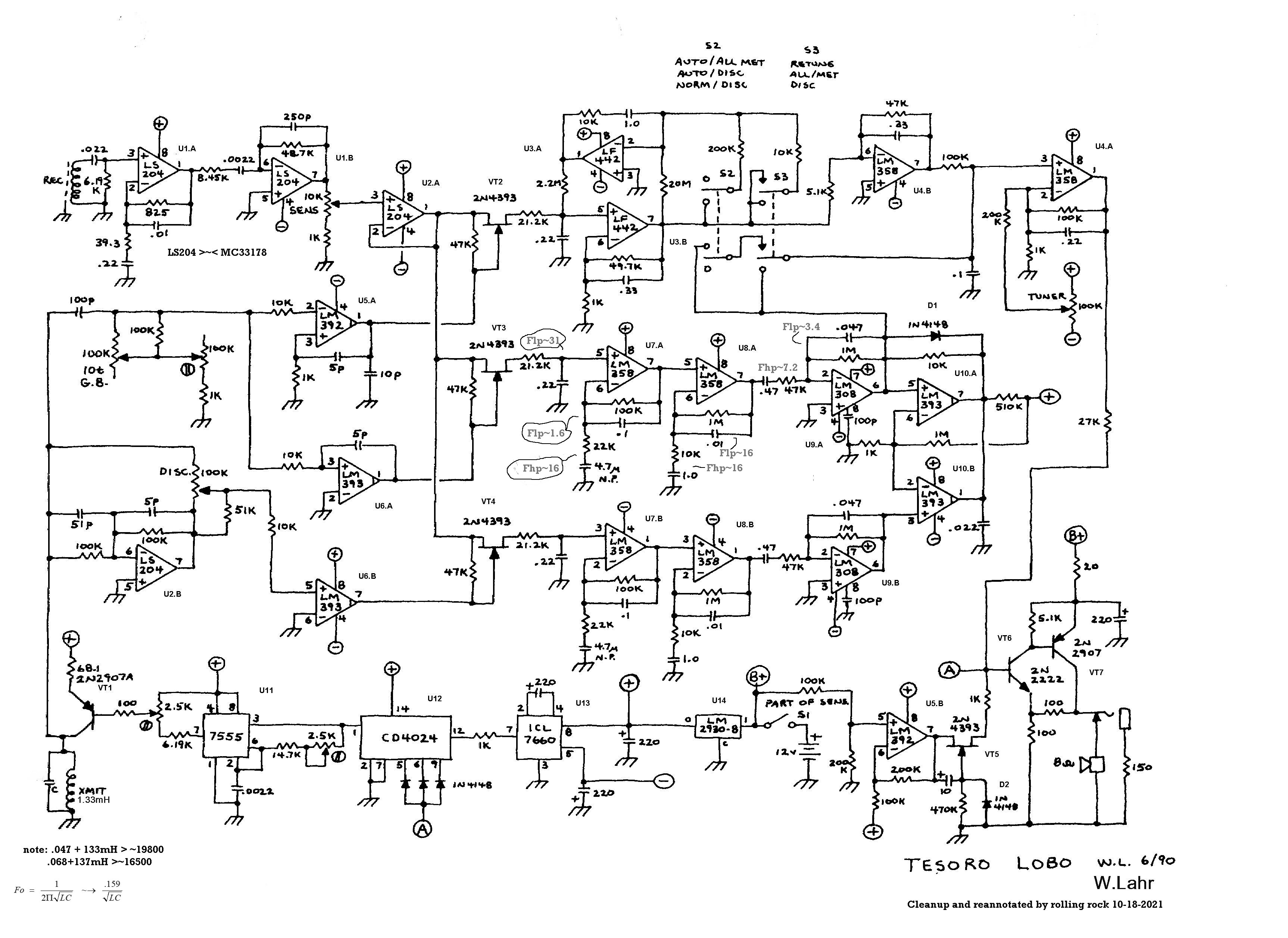

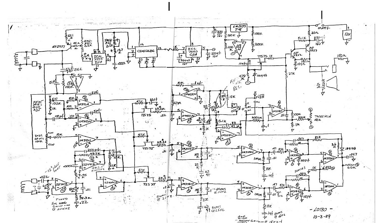

            • Here is a cleanup of the original Lahr schematic that I did so long ago that I wasn't even sure it was my work when I first stumbled across it today.
              Also here is the original Lahr drawing with no (no?) changes or additions,
              and here is the Diablo 2 schematic. Notice the similarities?
              Diablo 2 had an arrangement so the user could flick a switch and reduce the gain, so as to not overload. The RC time constants at amplifier B set up a slightly leading rx phase as gain setting was lowered. I do not know if that was accidental or deliberate.

                I was leaning strongly towards the LOBO but I like to understand a circuit before I attempt to duplicate it, not after, and LOBO leaves too many questions. Golden (also Royal, Euro) Sabre or Eldorado could be my destination.
                Look at my notes in the "cleanup" post above. Do those numbers attached to the second and third filters make any sense? The answer is NO. I would change the second filter high-pass section to 1.6Hz to maintain sanity, but that still leaves the 3rd filter sections looking like a notch instead of band-pass and I lose my sanity again when I try to understand that. Therefore, ()Sabre, or Eldorado is my destiny. Simple. Elegant. SANE.
                Lobo defies understanding, imho.
                • I believe that, right or wrong, Lahr's diagram is the wellspring from which all LOBO clones springeth...
                  • I agree with you, as even the PCB I have from Russia looks very similar. I would say that the only noticeable difference, other than the 10pf capacitor between pins 1 and 2 of the first RX preamp "thing I haven't experimented with much yet", is that the Russian design has a low battery optical warning, instead acoustic and this is irrelevant to the proper functioning of the detector. The issue of filters because I do not know exactly what it refers to, I mean if it is a design error or a transcription error when copying it, or simply in the fact itself of its characteristics. In practice, this doesn't seem to give me a problem.
                    By the way, in this cleaning of the scheme, the commutation is still wrong, actually it is not wrong, but it is wrongly marked. The S2 "Auto / All Metal, etc." switches. They are backwards.

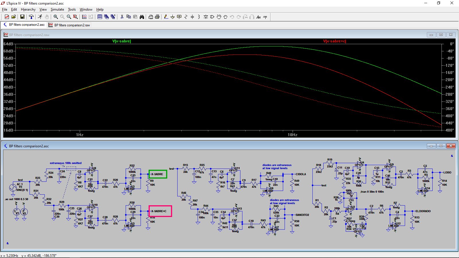

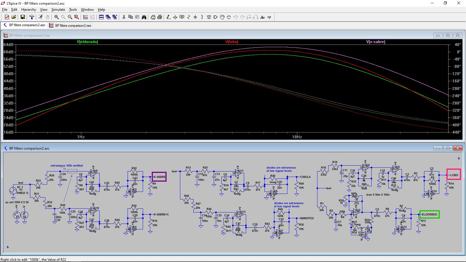

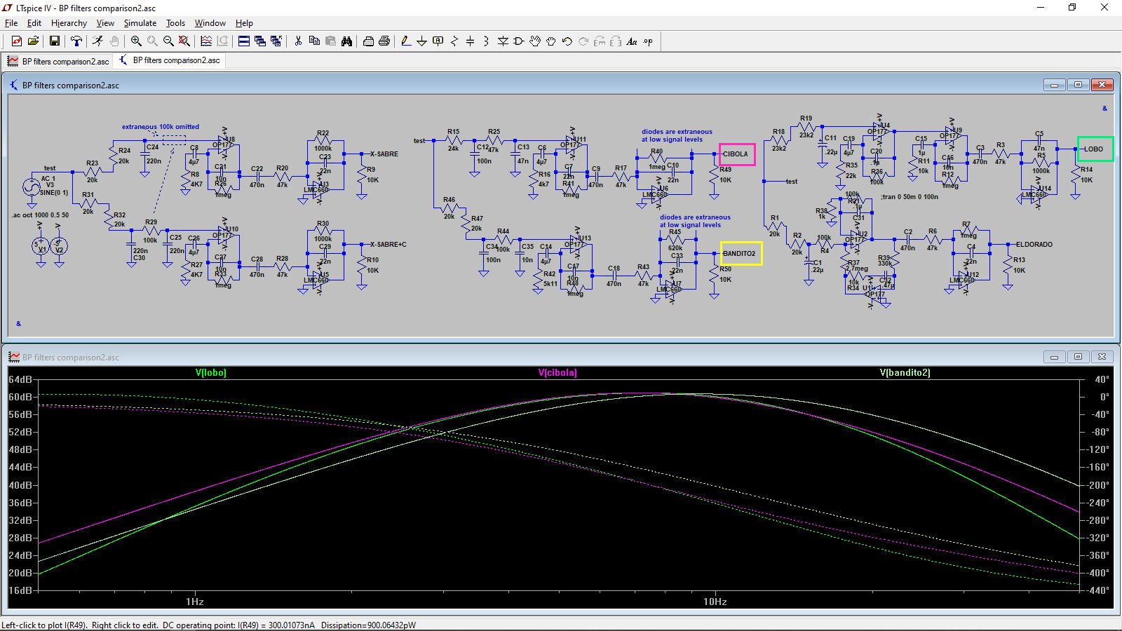

                        I finally got around to running a proper AC analysis on the DC filter sections of various Tesoro detectors. Lobo has three sections, also I think Eldorado might be considered three filters? All the others have two. I know nobody asked for this but I want to take back any reservations I may have had. After seeing these I have to admire their work.
                        You won't have anything like this on your oscilloscope but you can clearly see the pass-bands being roughly dome shaped. Frequency is swept 0.5~50Hz.
                        Ooh I highly recommend LTspice for all you budding engineers and wannabes.
                        One last thing - I added a second 220nF capacitor the the X-Sabre at the amplifier input pins because something was probably there in the original design, otherwise the 100k resistor can be removed because it does nothing. It's in series with 100GΩ input resistance, or something like that.
                        Most of the Tesoro designs use a half-wave demodulator, so I think it's appropriate to count the resistor on the front side of the switch 2x. Cibola has a FW demodulator where each half gets counted half the time.
                        Sorry, I'm not trying to hijack this thread, it's still about Lobo (and such).

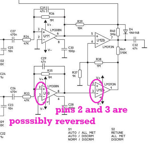

                          • Ruben 2000, look at this picture. On these particular op-amps and comparators the -input goes to pin-2, +input goes to pin-3. It's probably OK, but you should check your PCB layout to make sure there was no mixup.
                            probably just a mistake on the drawing

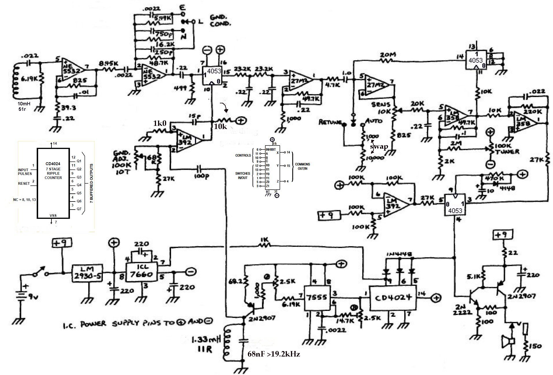

                              My PCB is made according to this scheme. There are many schemes where the pins and polarity are reversed. If there is any error in the scheme please let me know. Thank you very much rolling rock !!Click image for larger version
                              • Originally posted by rolling rock View Post
                                [ATTACH]56323[/ATTACH]
                                According to what I see, only pins 2 and 3 of U11 are inverted from the diagram you published. The rest are fine, no matter the polarity, the important thing is the uvication of the pins. In my diagram only U12A the polarity of pins 2 and 3 are reversed but that has nothing to do with it. Any detail to improve the scheme will be welcome !!!
