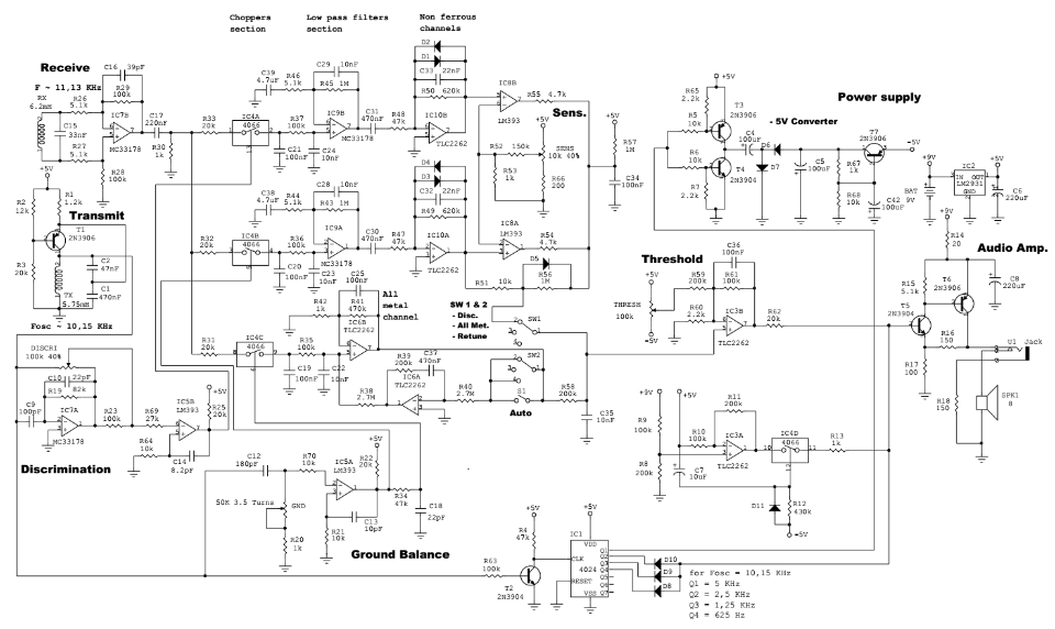

    The printed circuit board is verified. I did not manage to achieve more than 5-7 cm per coin, but it was a problem in a thick wire(twice as thick). Discrimination works. The board is fully tested and working. It was drawn for commerce, but I decided to draw the campadre for commerce. Added a volume knob. All regulators are displayed only on the board on the reverse side. Feel free to repeat it. Thanks for attention. I am from Russia(Crimea)

          It could be interesting a bill of components and the serigraphy of them in the PCB
          Is it possible?

            when you hover over the elements, their nominal value is shown
              Here is the sine on TH.Unfortunately, the counter 4024 died (there is no generation of the meander), although everything worked before that. Perhaps the problem was in the faulty 4024 initially. In addition, I initially confused the polarity when I first turned on. And the meter is powered directly from the stabilizer.

                    Not all items are displayed. You need to look for elements in the links of the scheme!
                      I apologize. only the stabilizer 2931 and diodes are not displayed. All diodes are 1N4148(9). On the diagram, the symbols are arrows (from the anode to the cathode, respectively)

                            I forgot to write why I had only 5 cm per coin, then when parsing, it turned out that the denominations did not match, the problem was an excess of phosphoric acid, all the details were saturated with this acid, and lost their denominations.Sincerely.
