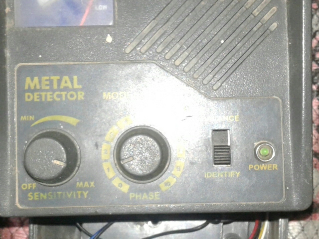

    The picture of the device is in the attachments

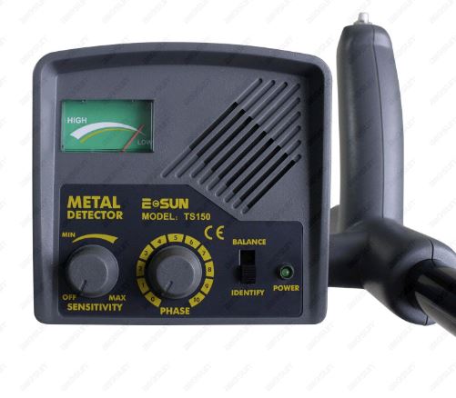

    Looking at the controls of the device, we can conclude that it is a pulse detector.
      It appears to be a very basic VLF.
      ALL SUN or ALL O SUN or Zennox TS150:
      https://www.amazon.co.uk/all-sun-Gro.../dp/B013JGF06K
      No doubt sharing it's innards with many other Chinese machines.

ID:	362017This is the actual picture of the device
          actual picture of inside atmosphere is needed. i do NOT think it is PI. i noticed chineses very love VLFs with true static mode.

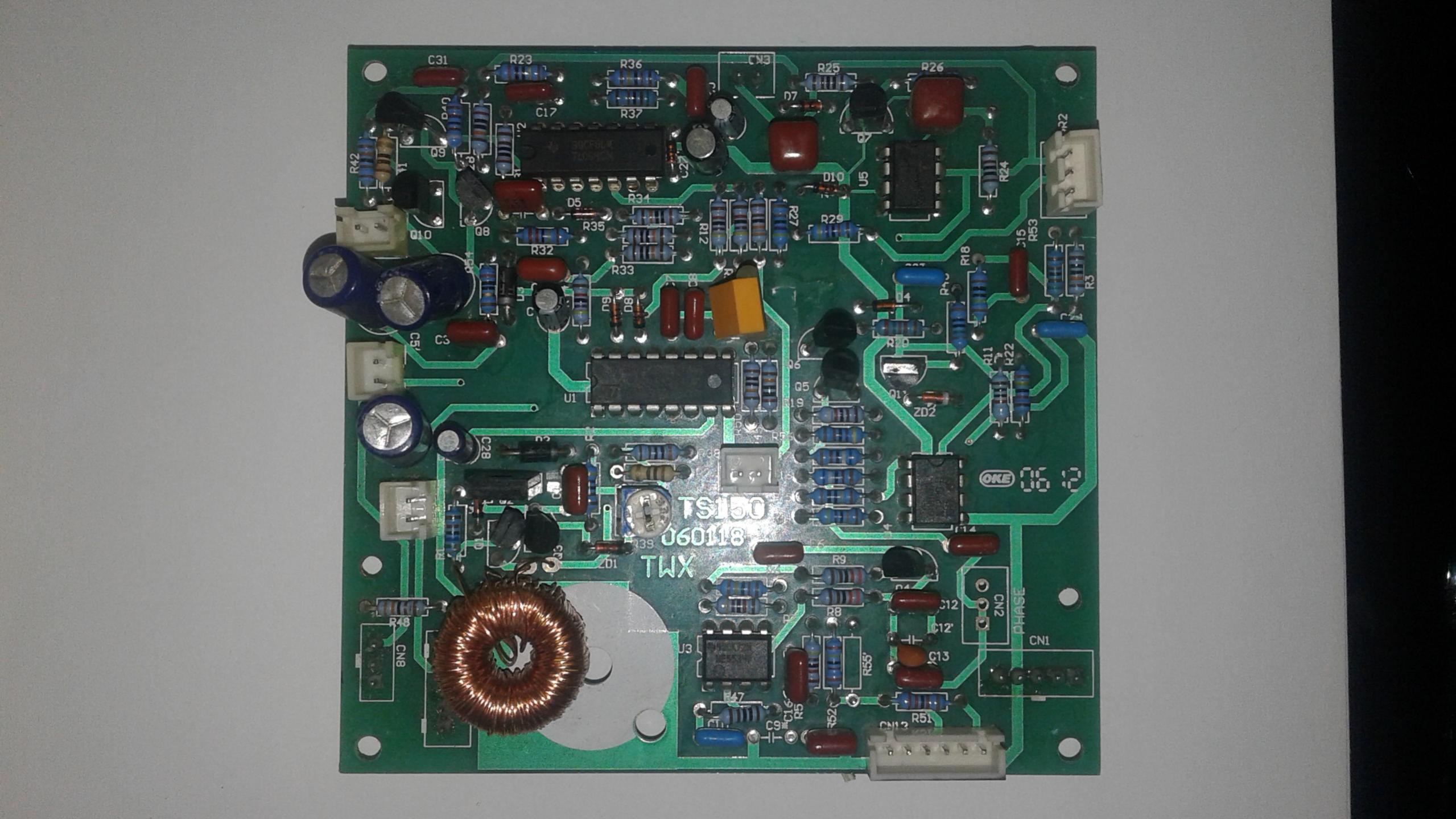

            this is the assembled board

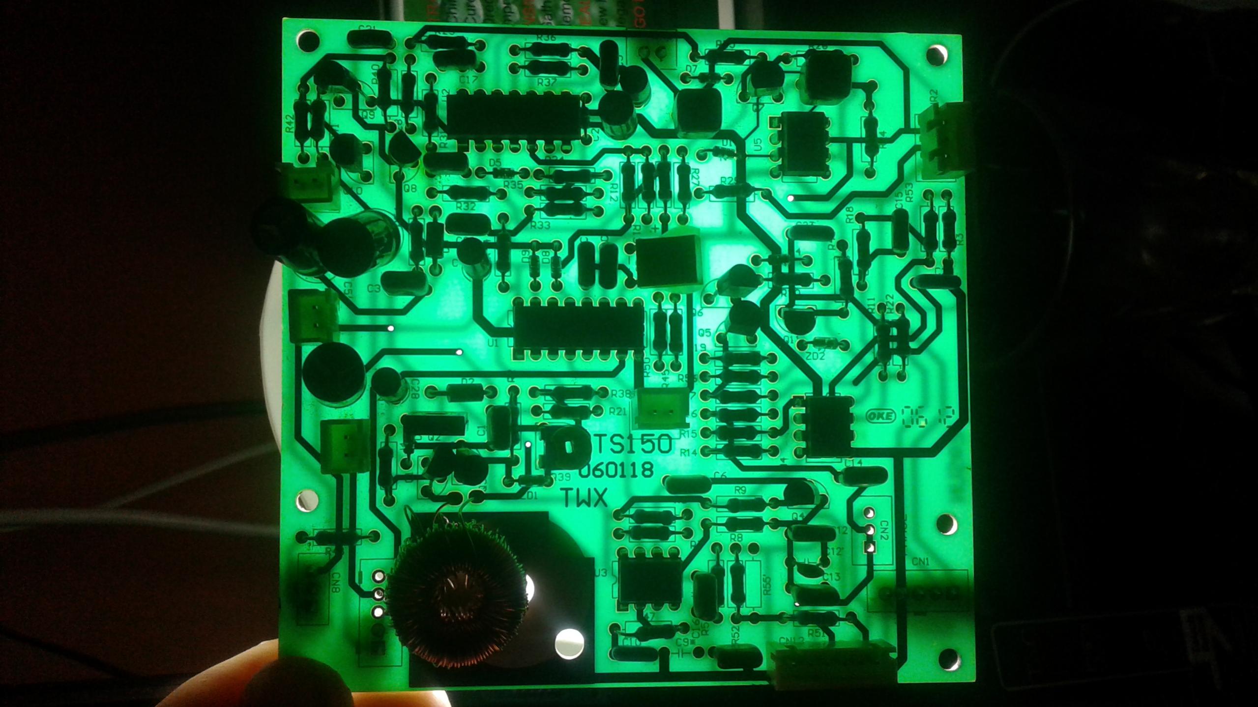

              thank you. try to do the pics under sun light, on open air. choice the good sunny day. Florida, Sun Beach, Africa, Indostan and Pakistan. SUN IS BEST!
              Lithuania is dark state, clouds, no sun, the depression country.
              ok. i see clear VLF det. try to do PART LIST with the micros.
                The big toroid is unusual. Part of the transmit circuit? , like the double-tuned Fisher F75 and some Troy machine (designed by Fisher). Two caps, and two inductors, one being the TX coil.

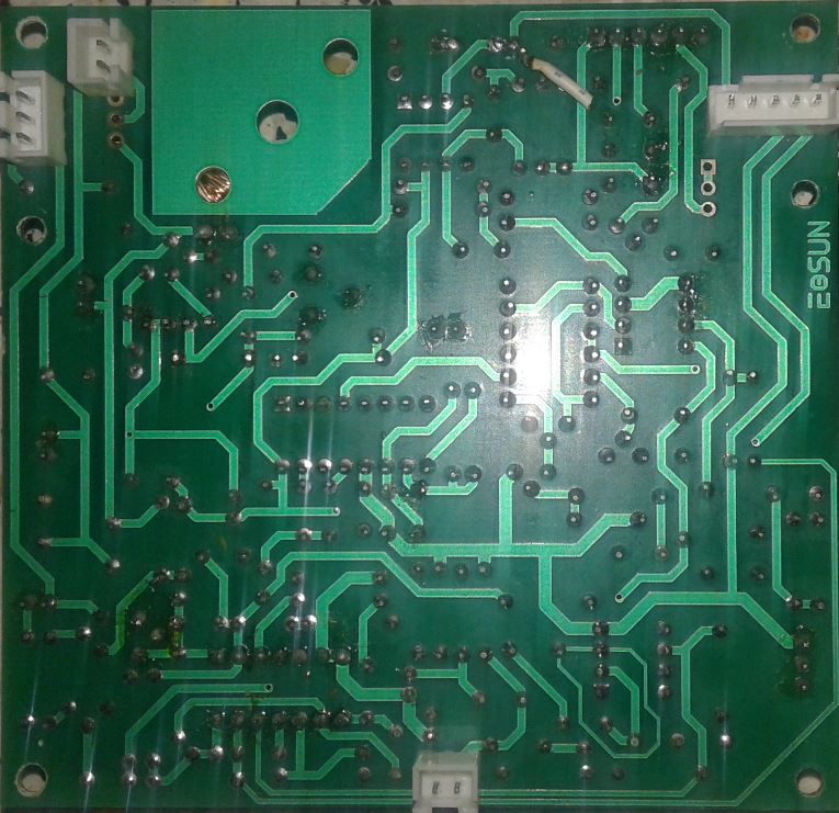

                  This is a picture of the second side. I hope members participate in the topic and attach the schematic of this device.Click image for larger version
ID:	362020Click image for larger version
                    It's very unlikely anyone will have the schematic diagram for this machine. Tell us why you want it. Are you trying to repair a non-working machine ? Are you wanting to improve its performance? Are you wanting to find a coil that's compatible with it ?

                        The pictures were taken earlier and I don't have the device now.
                          I finished drawing the PCB on both sides.
