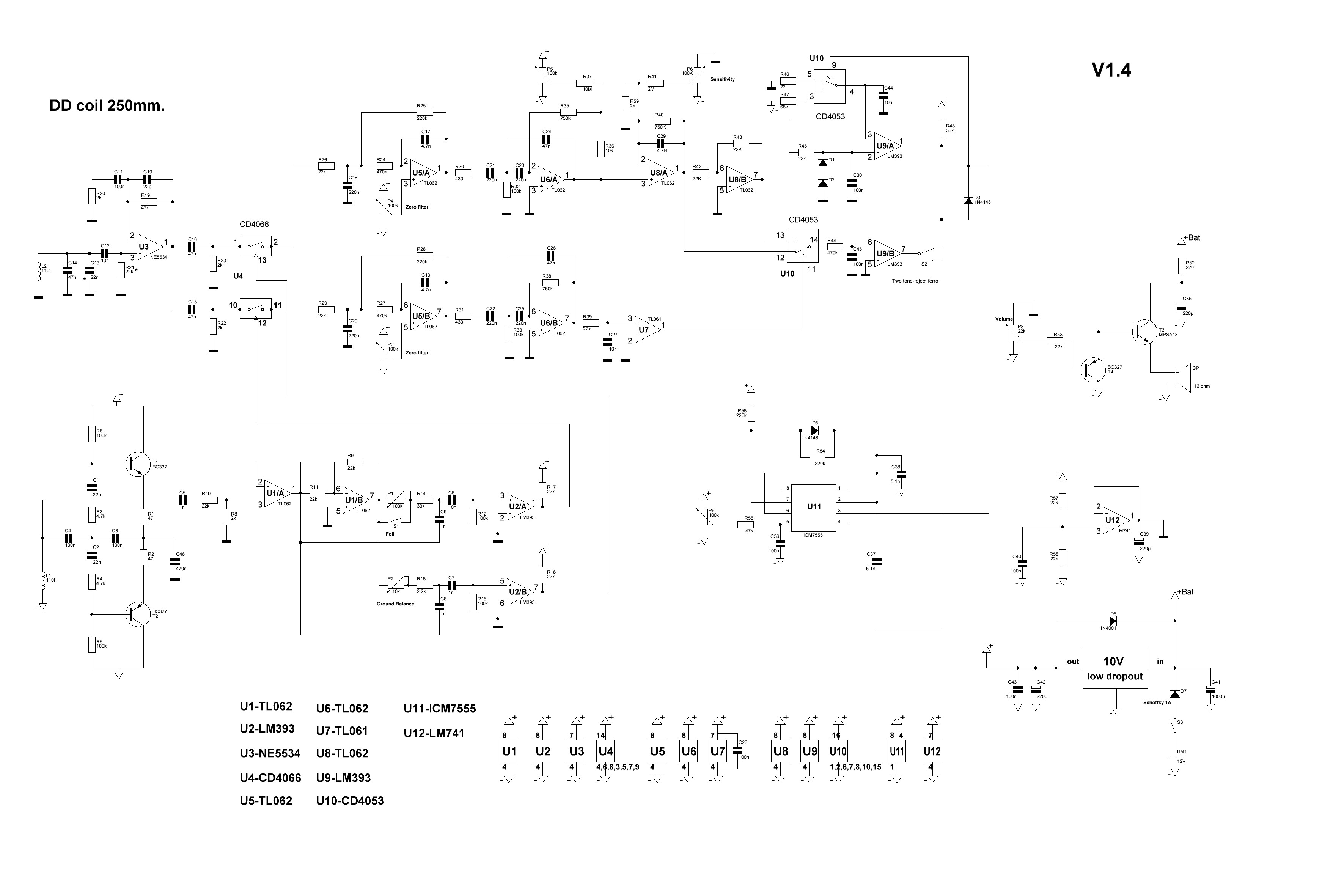

    Latest version
    Added label for two-tone ferro switch.
    ICM7555.
    coil details
    Great work. Thank you. Saved me a few hours redrawing the circuit. How about creating the gerbers now?
    • #47
      [QUOTE=Artyom;293497]
      Latest version
      the upper output of the volume control is connected incorrectly
      Thank you Artyom.
      Volume control pot corrected. "volume" added. Sensitivity control pot corrected. "Sensitivity"
      "Zero Filter" added.
      "Ground balance" added.
      CD4053 pin assignment numbers added.

        • #49
          Sent you a PM, if you could clear some confusion please.
          • #50

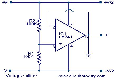

            I only redraw schematic. Question about circuit is better for the one who put it.
            My observation is that it implements a rail splitter circuit by means of a 741 opamp. Such a circuit is used to make a split supply (positive and negative rail voltages) from a single supply.
            The ground seen in the schematic is commonly referred to as a virtual ground and in this case it sits at 0 volts.
            These type of circuits are very well known.
            I google it.

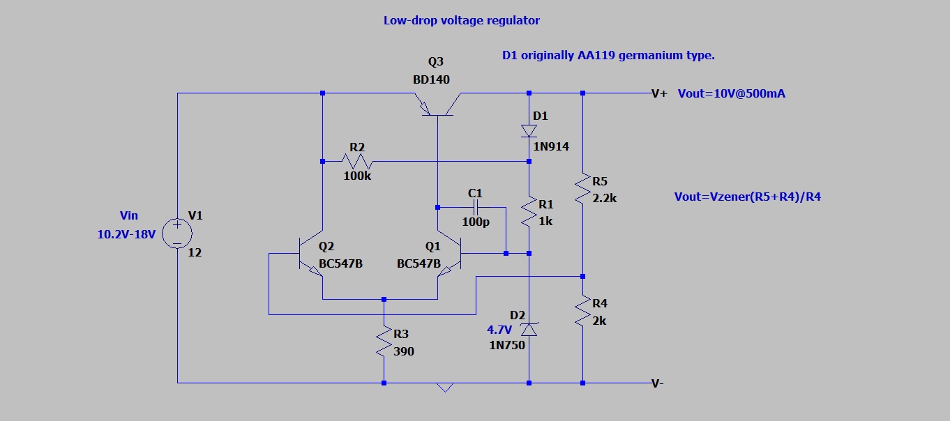

                Low-drop voltage regulator
                  I google it.
                  Thank you for your expert advice. That all makes sense now.
