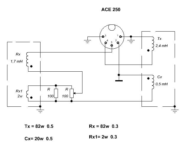

    I picked up this from somewhere, can't recall from where, having it for some time.

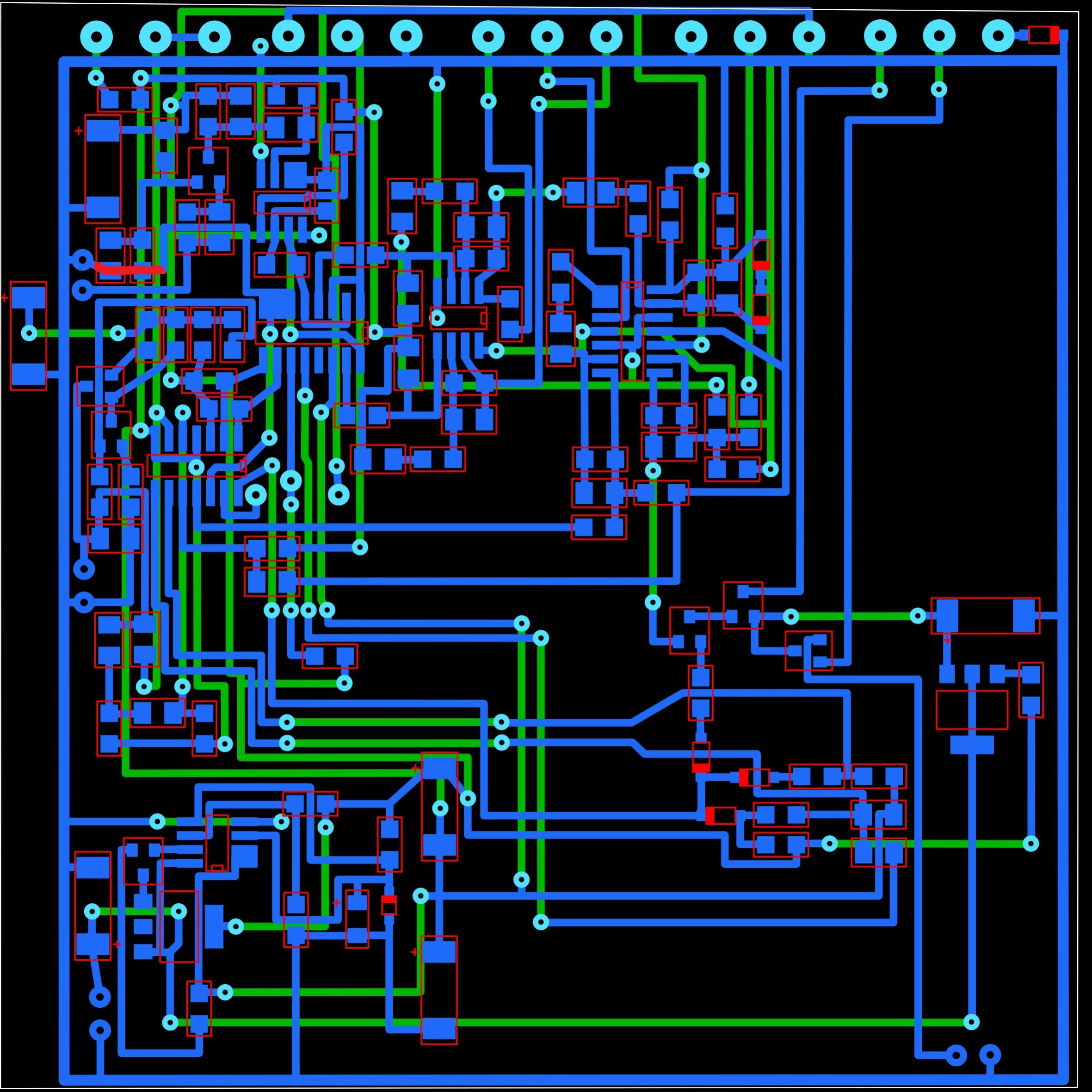

      found an error.in the picture the red line indicates the connection
