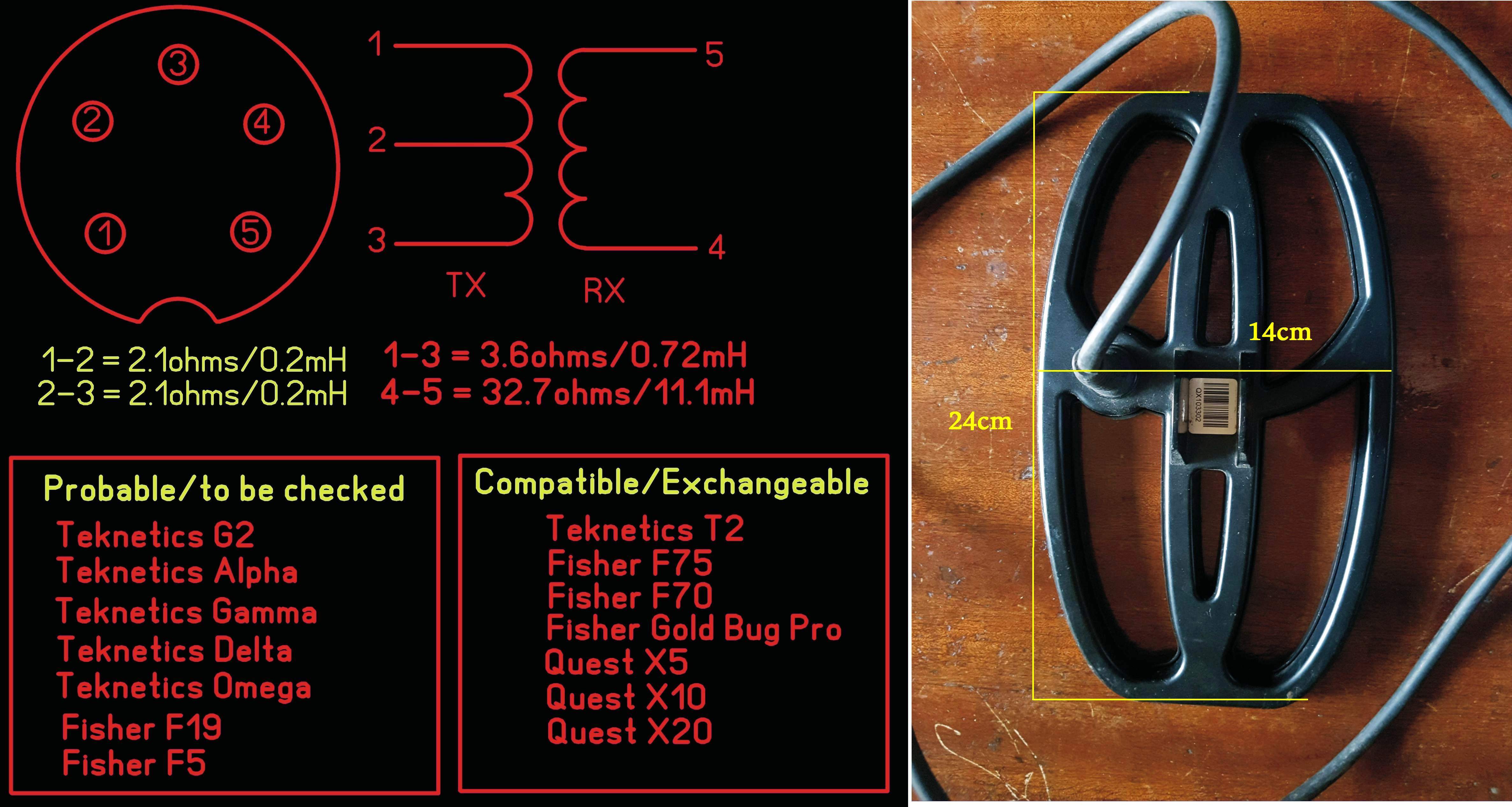

      So; coil for Quest X5 (I will publish specs later), negative voltage generation with 7660 and possibly better audio stage elaboration.
      But any possible suggestions and ideas related to the current situation; is more than welcome.
        Coil for Quest X5, i was talking about, to be good to replace present Tesoro coil:
        Looking at it's specs and also on the list of fully compatible coils that can be used; becomes obvious why I am ready to pick it for this design.
        If we count all the coil models for the detectors from the list; we'll have indeed rich variety of affordable and easy obtainable coils for this detector.
        But!
        TX stage must be changed also!
        An interesting detail is that these coils have a middle point/lead.
        Which is probably connected to ground in most of the mentioned detectors.
        I have never in practice tried so far to make a detector with such a TX.
        And that would be very interesting for me to try.
        There must be a good theory explained and elaborated behind that first.
        I would combine such coil arrangement with direct square output too.
        So...
        Now it is the turn of real experts to appear here who know how to explain it well.
        As if also to trying to design such a good TX output for this purpose.
        C'mon fellas!
        Don't let this forum sink into inactivity!
          Don't be fooled by such small dimensions of this coil!
          On the Quest X5 detector it works "killer" well! And very deep!
          I was so positively surprised at the first few hours of working with the X5 and that coil!
          And who likes larger coils; there is a much larger selection of medium and large coils for detectors from the list, with the same specs.

                              Just a comment on your Quest search-coil:
                              It is clear that the Quest design is very closely copied from the Teknetics T2 machine. This makes sense if you know about the copyright infringement lawsuit between Deteknix and First Texas Products.
                              So the T2 coils, and any aftermarket T2 compatible models will match the spec of the Quest. BUT ... Fisher F75/F70/Teknetics Patriot are NOT compatible, they have a conventional single-ended Transmit coil winding, not the centre-tapped type. RX coil specifications appear identical to the T2 spec.
                              Worth mentioning: The inductance measurements of each half of the centre-tapped winding are completely meaningless. Because there is 50% of the wire in the bundle not conducting, the wires are effectively not a tight bundle, so there is poor coupling between each one. This lowers the inductance. The total inductance figure of 695 microhenry is correct. I think the TX is constructed by winding the two halves bifilar, then joining them up so they are in series connection.
                              One thing that should be considered when using T2 (or F75 ) coils : they are nulled at 13 kHz, and are finely tuned, they are not good when used at 12k or 14k.
                              The coils used on the Tek G2/Fisher F19 / Tek Greek series etc are a semi-broadband design, certainly covering 8k to 19k, and they may be a better choice if different freq choices are wanted.

                                These are good observations to keep in mind. Personally, I don't care what the operating frequency will be.
                                Because this is an attempt to design a new non-motion detector, so it's all in the game. What is imposed as such must be respected; so be it.
                                The only F75 schematics and maybe a few more models from the list that are available to us; show just single-ended TX.
                                But these are schematic made by various enthusiasts and not original schematic that came from the manufacturer.
                                There's a slim chance that in that part, the TX part, they didn't draw things correctly.
                                Unless you have access to the factory schematic, then we can know with 100% certainty that this is so.
                                I had a Gold Bug Pro until recently. I swapped coils between it and Quest and both detectors worked great in those checks.
                                Only the pin layout on the connector is different.
                                I believe you are right and that not all coils on my list are absolutely identical. But it is striking that the inductances are almost the same
                                or at worst very similar.
                                Whether my non motion will run at 5, 9, 13 or 19 kHz doesn't really matter to me.
                                Quest X5 runs at 8kHz.
                                Gold Bug Pro runs at 19 kHz.
                                When I swap their coils; they still work great. Both Disc and GEB are accurate and in place. VDI numbers are correct.
                                How do you explain that (if the coils are not the same)?
                                But ok, let's not spread the story unnecessarily off topic; if this is a coil for Quest X5 then I don't mind my non motion running at 8kHz.
