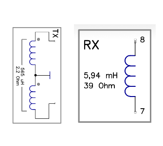

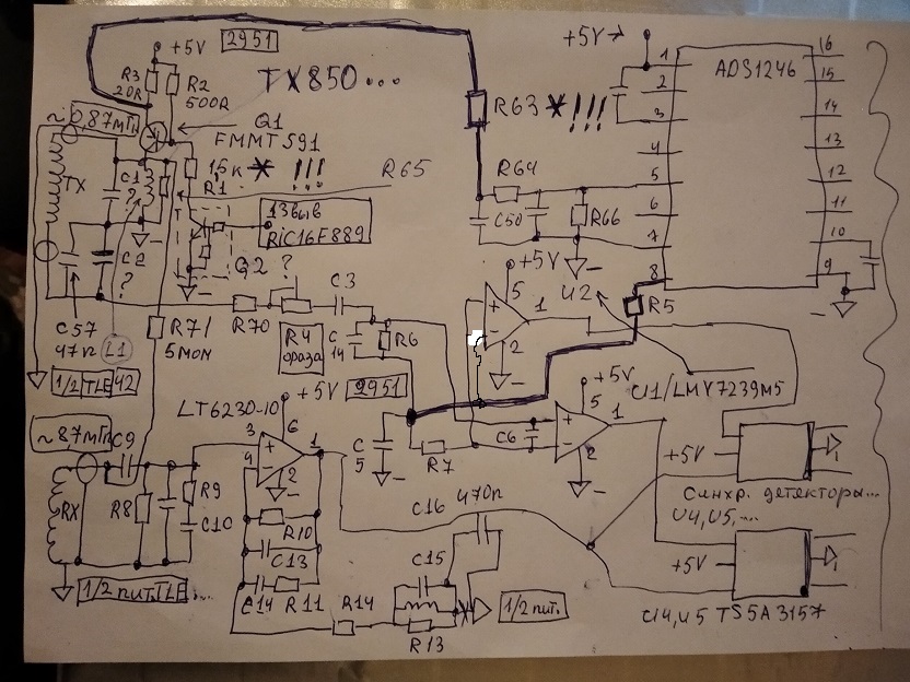

        That is also good information, thank you!
        Check out the highlighted parts of your post.
        That is exactly the direction in which I would like this discussion to turn!
        Given that I have this coil, and in case of T2 you mentioned ... is the inductance at the ends of it 11mH, in the center-tapped arrangement or is it 2x11mH?
        If the inductance is 11mH at the ends then my Quest coil might work as a "center-tapped".
        In that case I would like to see some good solution for TX output.
        But more important than that is to discuss the pros and cons of both methods for TX.
        Here's why I'm asking.
        A good part of the drift problem that can be seen in my videos, I believe, is first of all related to TX.
        I took larger Nel Tornado... or something like that, can't remember the label on it, coil, made preciselly for T2 and rearranged pins at the connector and connected to Quest X5.
        It works quite alright!
        • #49
          I remember nokt macro also use center tap coil Click image for larger version

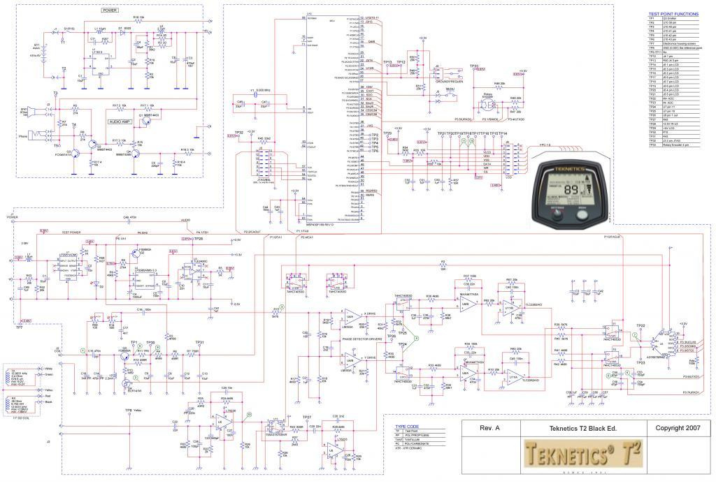

            Maybe this 'X5' Quest coil is a different design?
            The T2 coil has an RX inductance of 7.0 mH, not the 11mH your Quest coil has. The earlier Deteknix/Quest machines were T2-compatible, but newer ones?
            I have never seen a good T2 schematic, so I have no idea how the TX was driven. But as just posted by OP04, the Makro Racer, maybe others, used centre-tapped TX, and their schematics have been posted on here.
            The F75 has been documented, I can find the schematic if needed. I recall that the double-tuned circuit originates in the Troy 5, but it's a Fisher design, and was carried over to the F75.
            I can't remember what the spec of the Tek Delta/Fisher F5/F19 etc coils is, they are posted on here somewhere.

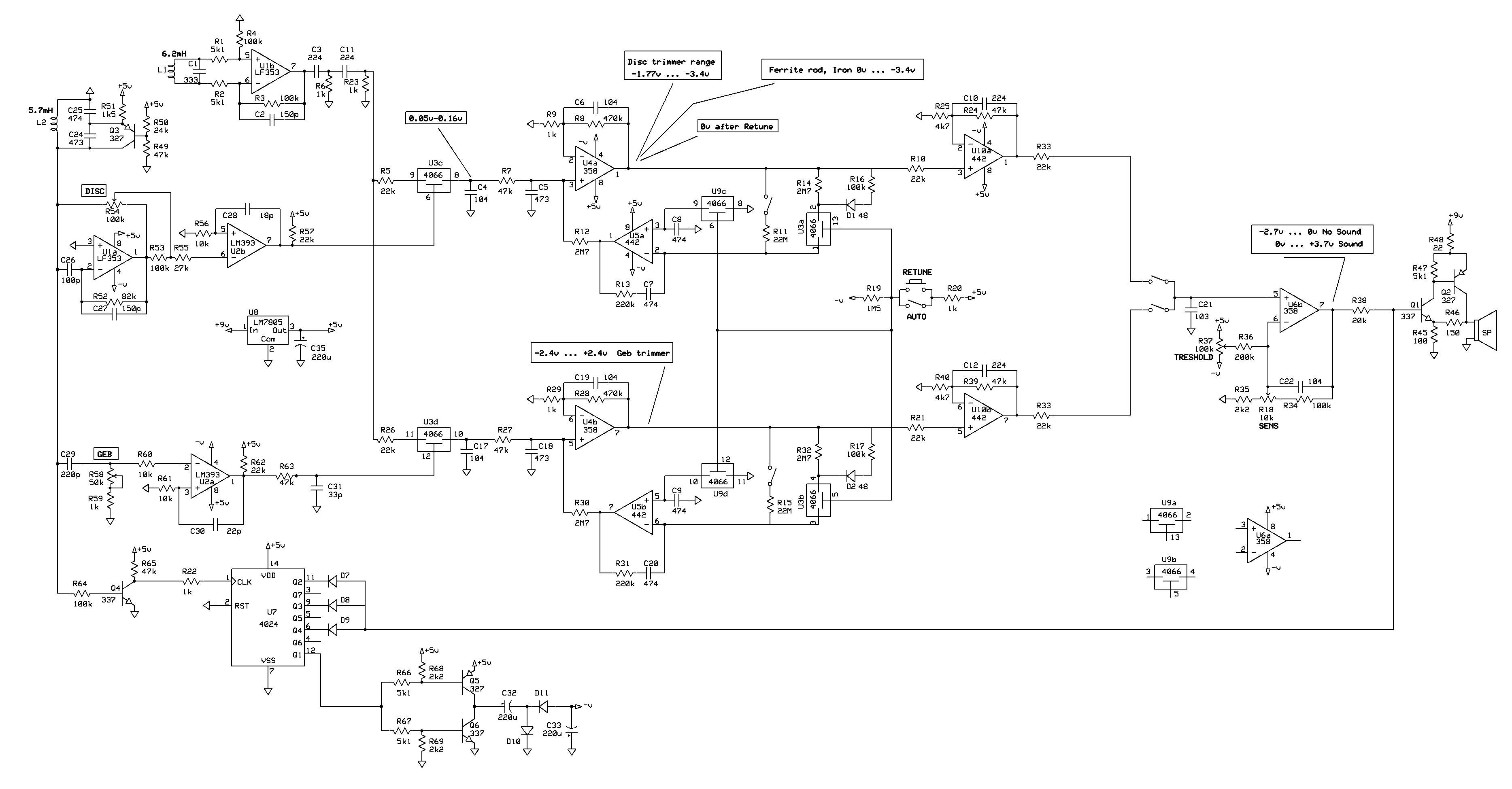

              • #52
                ivconic , nice work , very helpfull
                see please at this link at post 8
                https://www.geotech1.com/forums/show...220B-Schematic
                why do not you mention about this detector? it has a center tabered coil too, and the transmitter
                are not very different.
                • #53
                  Good!
                  Cscope 1220B is probably the best non-motion i had and worked with so far.
                  But it suffers from the drifts also. Needs frequent retuning.
                  And it's schematic is not clear enough to be 100% sure and replicate it.
                  I had two 1220B so far and yet i didn't trece them out.
                  Here I am trying to make something new, to exercise, learn something and kill a time.

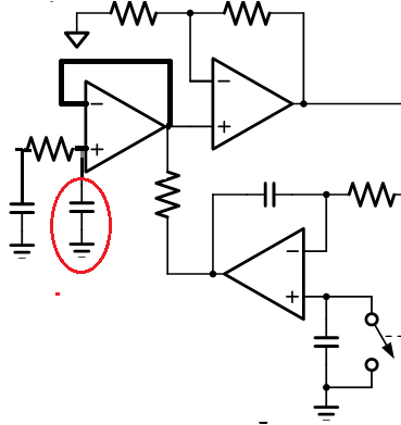

                      • #56
                        I believe you have reached the top ,about the drifting, using analog circuit.
                        I mean about the reset circuit with the improvements of Carl, Its very stable,
                        the same is used in Lorenz LP5.
                        You could adding a buffer before this, like older models of C.Scope (2200TR)
                        I have tested and im using this in my VLF and PI projects.
                        In VLF ,i have seen ,that it is more stable , trimming the filter ,using the lowest value
                        for C, exact there , where the ripple start .

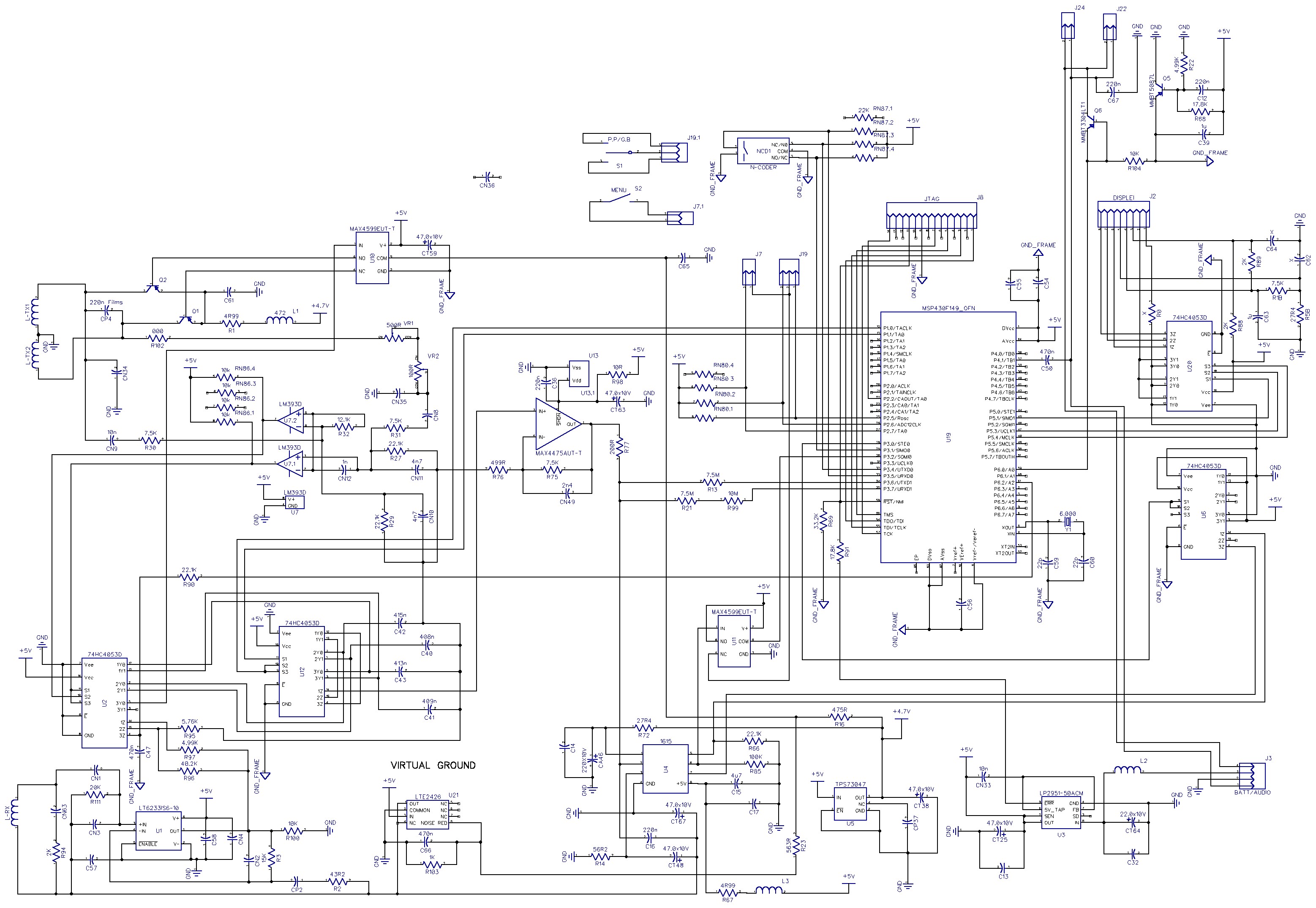

                              • #60
                                Ok, I nicked some time to continue to work on this.
                                Here is the next step, for those who would like to pursue this further:
