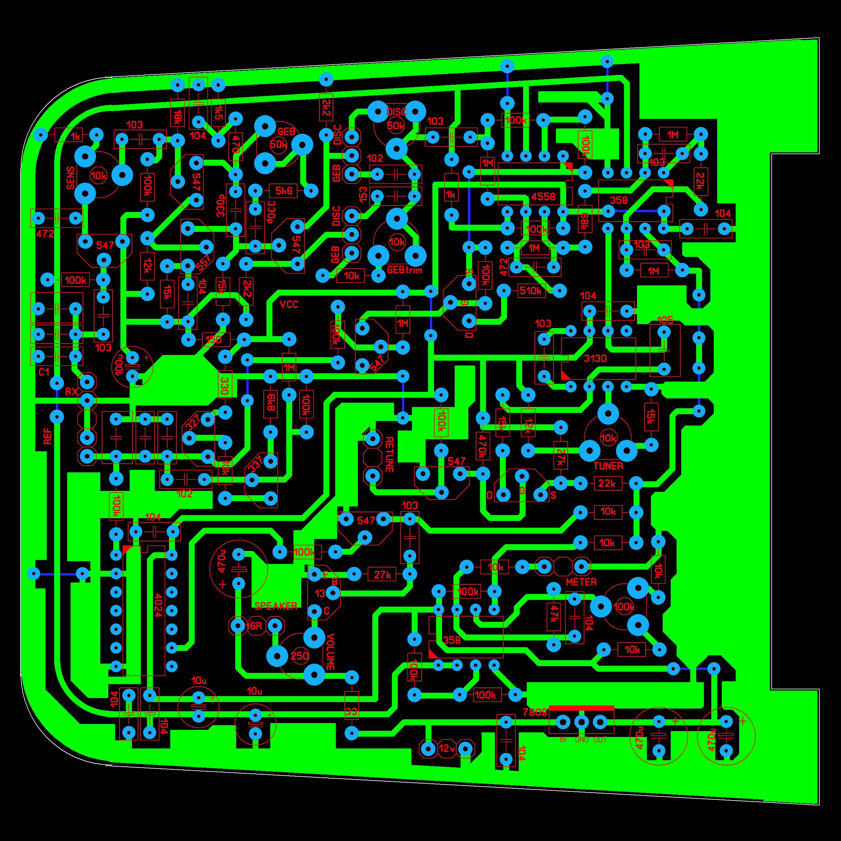

    • Slightly modified, "improved" and good for further experimenting.
      Meter scale is with center position and with adjustable sensitivity.
      Will see...

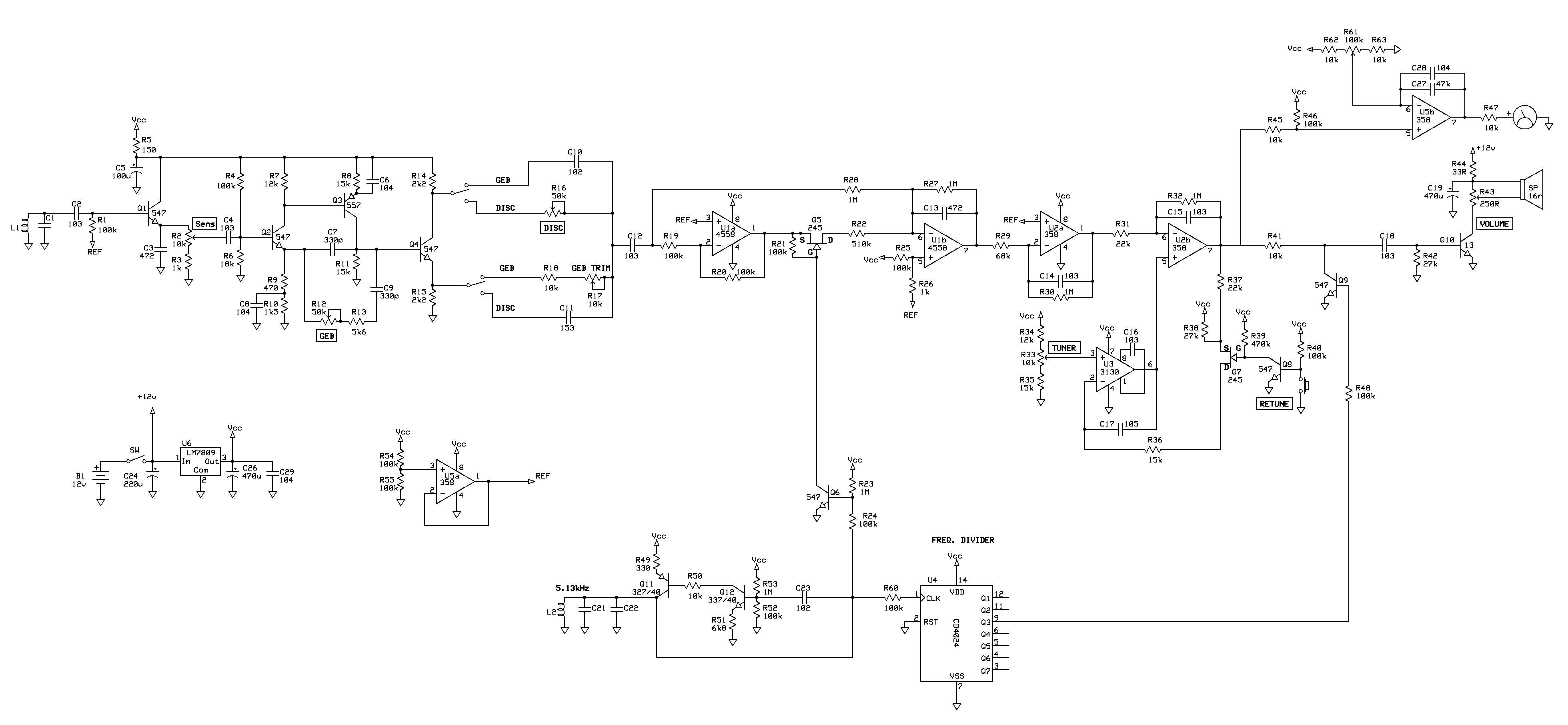

      • The inductance of the original 5000D geb tx coil is 2.9mH or thereabouts. The parallel capacitance is 330nF plus a second parallel cap for fine tuning.
        It's all in the patent 4,293,816 " balanced search loop for metal detector". You can also probably work out the RX inductance since there is a 27nF capacitor across it. Around 35mH. That's assuming that the RX is not tuned "off resonance".
        • The schematic Carl posted above seems to be another version with a different coil.
          The 5000D geb schematic that I am familiar with shows a standard concentric coplanar coil which we're all fond of diy.

                    The other day i ordered two bathces of pcbs at PCBWay, one batch original TF900 redraw and another is CM5000 D/GEB but my "design", smaller one,
                    I think i posted it here; did I? Just checked; yes I did, under the #122 post. That's the one.
                    I picked "FedEx International Priority" method and those should arrive within 2 weeks.
                    So... until than.
                    I can add small "piggy" pcb on CM5000 pcb with your TX and see the results.
                    Question is; shall I change anything at RX side than?

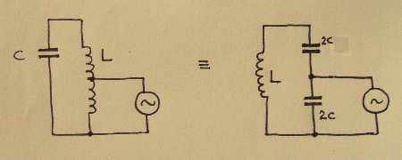

                    • Quote:"Skippy mentioned Teknetics/Fisher coils. ...The Fisher F75 Tx oscillator using a mono loop actually boosts the output more than 2:1. So this circuit might interest some experimenters for their designs. I do not understand the math behind it's tuning and would be interested to hear how it works"
                      I think I understand the general principal. Just as you can take an L-C tuned circuit, and drive it via a tapping on the L, you can do the same function by 'tapping' the capacitor. In practice this means using two capacitors : the equivalent capacitance of two caps in series ( 1/C = 1/C1 + 1/C2 ) gives the tuning capacitance, and the individual impedances ( X = 1/(2*pi*f*C) ) determine the tapping ratio.
                      In the F75 implementation, the tapping-point is 50% , the two caps of 470nF behave as a 235nF cap.
                      When driving the circuit with a unidirectional switch to +5V, it's not going to work if you just switch to the capacitor tapping - a current path to 0 Volts is needed, which is provided by the 2m2 choke ( marked 222, meaning 2200 microhenry ). Then when the switch turns off, there's a back-EMF from the choke, which kicks the tuned circuit the opposite direction. The choke value is high, 2m2 has a high-ish impedance at 13 kHz, so it doesn't affect the main tuning circuit much ( I assume ).
                      I don't know the purpose of the extra small cap across the coil ( 3n9 apparently? I 've never measured it ) , it's in parallel with the main 235nF, so should change the tuning C to ( 235 + 3.9 ) nF, which resonates with the 695 uH coil at 12.35 kHz. Why not at 13 kHz ? I've never simulated it, maybe with the TX coil resistance included, and the choke R & L included, it gives a better mathematical match.
                      Attached schematic:
                      (edited choke value error )

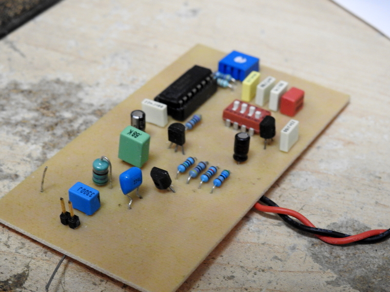

                      • It's been almost a year since I was messing with this, so not so fresh in my mind. I used the axle style inductor from ebay.( see link) Also a photo of my test board.
                        Like I said in my post above, not sure how it works or is tuned. I used the simulator to adjust parts L1, C2, C3, C4. Pick your frequency and tx coil inductance and adjust the other values to get your desired output.
                        https://www.ebay.com/itm/23334390275...3ABFBMxM-si8Fg

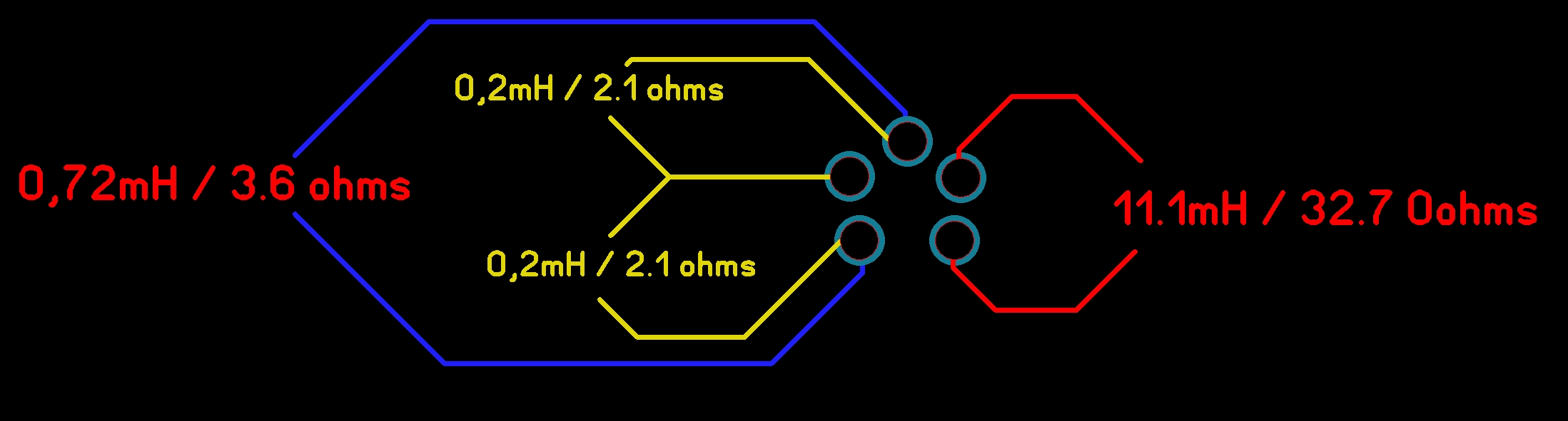

                            • Have I posted this sketch before? Not sure.
                              I am having problems with memory lately...
                              Here is what I measure at Quest coil:
                              It looks like it is center tapped too.
                              Would be good to take an advantage of that situation and design TX arround it.
