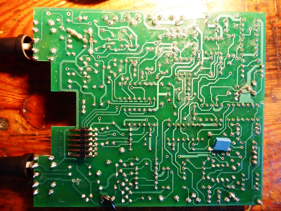

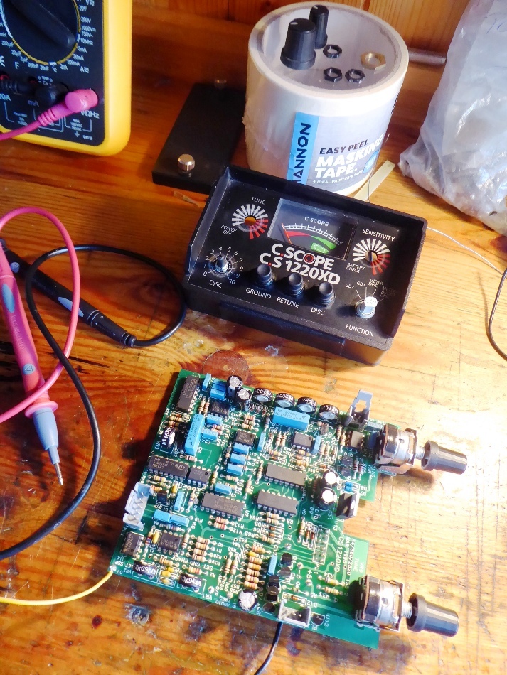

      Hi, It has a power supply problem. The circuit is powered by a 12v battery supply. At the power switch, the 12v is present and feeds a 5v positive voltage regulator but its output is measured at +11v. instead of +5v. There is another 5v negative regulator and the same applies there. I have replaced the first 5v. ic but is has not made any difference and a cold test of the other larger 5v negative does not show any signs of been damaged. With a double sided pcb and so many ICs, its not only time consuming but extremely difficult to follow any test pattern.
      I am attaching pics of the pcb.Click image for larger version
ID:	363367Click image for larger version
ID:	363368Click image for larger version
        Any thoughts about this?
          can you send me High resolution pics into email? your light is good but i suggest to do
          pics under sun at open air. we are not prof cameramen having a kit of light sources but light conditions will be near to good then.
          [email protected]

              It is a double sided circuit board which is not easy to photograph in detail. Would you be able to offer any recommendations or likelihood of fault, or are you just looking for the board's component layout?

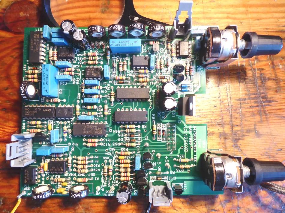

                      I am attaching some pictures (best I can manage) of different parts of
                      the circuit board to cover most of the components on it. I have found
                      that after replacing the + 5V Voltage Regulator U12, the output now with
                      a power
                      supply of 9V or 12v (this model is supposed to accept rechargeable and
                      alkaline batteries) varies between 6.6v and 7.5v at test point + 5V on
                      the board. This voltage is present at the input of all the chips
                      except for chip U14 (right behind the disc. pot at the front of the
                      board). This is a low power TLC555 timer and reads 11.5v at all the 7
                      pins except for the ground pin no.1. Could this be the fault I am
                      looking for?

                      There is a protection diode (soldered across the pins at the back of
                      the board) but it's not damaged. I am also checking the pair of
                      transistors BC213 and BC184 feeding into it but I am hesitant about removing
                      components on a double sided board unless I am absolutely sure they are
                      dud. What do you think?
                      i still do not see whole part list of IC's. do not know what is U12. i grasp for what TLC555 is.
                      maybe for negative voltage power source or frequency modulation, can not understand.
                      luck information. the board in your hands, not in mine.

                        Components list:
                        U1-TLC272, U2-4053, UC-3LM339, U4-TLC272, U54053, U6-TLC272, U7-CA3140, U8-CA3140, U9-LM358, U10-4013, U11-4053, U12-7805. U13-7905, U13-TLC555.
                        Q1-BC184, Q2-??, Q3-J113, Q4-BC184, Q5-BC184, Q6-BC184, Q7-BC184- Q8 BC636, Q9-BC184, Q1O-BC214.
                        D1-4148, D2-4148, D3-4148, D4-4148, D4-ZENER 7V, D5-4148, D6-4148, D7/D8-BAT-BLUE?, D9/D10-4148, D12-4148.
                        ELEC. CAPS. CA18-100UF, CA20-10UF, CA21-100UF, CA30/31-200UF.
                        All Transistors, diodes and caps. have been tested (in circuit) no damage.

                            Anatloy. U13 is Voltage Reg. L7905 and this is a new one I have fitted. U14 is the timer TLC555. There is only one TLC555 and the problem has to be between U13 and U14.
                            The components involved in this part of the circuit are D7 and D8 (both test ok) Then we have Q9 BC184 and Q19 BC214 (both test ok in circuit) The 220uf Q31 that is connected to the
                            U13 L7905 input pin 2, I have removed it and test 100% ok, so the problem, in my opinion, could be the TLC555??
                            I have been thinking about removing it but I haven't got a replacement and I wanted to check everything else before doing that as it is double soldered on the PCB and not easy to remove.
                            I will order a new TLC555 just in case.
                            On 24/09/2022 21:04, Anatloy Dirtymad wrote:
                            both TLC555? then both are CMOS, not NE555.
