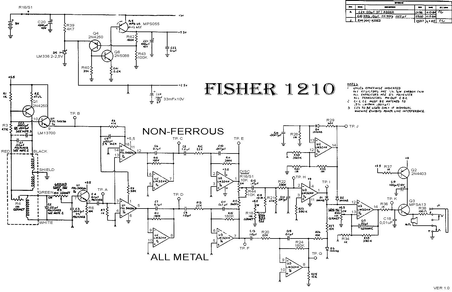

    Can anyone please help with a schematic for a Fisher 1210-x. The on/off switch / pot was broken and has being replaced. Unit now appears totally dead. Any help appreciated.:confused:

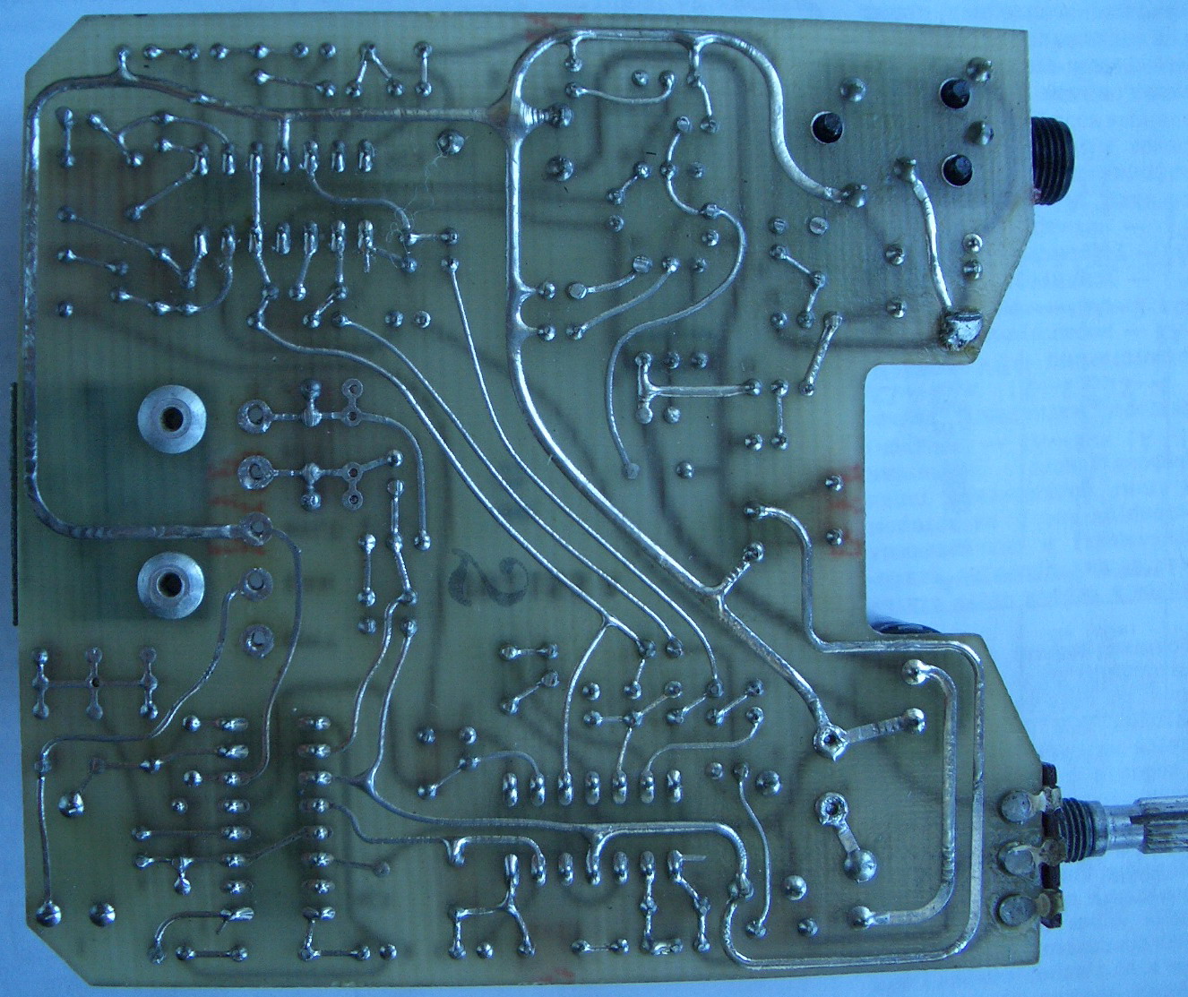

          are there pcb?

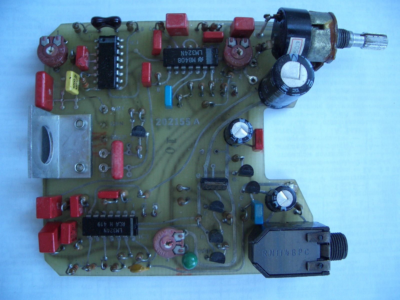

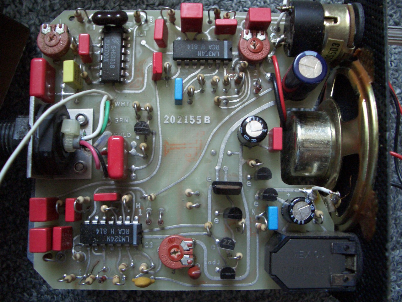

                Look on the schematic. Near the speaker is an adjustment "sens". Then look on the photos or your own board, it is next to the head phone jack. This adjust the sensitivity of the unit. The trick is to adjust it high enough to get good depth but no falsing or chattering from the speaker. Don't play with the other adjustments. This should make your poor unit better.

                  backing to old matter... anybody can reply what the marking of U1 on the circuit? do not wrote me it is LM13700
                    the reading is LM13700, just google for it and you will find the datasheet. It's a Dual Operational Transconductance Amplifiers with Linearizing Diodes and Buffers.
                    GeoMax
                      I think it was a LM13700. See your photo in above post #6. You can see the chip clearly. Photo "fisher 1210 lay"
                        look on post #3. you see the sch. open it.
                        i meant that, not PCB. please do not mention LM13700. i just want to know what type on the sch.
                        i believe it is american made chip.
                          It says FRL510266, which is an internal part number assignment for Fisher. It is actually an LM13700.
                            thank you guys. the mistery got answer. case closed.
