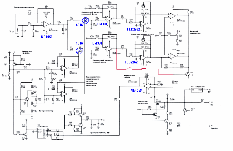

            be sceptical to it... i noted some mistakes, you must compare to another one of tesoro.

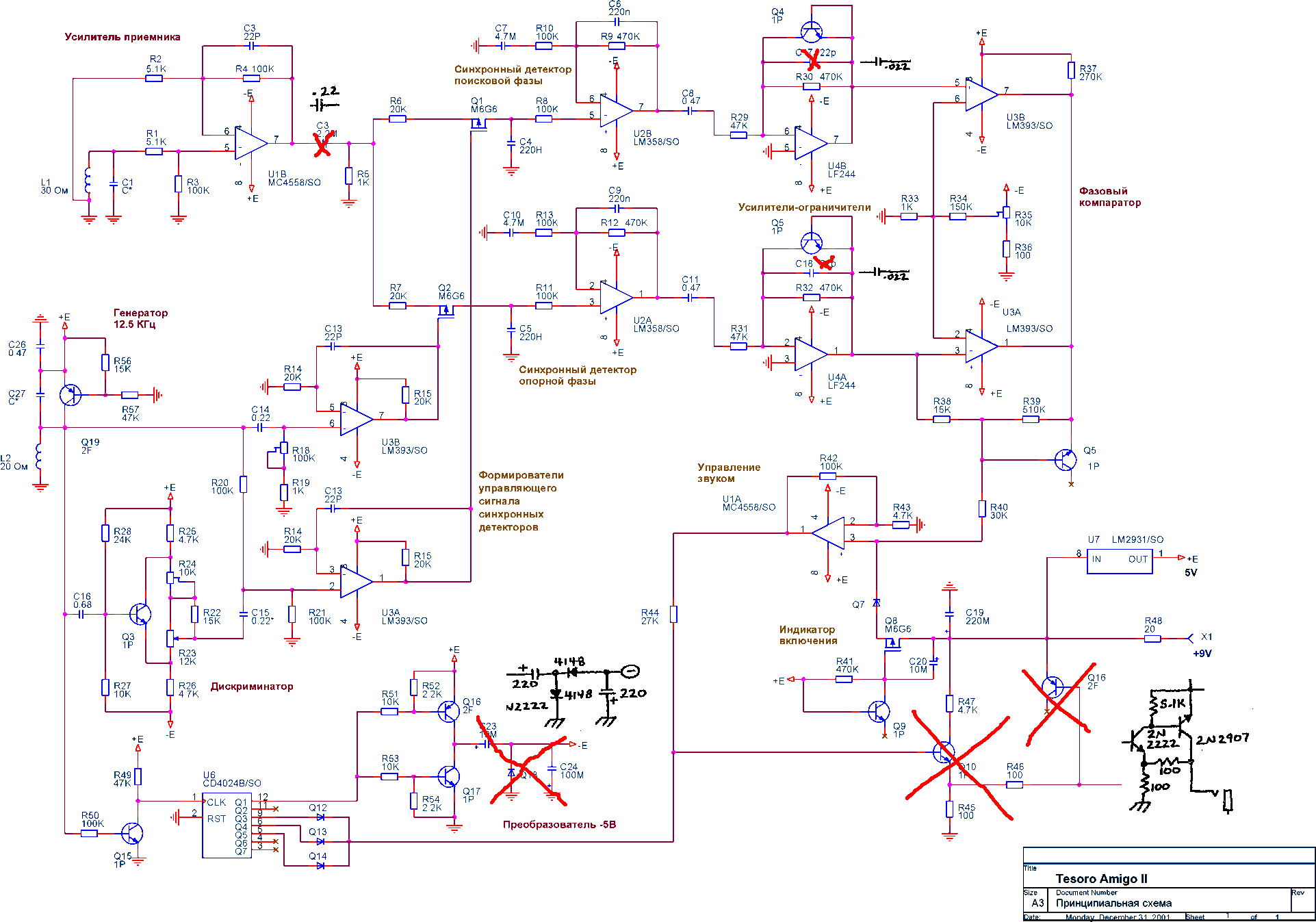

                  All this info was collected in this forum. Maybe helps you.
                  Hi Esteban,
                  red switch? What func?
                  value for red rezistor?
                  (tesoro compadre schematic)
                  Thanx
                  Michal

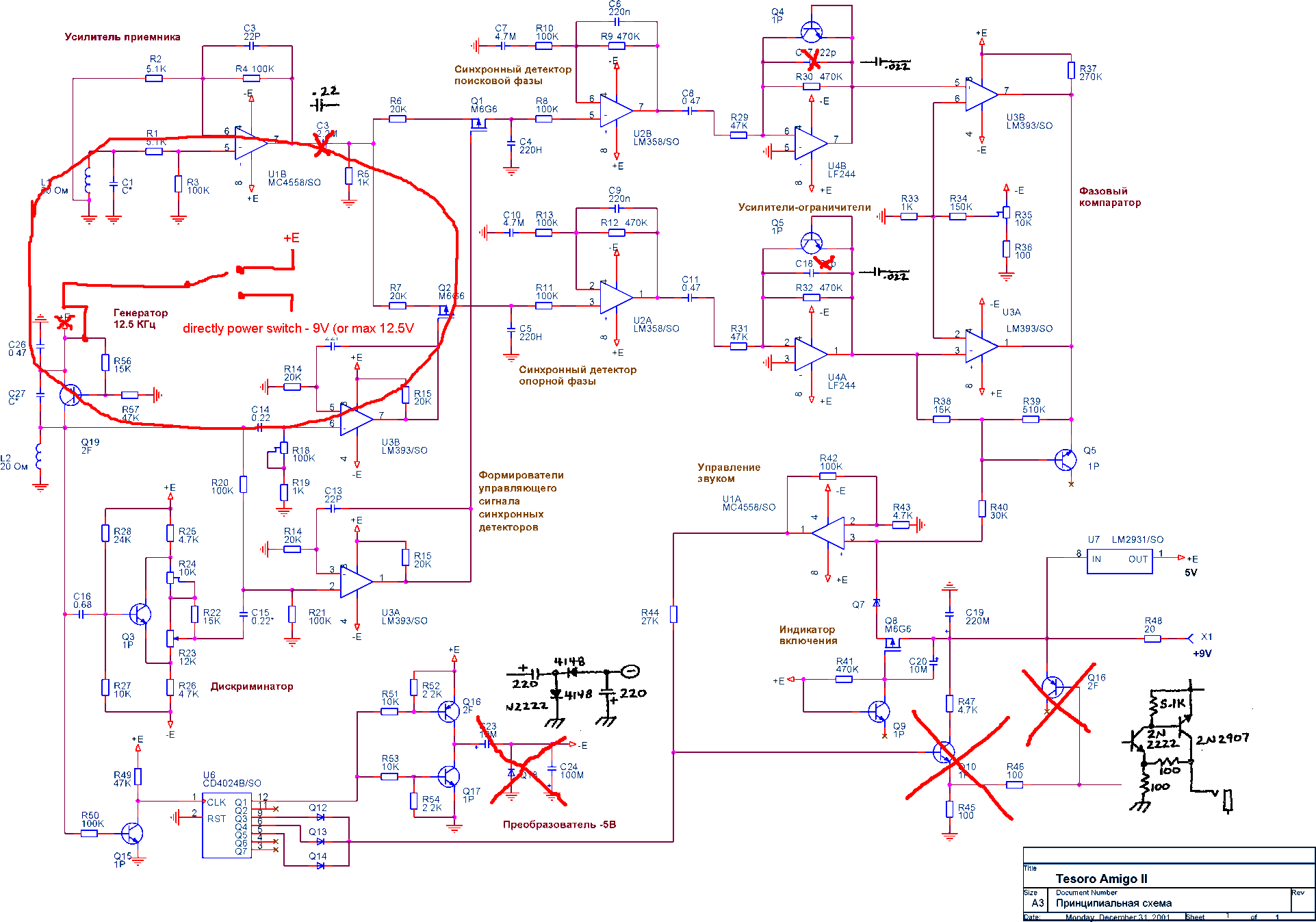

                      Modify compadre
                      Hello - my modify Tesoro Compadre
                      Depth detection with this mod increasing:
                      9V ....... 1EUR ...... cca 25-27cm/air
                      12.5V ... 1EUR ...... over 30cm/air
                      Tested and 100% work
                      With 12.5V need stabil. 9V for suplly power box.
                      12.5V is only to TX section.
                      Sorry my bad english
                      Michal
                        Michal
                        Hi Michal,
                        have you used a standard coil for it ?
                        I detect 1eur at 30cm in ground with an homemade DD22 on bandidoII.
                        I also think that putting small more voltage on osc section could give a boost in depth... like happens in other tesoro's models.
                        What about stability ? Have you noticed any difference on the field ?
                        Best regards,
                        Max

                          yes, tested with standart Compadre coil (5,75 inch)
                          Stability OK
                          Michal
                            Stability OK - no without change.
                            Michal
                            Hi Michal,
                            really interesting.
                            1eur at 30cm air test with a 5.75 inch coil is a very good result,
                            much similar to PI performances than standard VLF.
                            Is about 2 times the diameter of the coil.
                            Very good.
                            I'll try similar mod. on TGoldenSabre soon and see results there.
                            Kind regards,
                            Max
