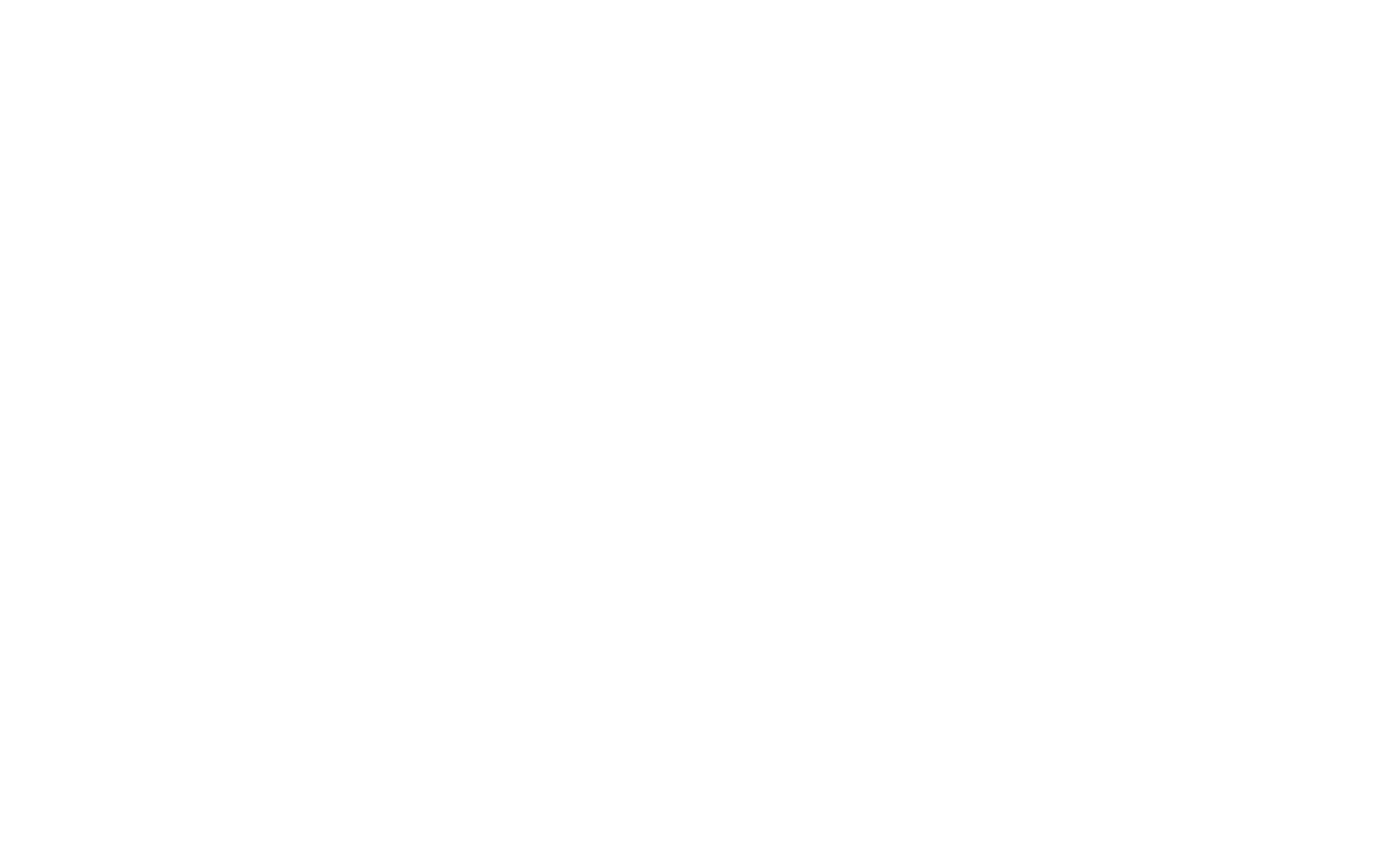

      Hi KT315. Is Yours schematic spy version?
      Mrand
        Hello Mand and KT 315,
        Seems your schematics are not Discovery 2, but Micronta 4003.
        Discovery 2 has number 63-3004.
        proscan
          exactly! , i counted IC's, discovery 2 have 22 of it, so, quit difficult circuit and chematics above is very simple, but thanks anyway!

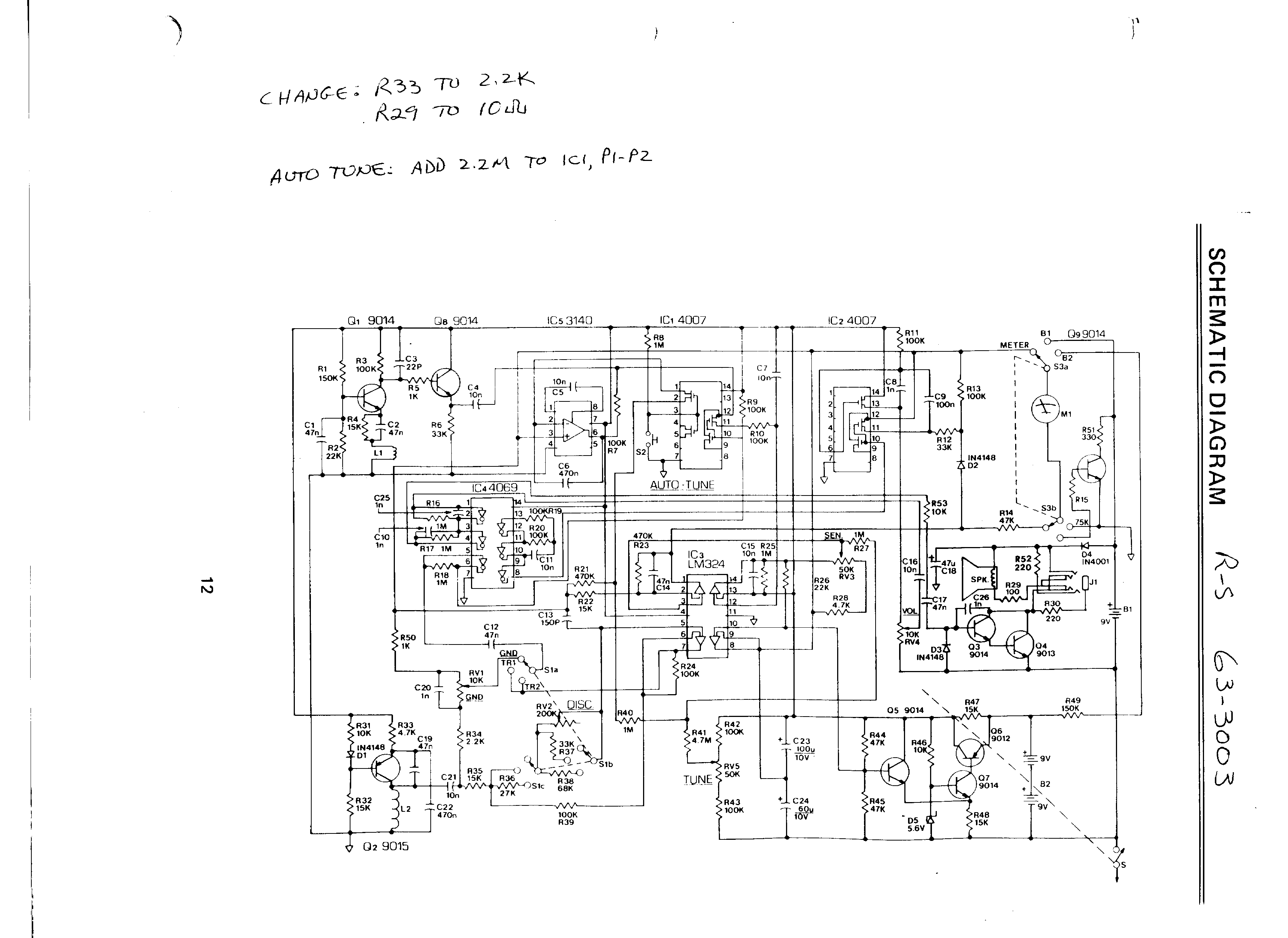

            Micronta/Discovery SERVICE MANUAL!!!
            The Service Manual for the Micronta 4003 VLF Discriminator Metal Detector is Cat. NO. 63-3003. It has a trouble shooting guide, Schematic, Parts Layout, Parts List. The order "Part Number" is MS6303003 from any Radio Shack if they are still in stock??? I got mine in 1996 from Radio Shack Unlimited 401 N.E. 38th Street Fort Worth, TX 76106. If I remember right I ordered mine at the local Radio Shack store in DEER PARK, WA 99006 USA. and it was shipped to my home address. I don't know if the Discovery??? guide is avaiable or not. You may try contacting Keith Wills in Texas he repairs and sells metal detectors and may have a copy of what you guys want.
            Hope this helps???

                    Since Pruva's link is long gone and the only thing I can find on the web is a text version of part of the manual, and my wife just found my original manual, I did a full scan of it and put the resultant .pdf file on one of my sites. View it or download it and enjoy. (It's a 5MB file.)
                    http://www.webdingers.com/Micronta 63-3003.pdf
