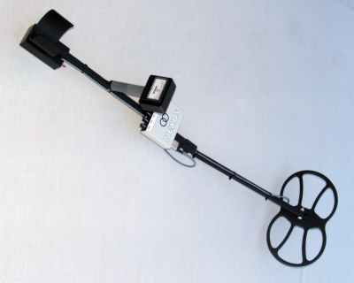

    Hi again
    NEXUS m.d. pictures .
      It isn't something special. I have it on a file, if interested, mail for exchange:[email protected]

              Do not believe anyone who claims that they have Nexus schematics. They lie.
              There is many similar (some of them were posted by me) to the Nexus schematics, but the original Nexus schematic was not posted or published anywhere so far.
              For more information please send request to; [email protected]

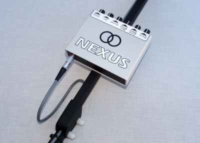

                  From what I know (or think to know) Nexus is just an older schematic redesigned from other previous bulgarian works and thus provided of newer circuitry like some you can find in e.g. Tesoro's or White's. Think e.g. at sampling, timing, low noise op amps etc
                  Then the "secret", as Georgi said here before... is not in the circuit, but in the good coils he made.
                  A power osc + a very good OO coil and voilla: you get your targets deeper.
                  For me it's a good explaination and I trust him... have no reason of thinking there is an Arado under the cover.
