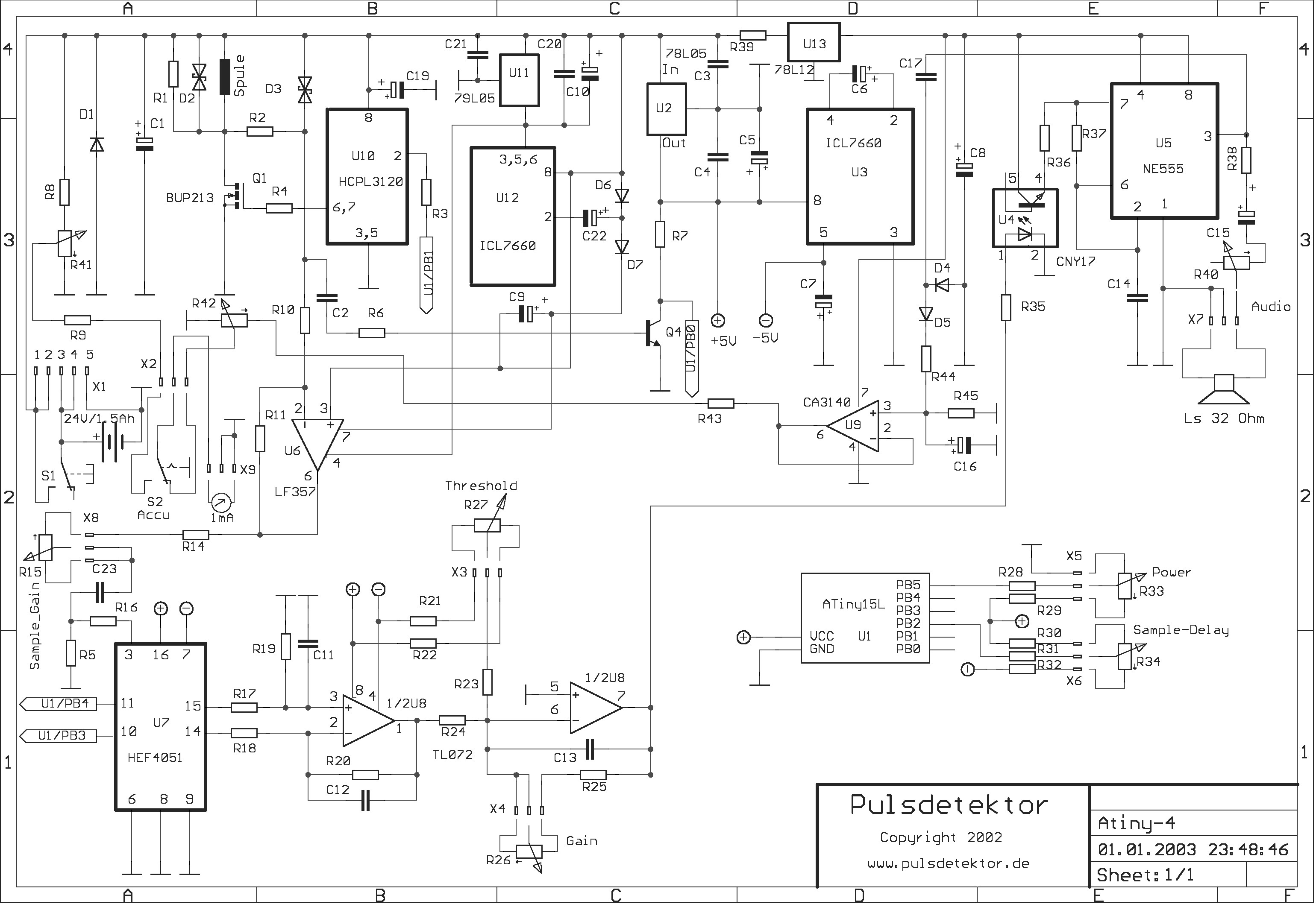

      I've been studying the circuit for a couple of hours today, because my unit was unstable with larger coil for unknown reason.
      After a session with scope, I added two 1µF tantalum capacitors between ground and +5/-5V, very close to US2 (I even thought about soldering them directly to the US2, but it's easy to damage IC that way).
      Then I found out that the GND carries spikes (couple of mV's) caused by the coil current. I desoldered the coil ground connection from the point marked on PCB (take look at the ground path, IMO it's a design flaw) and soldered it directly to the C12, it reduced the noise by a lot and the detector runs stable

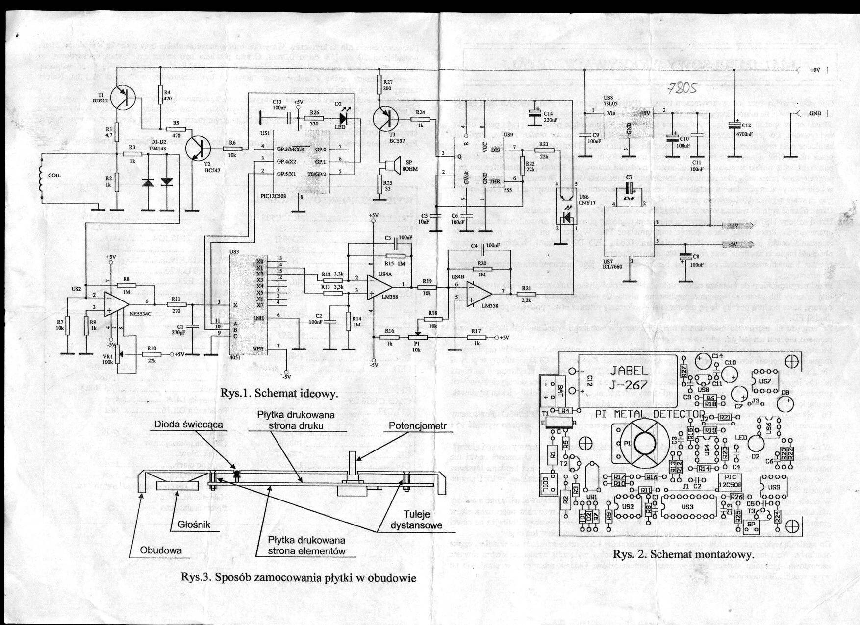

              • #52
                Hi dantech, please can you give here pcb layout? Thank you very much.
