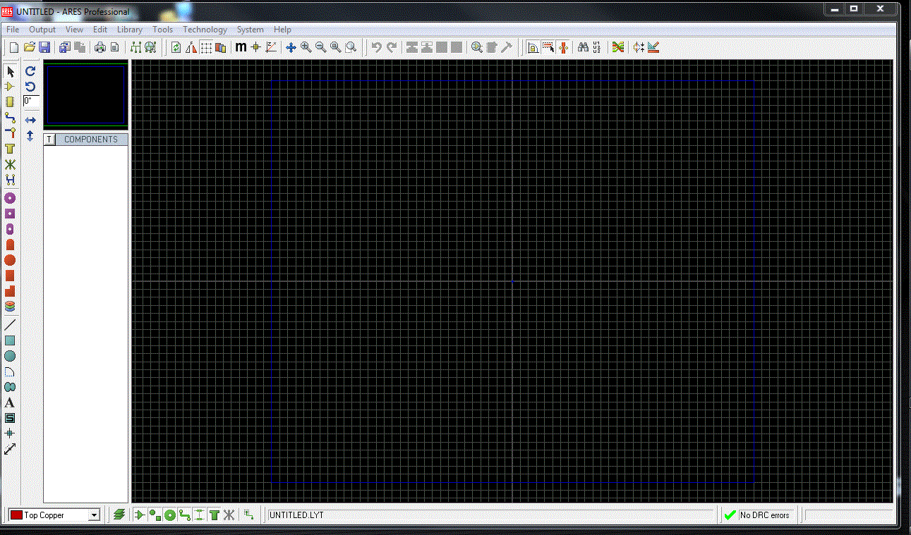

      Hi Silverdollar,
      Inside the rar is the "GOLDSCAN IV.LYT" file but when I open with Proteus I dont see anything except for a rectangle.
      If you can send this to me I will get some boards made and send one to you for free if you like, if I have any spares I will give these away also..!
      Cheers,
      Dean
      • #48
        Funny I open it with 7.7 and see this;

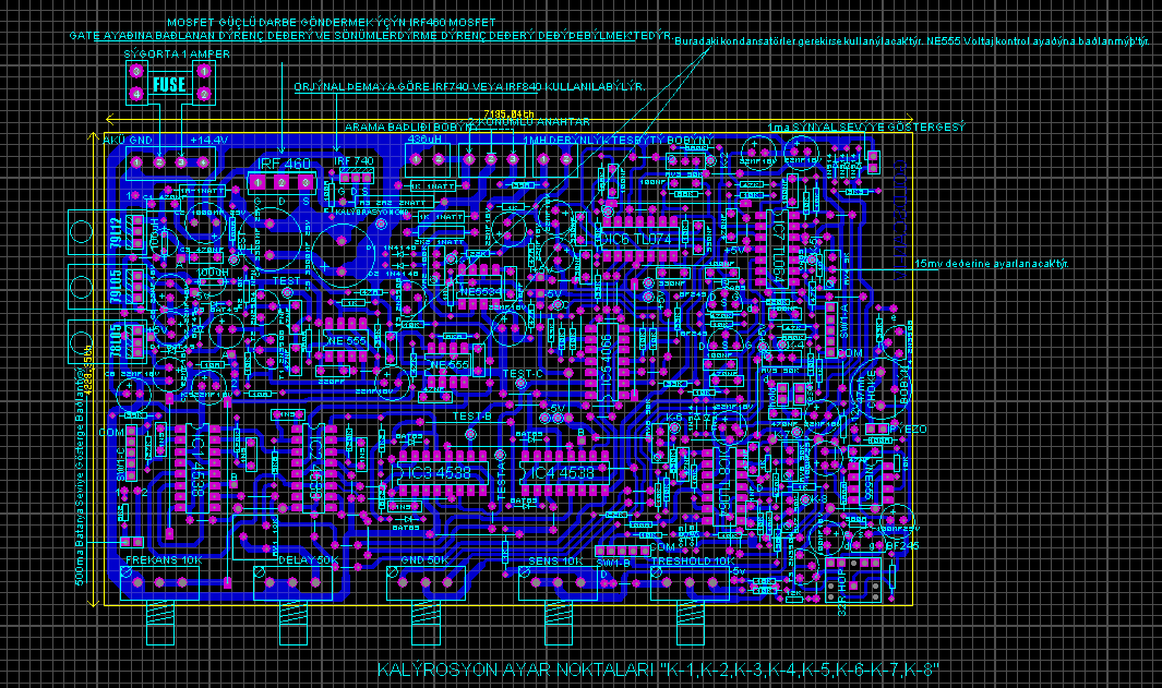

        • #49
          Hello all,
          Sinclairuser is right, there is no decent board layout available. The board that Jose' used, is (I think) the smd one, with schematic produced in ISIS. And he had found it was difficult to get working, requiring some fiddling and hacking. The one that Silver Dollar posted is a Turkish clone. Have not seen anyone build that one.
          Alexismex posted the first back-engineered schematic. He also posted some nice photos of the original board, that could conceivably be used as reference for a new board. Sadly I have zero experience in using schematic/layout software (maybe the time is nigh).
          Ivconic has posted up a schematic (http://www.geotech1.com/forums/showt...691#post181691) in ExpressSCH format, BUT, at the time had not gone over it to make the various corrections and modifications that were suggested in various posts scattered over a few threads.
          Possibly Ivconic had some spare time over the winter, to update his work... and will reply here ?
          • #50
            Hi Silverdollar,
            When I open with 7.8, I see the following..
            • #51
              the main problem here is no one is prepared to reverse engineer eric's designs in a pure manner(except george), they allways tinker and change, the subtle ways eric does things will be lost that way.
              the only way to do this is like how george has done the mini pulse, reproduce it completely from the board up, then just modernise the bits that are hard to find, or not used.
              you must resist the temptation to change components willy nilly, if you do that with one of eric's designs it will wend up a mess.
              and it will not work as intended, he comes here, ask him to let us have the proper design, or at least over see the attempt, why bother unpicking this if we can have it pure.

                          • #58
                            Originally posted by Dean Sarelius View Post
                            Hi Silverdollar,
                            .gif is not Proteus PCB file. Open it with Windows paint program.

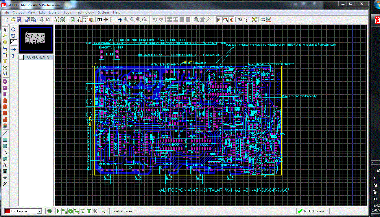

                              • #60
                                Hi All,
                                I managed to get the Goldscan PCB to load up in 7.8 it was a path issue when I was opening the file it kept defaulting to "untitled.lyt" so was struggling to open the file..!
                                So before I get some PCB's made can someone verify that this is the most up to date version please..?
