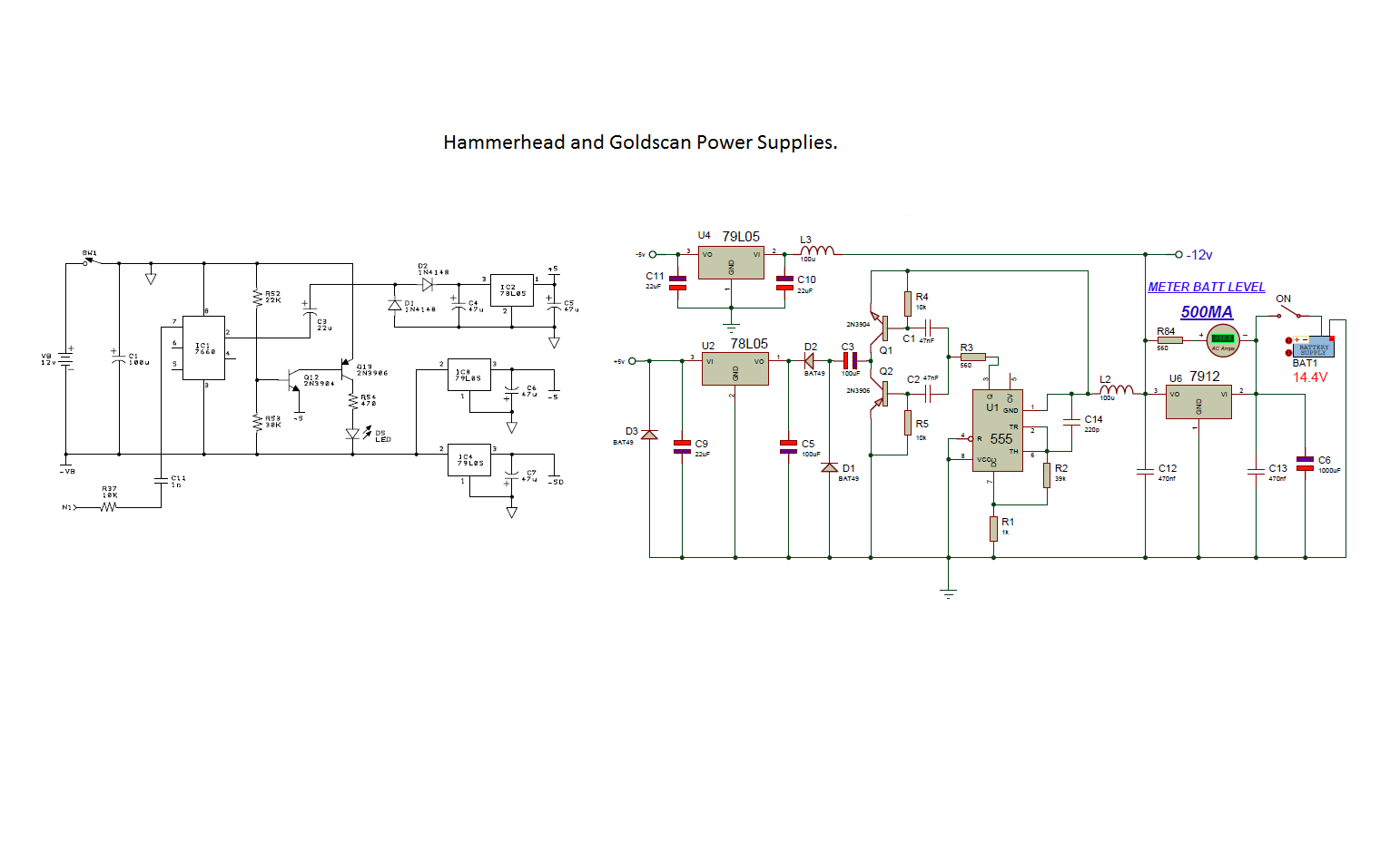

    The potential for noise in this design, is mentioned by others who constructed it. The first step is to identify what elements are causing, or contributing to noise. A lot of talk centred around elements of the power supply. One definite improvement was recorded by Jose', and that was to use a 7660 as is used in the Hammerhead power supply. http://www.geotech1.com/forums/showt...074#post166074
    And Max mentioned "by-pass" caps on the input and output of the 7805 regulator, to remove ripple. http://www.geotech1.com/forums/showt...5856#post75856

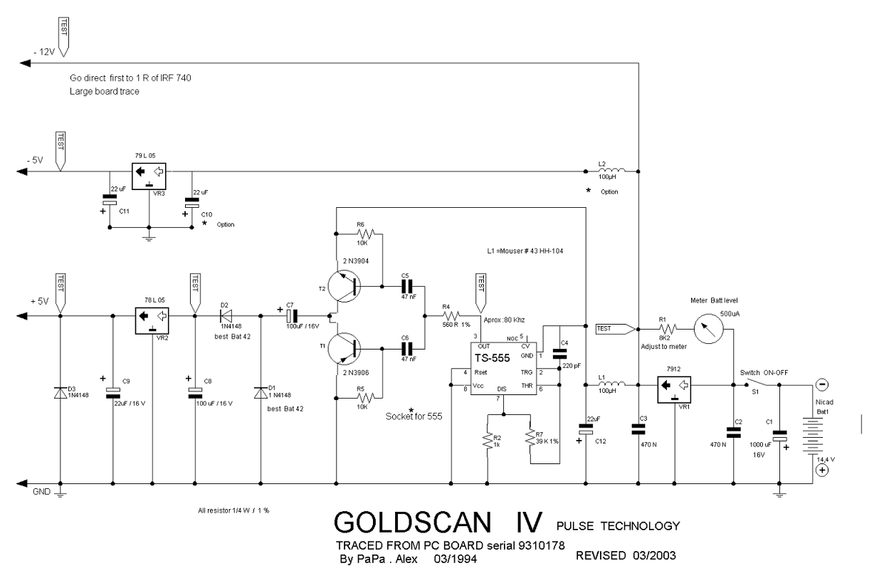

            Here is the power supply schematic. It appears to be quite simple in design.
            First we have to establish the status of your battery power pack. Is it made up of individual and disposable batteries ? Or are they rechargeable ? Can the health of the batteries be confirmed as having the required output ?

              Thanks for the schematic.
              My batteriepack is OK. It is 10x AA (15,75V).
              +5(+4,9V); -5 (-4,99V); and -12V (-11,95V) are ok. Some of the transistors or 555´s make sound without headphones or speaker connected. Have to check this. And 7912 gets realy warm.

                  Looking at a photo I found in other thread, you can see the 12V regulator fitted with a clip-on heat-sink. This would imply that some heat energy is generated and needs to be dissipated during the course of normal operation. I expect that is the normal case with regulators of this type.
                  If you are really keen and want to experiment with the option that Jose' implemented. Then maybe you could look at building a small circuit on strip-board, and carefully substitute the original.
                  • #84
                    By taking 12V from your original supply or building it into your substitute, and feeding it to a circuit clone of the Hammerhead supply you could, possibly, end up with a quiet solution. Deactivating your original and connecting in the substitute would take some careful tracing of your circuit board. You would need to tread very carefully and double check any connection needed for audio. Also bear in mind the need to supply pin 7 of IC1 (HH PS), with a filtered/regulated signal from your GS TX 555 ic. Obviously IC4 is excess and not needed for your board.
