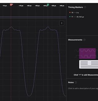

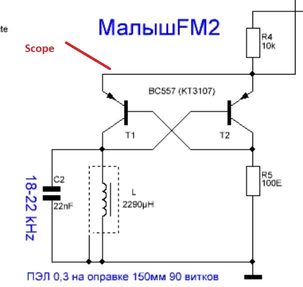

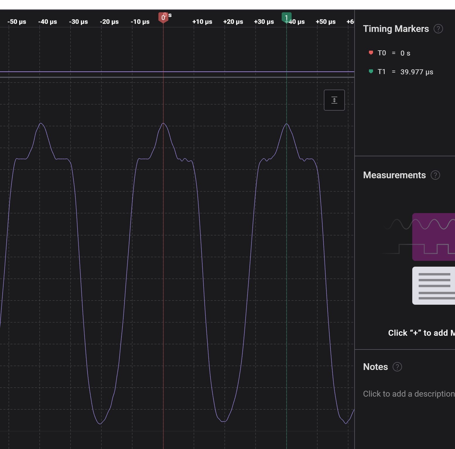

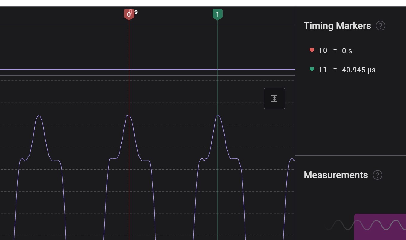

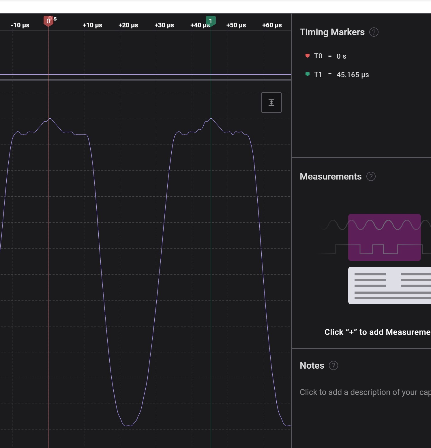

            So I built just the oscillator section and was surprised the frequency and the amplitude changed with different metals placed in the field !
