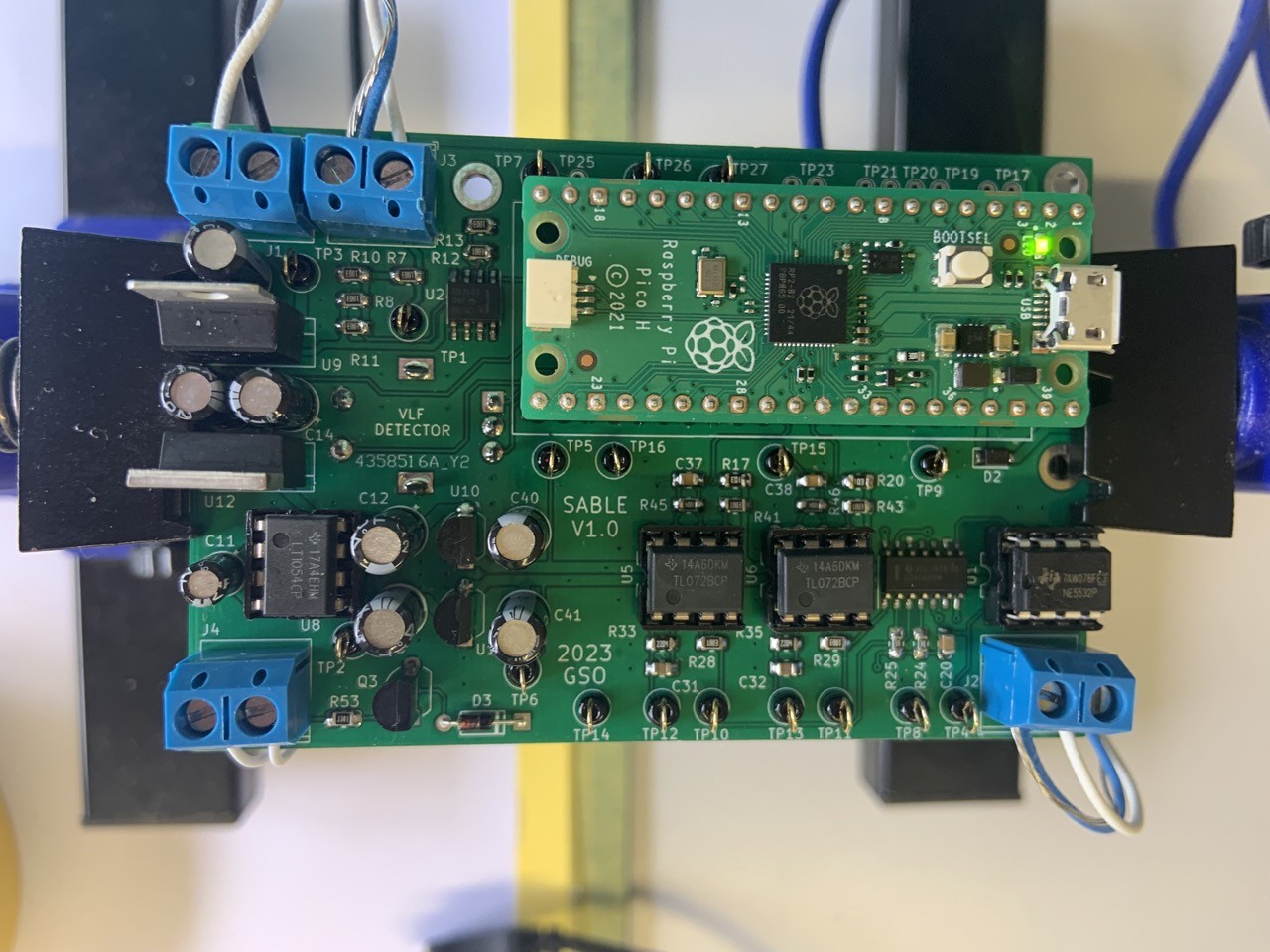

    After experimenting quite a bit with PI detectors it was only natural that at some point I'd want to take a closer look at Induction Balance designs.
    It seems that the coil is much more critical and less forgiving with IB and so to give myself a platform for experimenting with various coil designs I came up with a design which takes inspiration from the 'Raptor' project but uses a Raspberry PI Pico for timing and VDI display which fits on a small 90mm x 60mm PCB.
    I've got the first one up and running in the lab with very promising results. Detection distance is pretty good and the VDI seems to work well even though the code is still pretty rudimentary and I think there is much room for improvent with my coil which is my first attempt at building a double-D.
    I've called this project 'Sable' and here is the schematic and a few pictures. If anyone is interested I can post the gerbers and Pico code such as it is.
    [ATTACH]n414268[/ATTACH]

    Olly
    Looking nice.
    LT1054 choice surprised me a bit.
    It is old, tough to obtain and not cheap.
    But that would be the easisest part to modify.
    I am not familiar with Pico programming, though I do have one RaspB. 3+ for long time, forgotten in some drawer.
    But I see there is Pico on local market and the price is affordable.
    Any shorter video demonstration?
    Can you be more precise about TFT model, specs etc.
    I can't locate it in local ads.

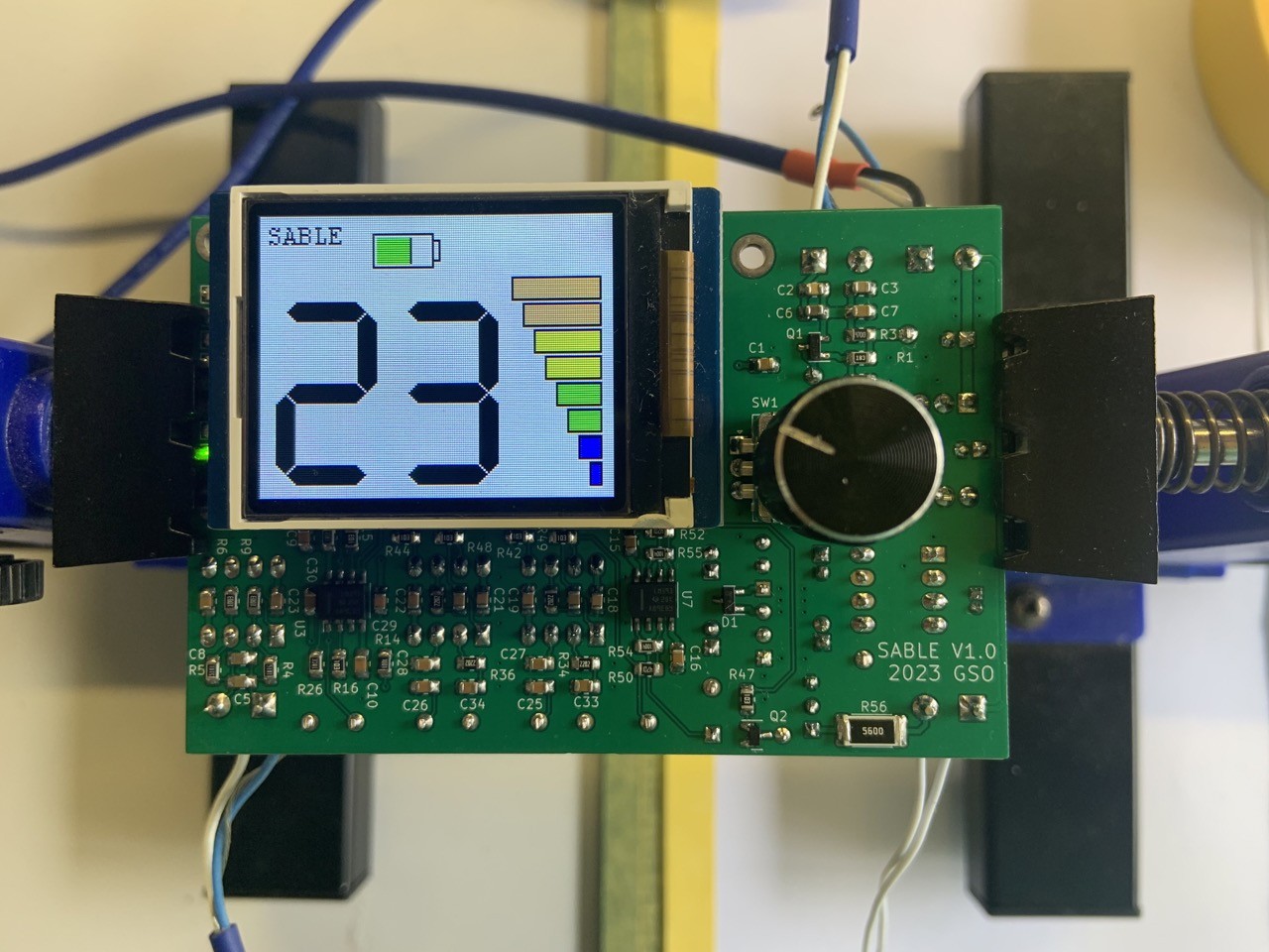

        Here is a short video showing the VDI in action for a number of coins as well as a pull-tab.
        The bar graph on the right shows signal strength and as can be seen the VDI is relatively stable across a wide signal strength range.
        Still very much work in progress with lots of tweaks to come and at the moment there's no -ve indication for ferrous targets yet.
        https://youtu.be/7MiHW2Rm1mc​
        Olly

              Operation is relatively simple: -
              Double-Clicking the encoder pushbutton illuminates the top LED and then allows R sample phase adjustment via the encoder.
              The next click of the button illuminates the next LED and allows X sample phase adjustment.
              Adjustment of the Sensitivity level is after the next click.
              The final click stores changes to the flash and returns to normal operation.
              I plan to have these values displayed on the LCD while adjusting, also to have preset discrimination and sensitivity selection via the LCD. More of the work-in-progress stuff...
              All of the timing generation is done without involvement of the main processors either via programmable PIO or with the built-in PWM controllers.

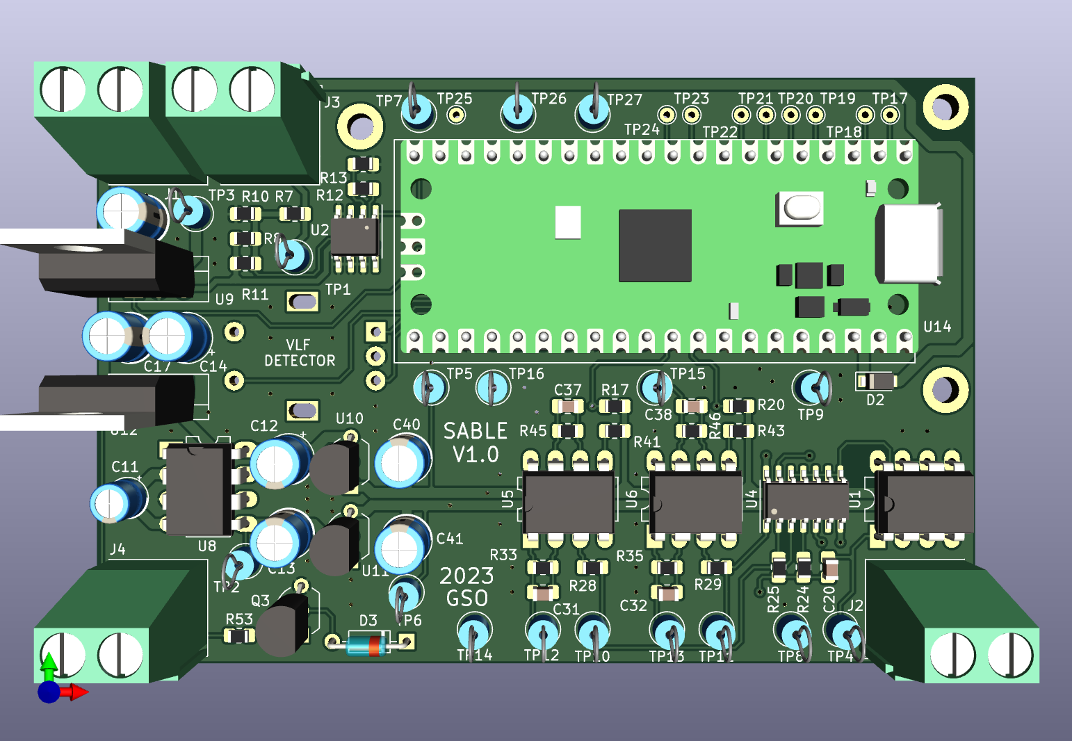

                      Here are the gerbers, I used JLCPCB to have them made.
                      sable_gerbers.zip
                      Due to the compact nature of the board some of the references on the silkscreen are not as close to their components as I'd like, so it's advisable to use the placement guides when assembling.
                      Front_Fab.pdf
                      Bottom_Fab.pdf

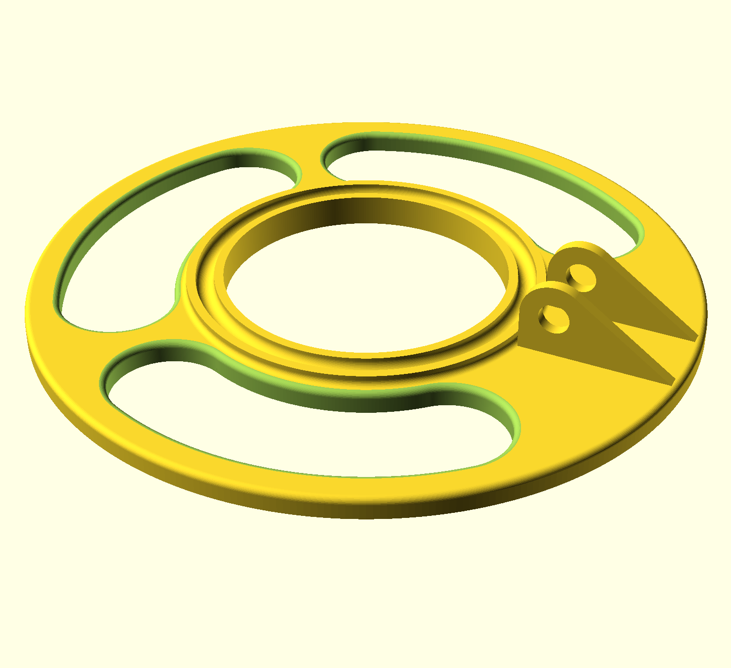

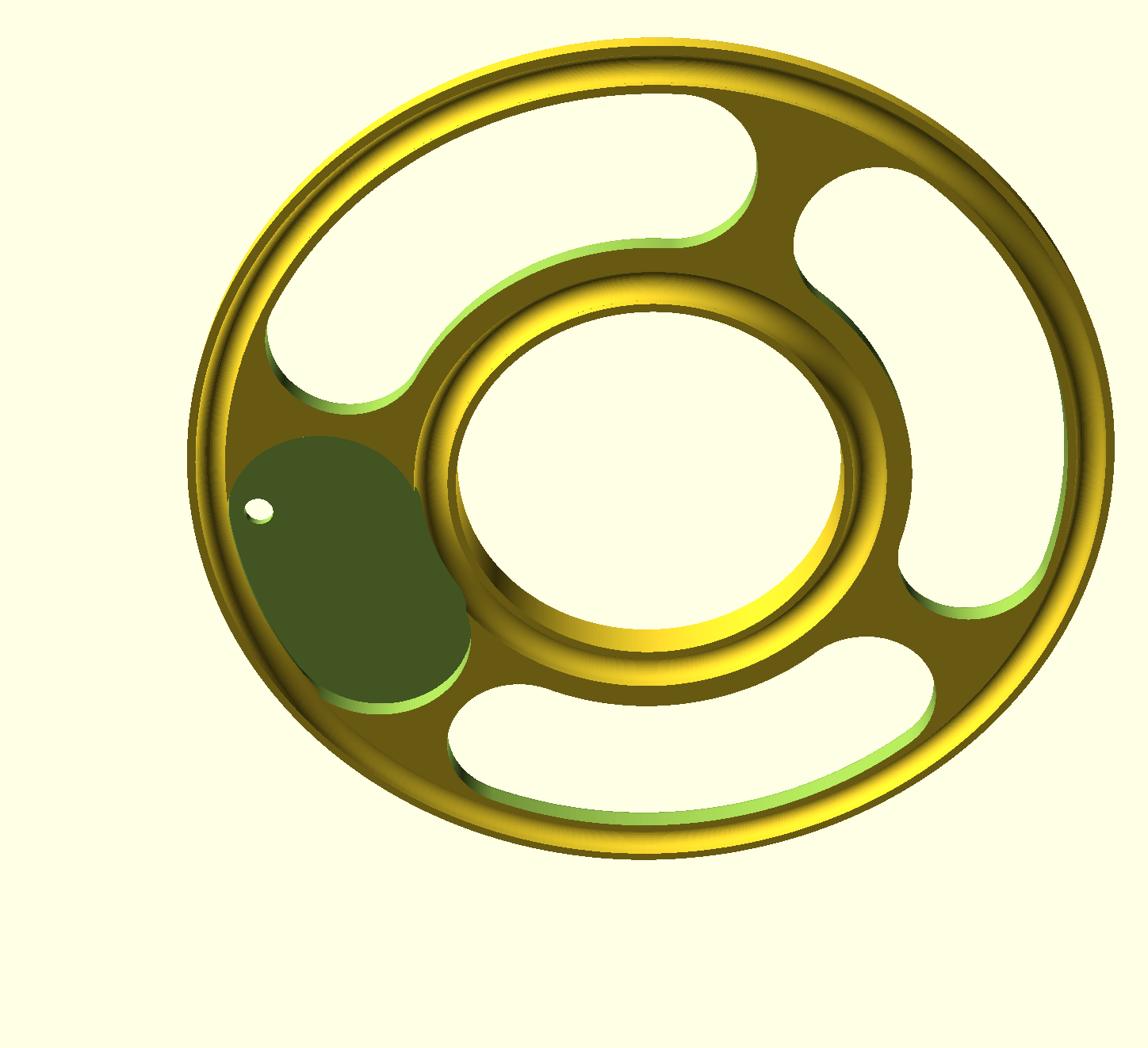

                          Busy printing an experimental 8.5" concentric shell at the moment.
                          Leaving a slot for the bucking coil above the RX coil so I can play with nulling/phasing etc. after I've potted the TX and RX coils.
