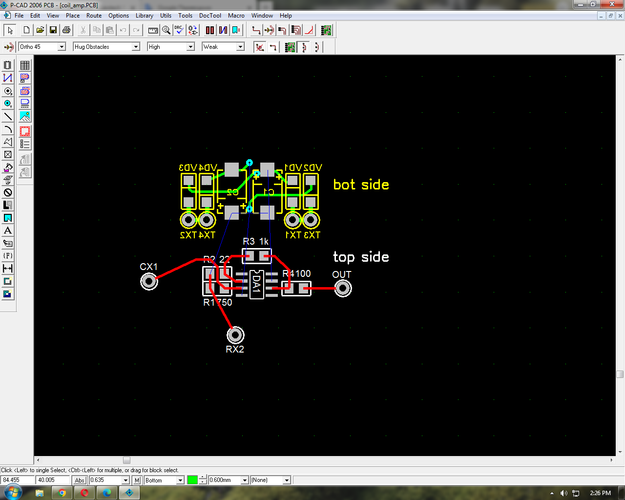

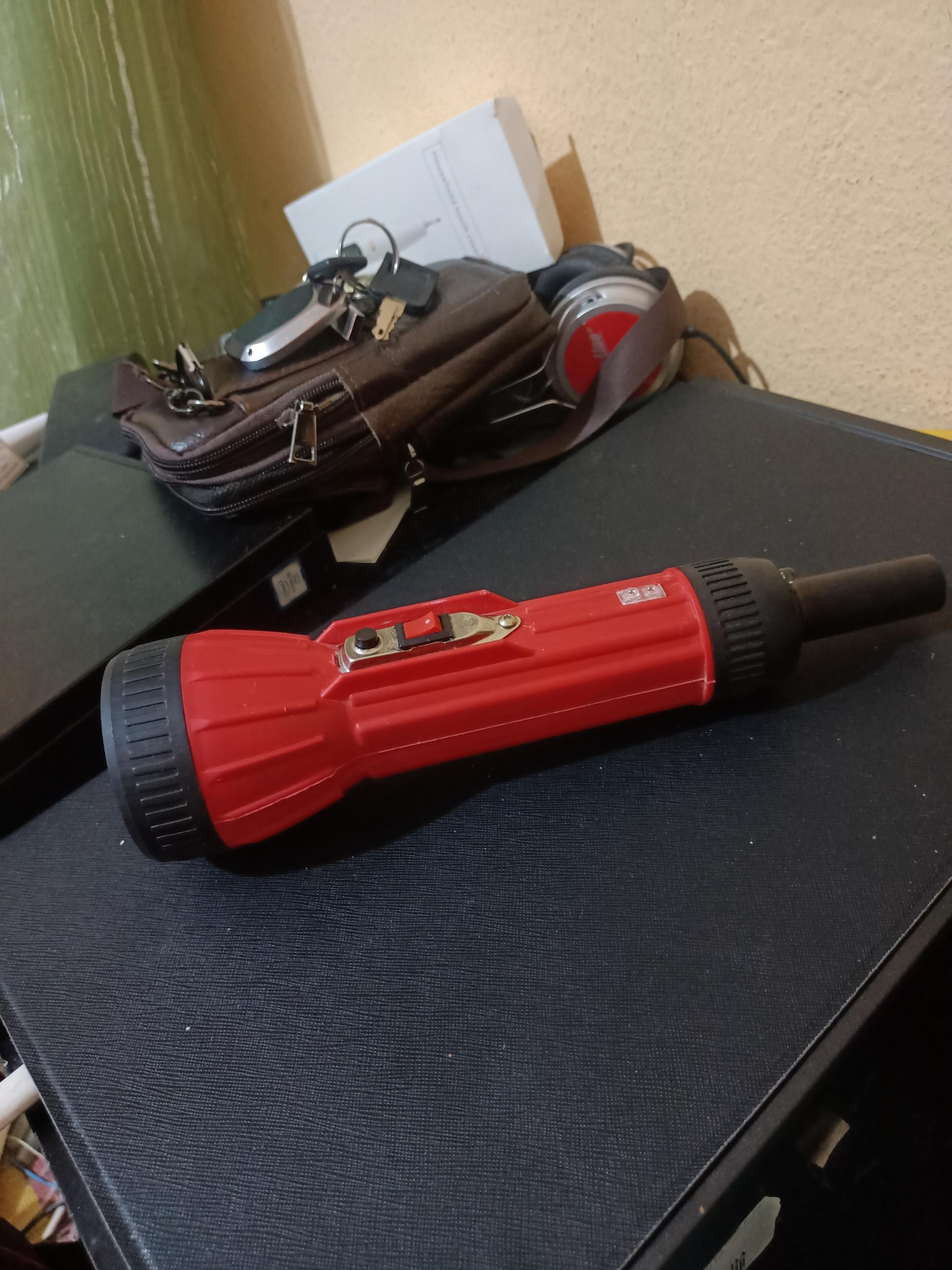

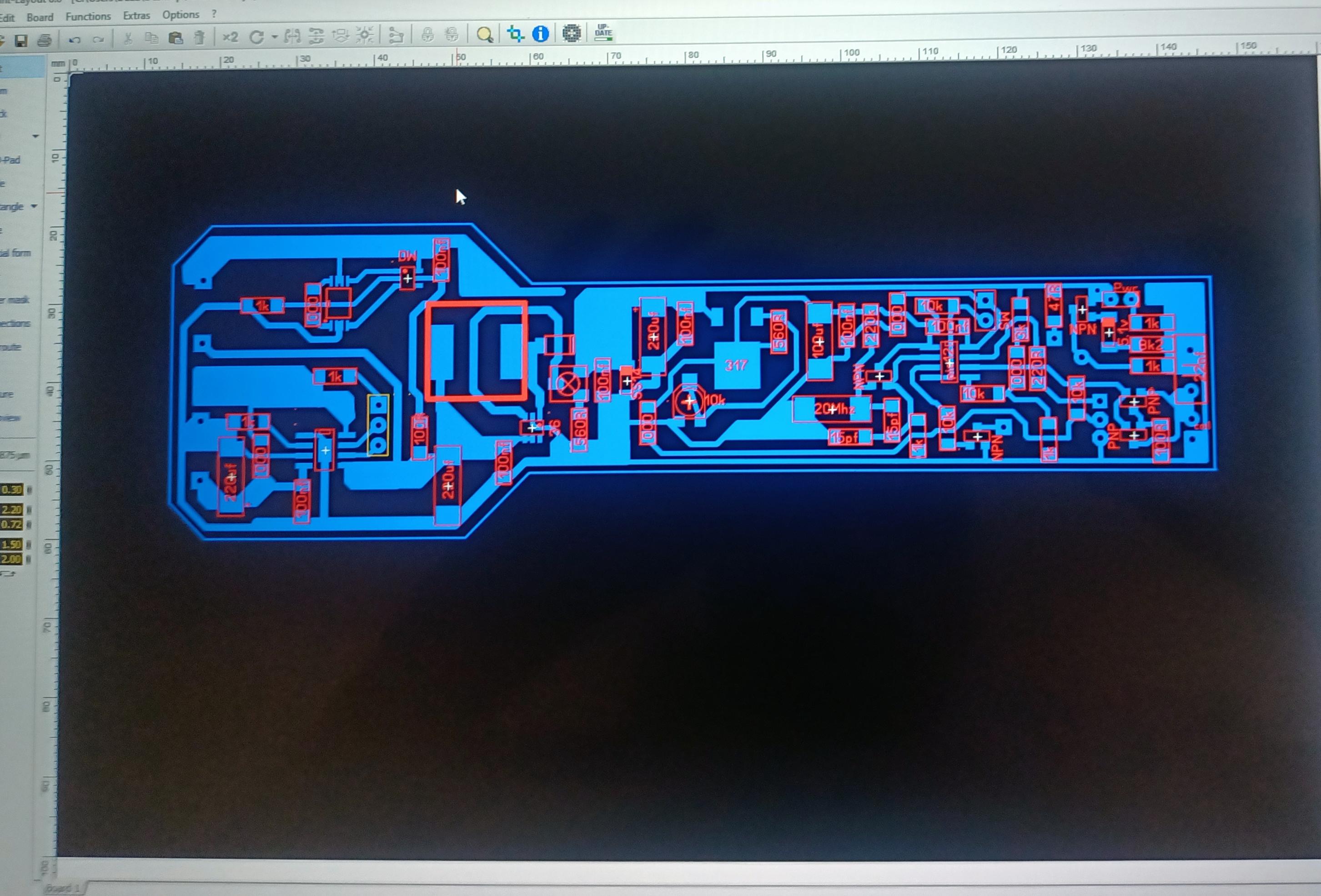

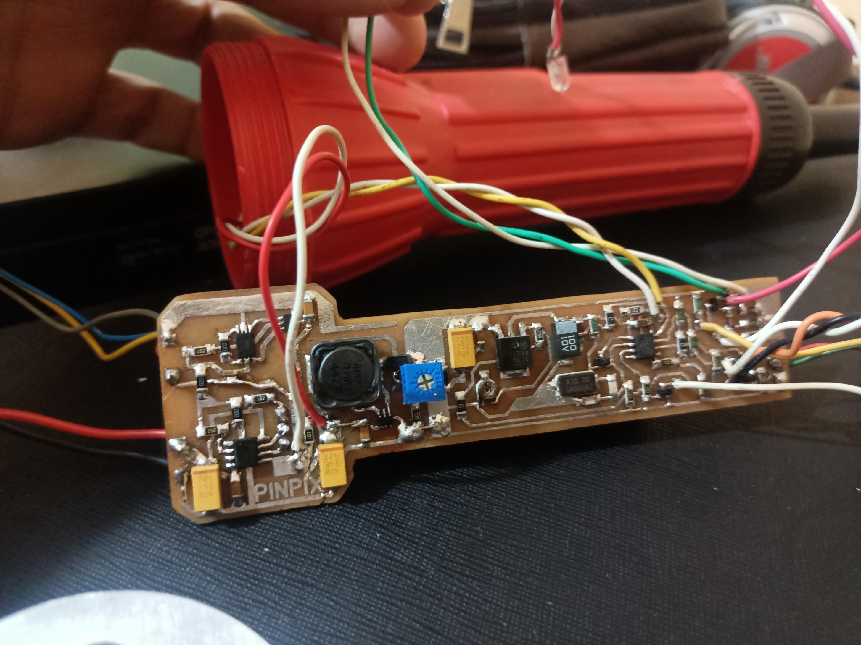

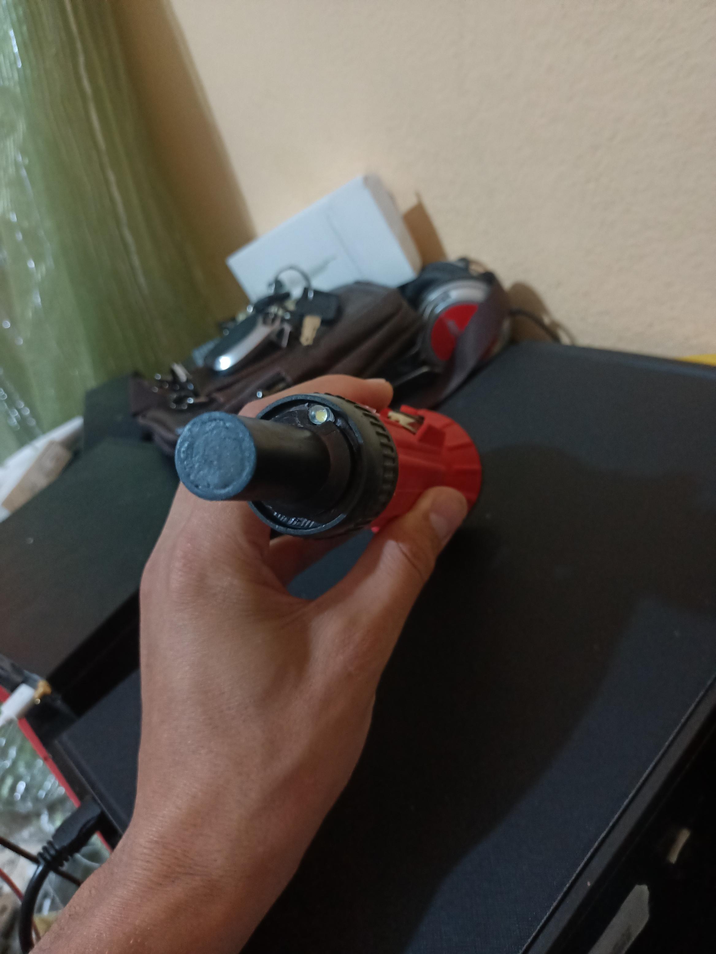

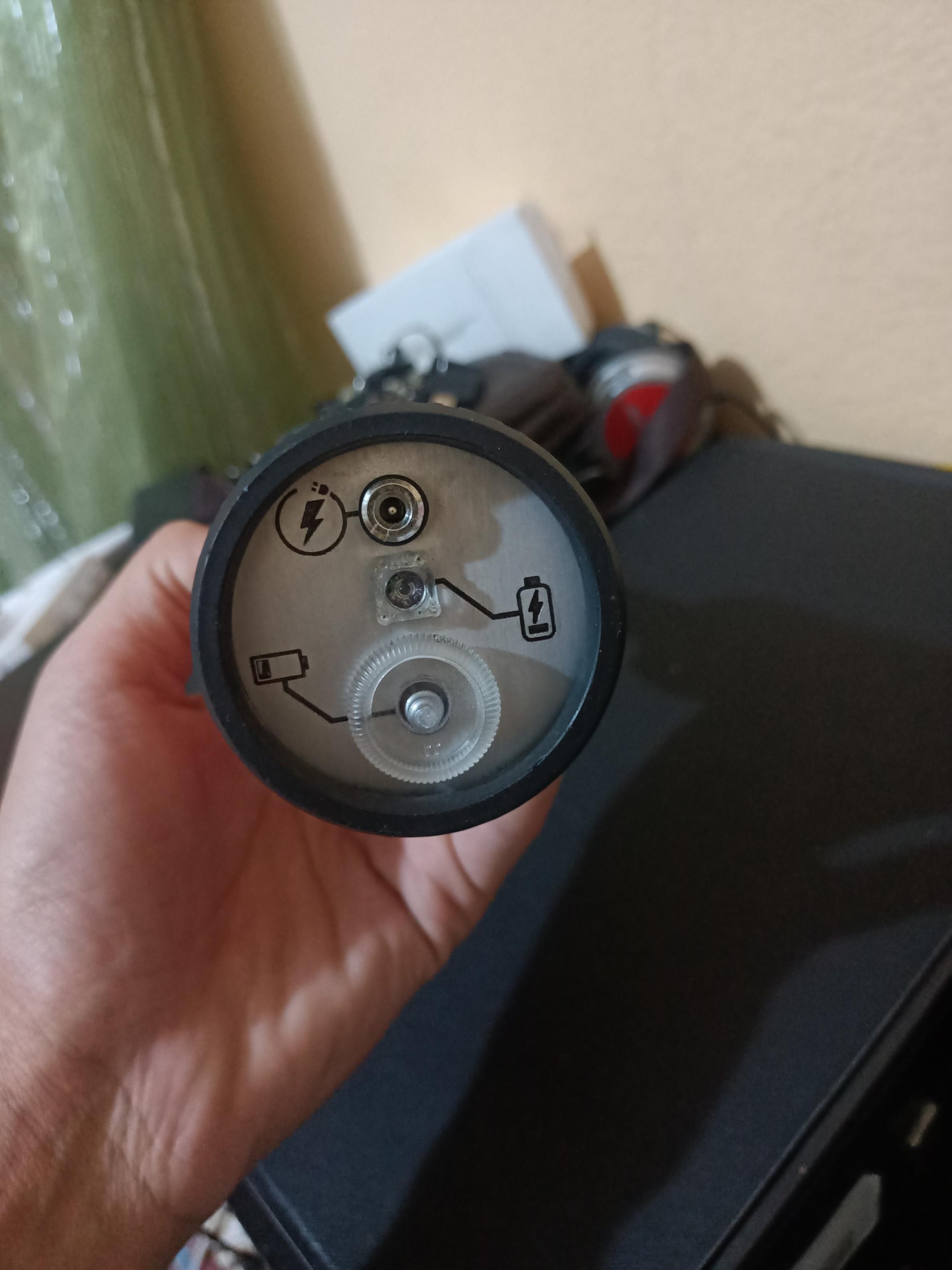

Hello , if someone wants to make an SMD FM2 pinpointer with a charging block and low battery indicator, and a ligth that can be used at night, here is the mods
SMD fm2 pinpointer
