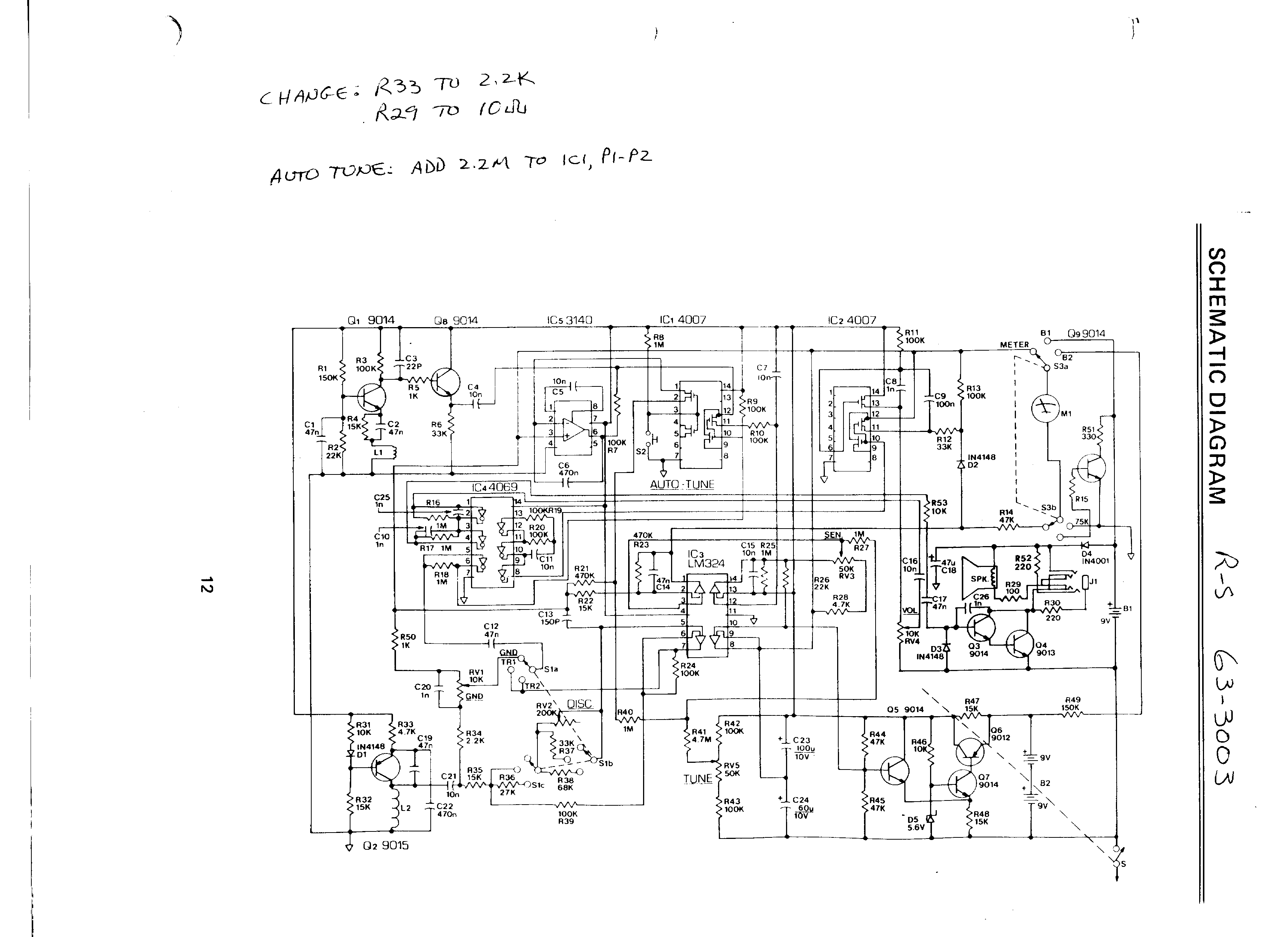

    If you have one please let me know. I need to repair one for an elderly gentleman.
    schematic 4003
    Is this helpfull ?? 4003 might be-63-3003 ? An oversized image too ! Eugene
      Many thanks for this . I got the job done AND the mods in under 1/2 an hour once I could "see" where the problem was using the 'scope.
        Good schematic, where does the search coil go, where is it connected.
        Thanks.
          [quote=ron7777;52560] Good schematic, where does the search coil go, where is it connected.
          Thanks.[/quote
          Q1..emitter......Rx
          Q2..collector.....Tx
            Thanks, Its been awhile since I read schematics, I saw that after I posted. This seems to be the souped up schematic driving the coils harder by changing R33 and R29. The only thing I don't understand now is how the switch shown at the bottom ( S ) is connected to turn the unit on and off, since it looks like the batteries are always connected in the on position.
