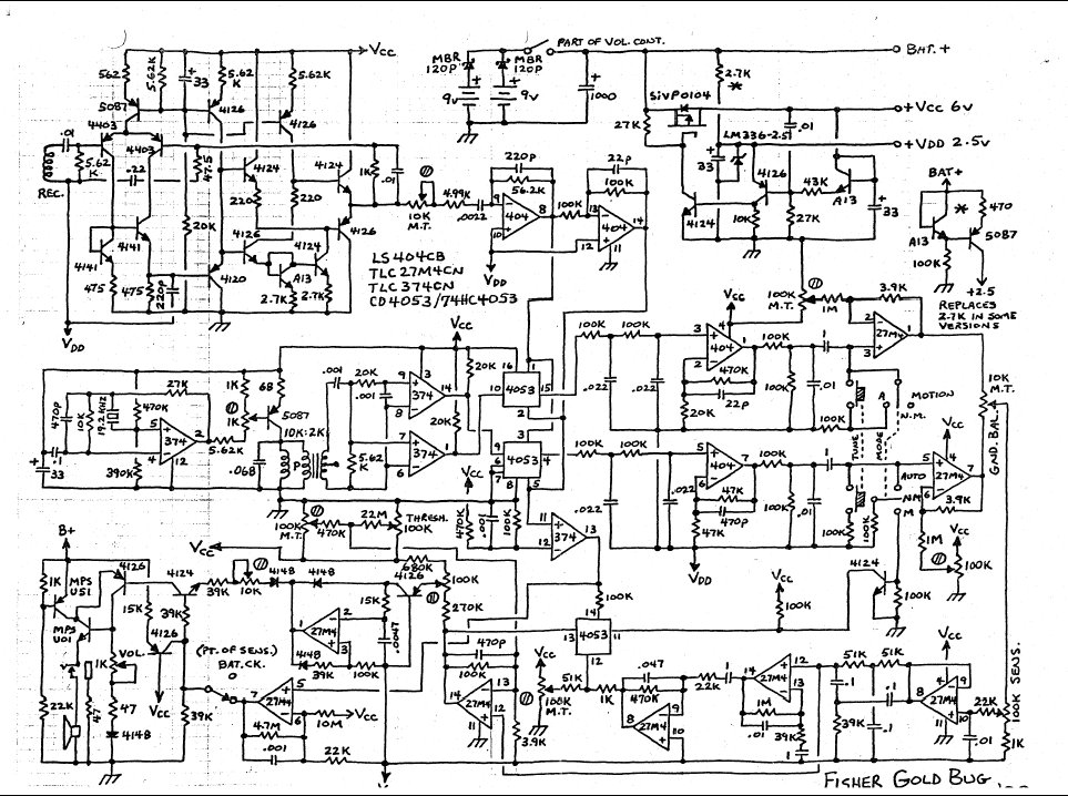

    Well it has been over one year and It looks like a Gold Bug I schematic never surfaced here on Geotech . Does anyone remember a hand drawn schematic of the Gold Bug I ?? Maybe a "PDF File" from W. Lahr ?? I was reading some other Gold forum last night and as we all know , the Gold Bug II is very impressive . The Gold Bug I "Original Design" has been discontinued a few years and is "no longer in production" !!!! I have not even seen a used Gold Bug I for sale in a while !!

        This is the only Gold Bug schematic that I have, and I've no idea whether it's version 1 or 2.
        Is this what you're looking for?
          Original Gold Bug I
          Thank-You Qiaozhi , I am pretty sure It is the gold bug I schematic . The IC chips labeled 404 , are they discontinued ?? And of course it has the world famous Fisher Transformer . I also see this has a 1 k adjust on the 10k side of the transformer must be variable frequency adjust for parallel TX coil ?? and a 19.2 khz crystal !! So maybe it is not 71 khz like the gold bug II !!! I wish someone would post a bunch of good clear photos of the PCB "circuit board" soon ... Thanks again Qiaozhi........Eugene

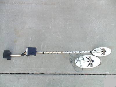

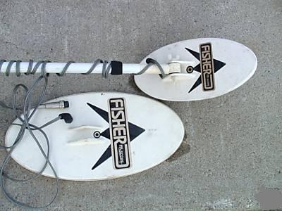

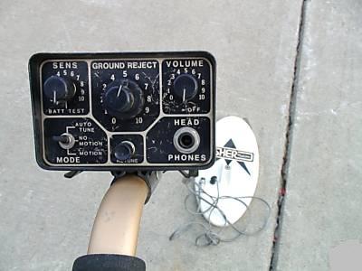

            Here are the only photos I can find , this Gold Bug I in used condition can still fetch $250.00 dollars the stock coil is a 5x10 inch and optional coils were 7x14 inch and 3x6 inch . I see a ground reject adjustment but no external discrimination adjust !!!!! $250.00 dollars , and how old ???.Unbelievable High Resale Value.............Regards.......Eugene/Generic Member/ Stalni-Clan
              It's the goldbug I,i presume, ir's the same schematic that i have.
              If i well remember version I havent discrimination control on panel, maybe disc is preset.
              Bye Max

                  Eugene52, LS404 is from STMicroelectronics. They are available from Mouser. IMO they are very similar to MC33179.
                  The 1k pot is used for drive level adjustment and should have no effect on frequency. I am guessing that drive level should be set as high as possible while maintianing a 50/50 waves from the phase reference comparators. This would best be set with O'scope to monitor waveforms. Set drive level too high - and the square waves will be square no more. Remember, I'm just guessing.
                  Maxbiri, The Goldbug does not have discrimination by design. According to the operator's manual, ANY amount of discrimination could cause certain gold targets (especially small nuggets) to go undetected. You may have to dig more trash, but the possible pay-off is deeper detection of more valuable targets!
                  You can get (most?) Fisher manuals here: http://www.fisherlab.com/hobby/op_mans.htm
                  I have been trying to analyze the Goldbug circuit, but it has some strange twists that baffle me. There may be some other "errors" (or maybe it's my lack of understanding) but I can't quite digest the circuitry around the CD4053 pin 14. I get nervous trying to figure it out - maybe I should relax and try to believe. I would like to maybe clone GB(1) (except I'd modify the areas that don't want to run in LTspice and what I can't digest).
                  Qiaozhi, this schematic is definately not the Gold Bug 2. GB2 uses something like 71kHz, and has mineralization adjustments not present in the GB1.
                  I think the transmit coil should measure around 1mH, but could somebody please measure and post the coil inductance and resistance specs? A properly operating Gold Bug is no small potato!
